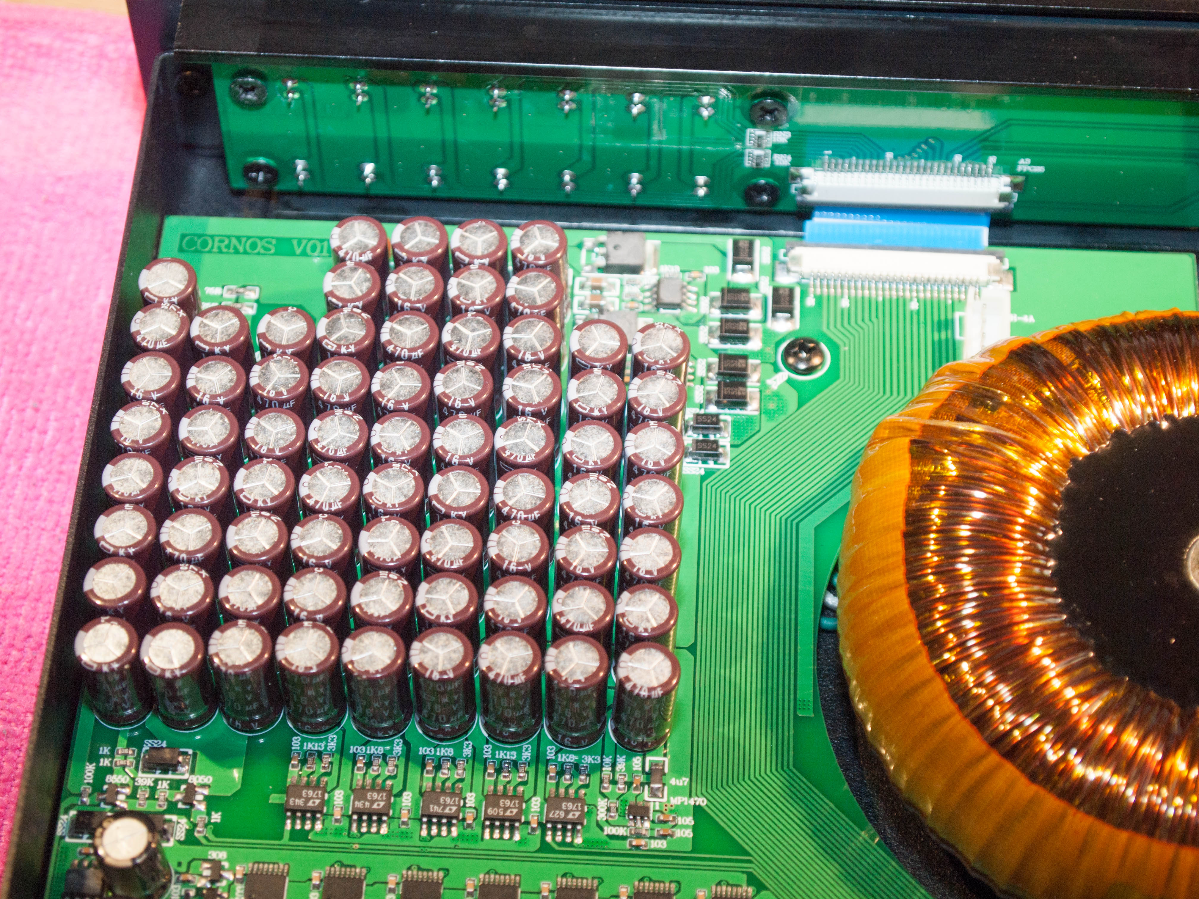

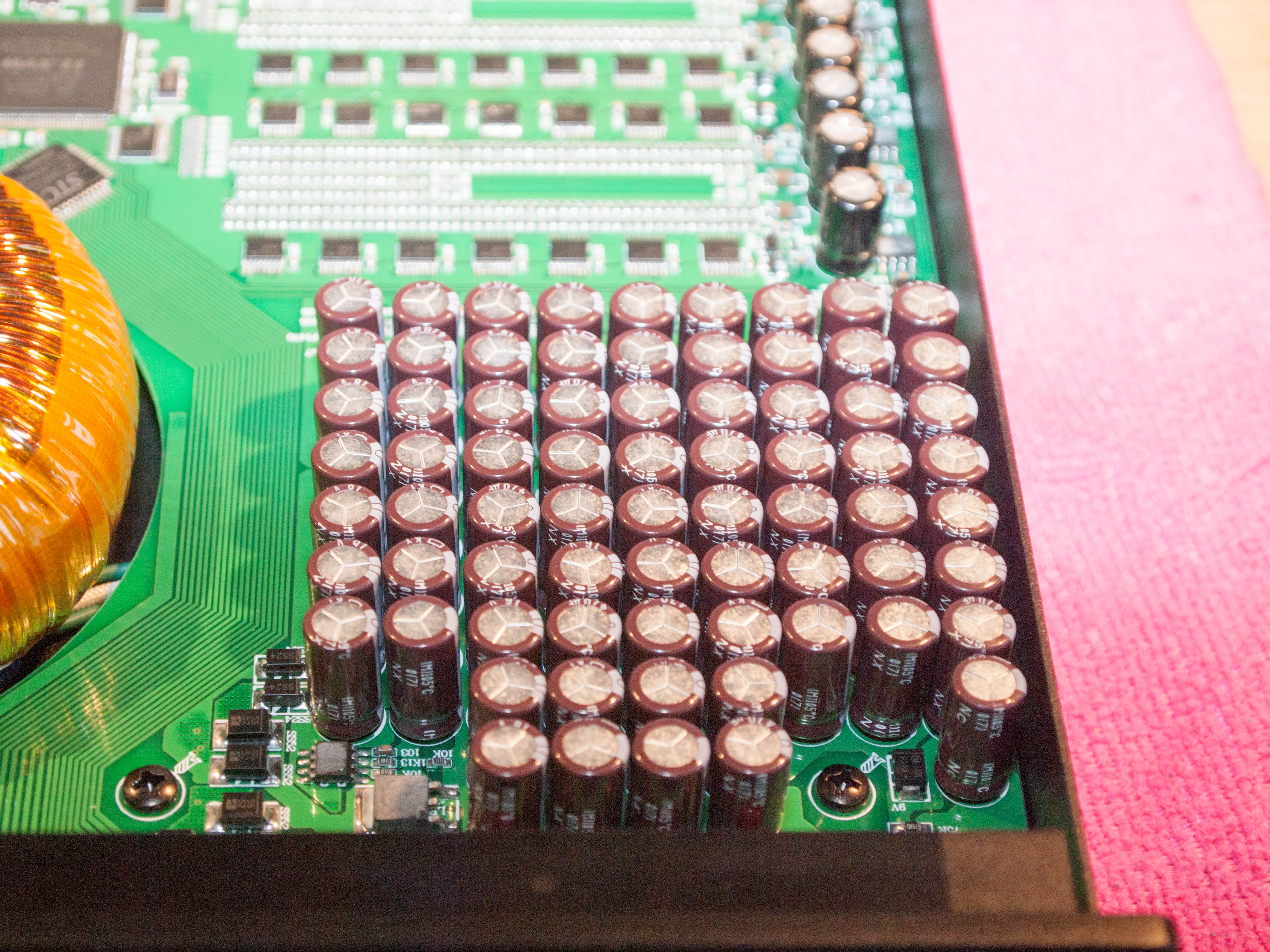

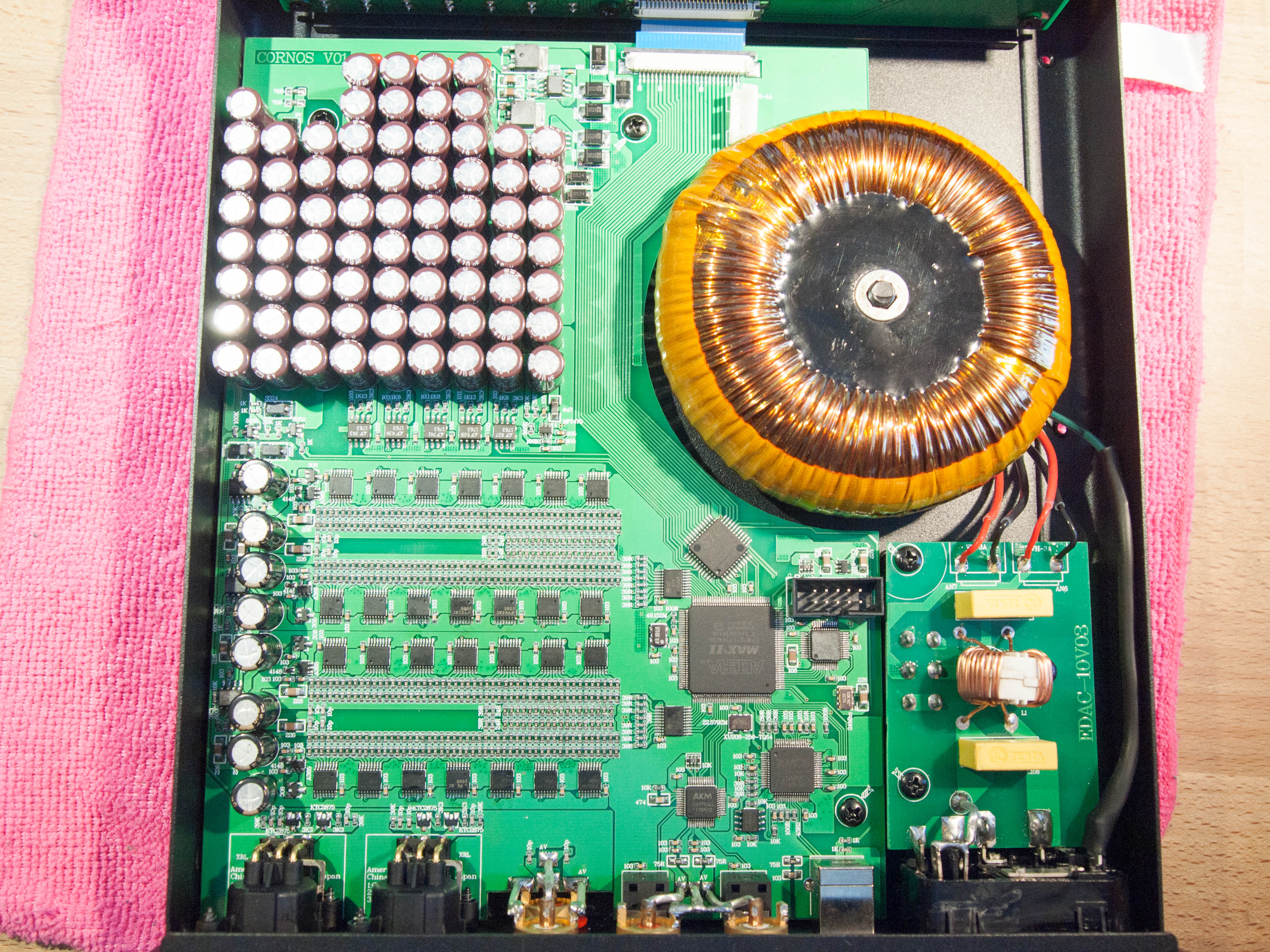

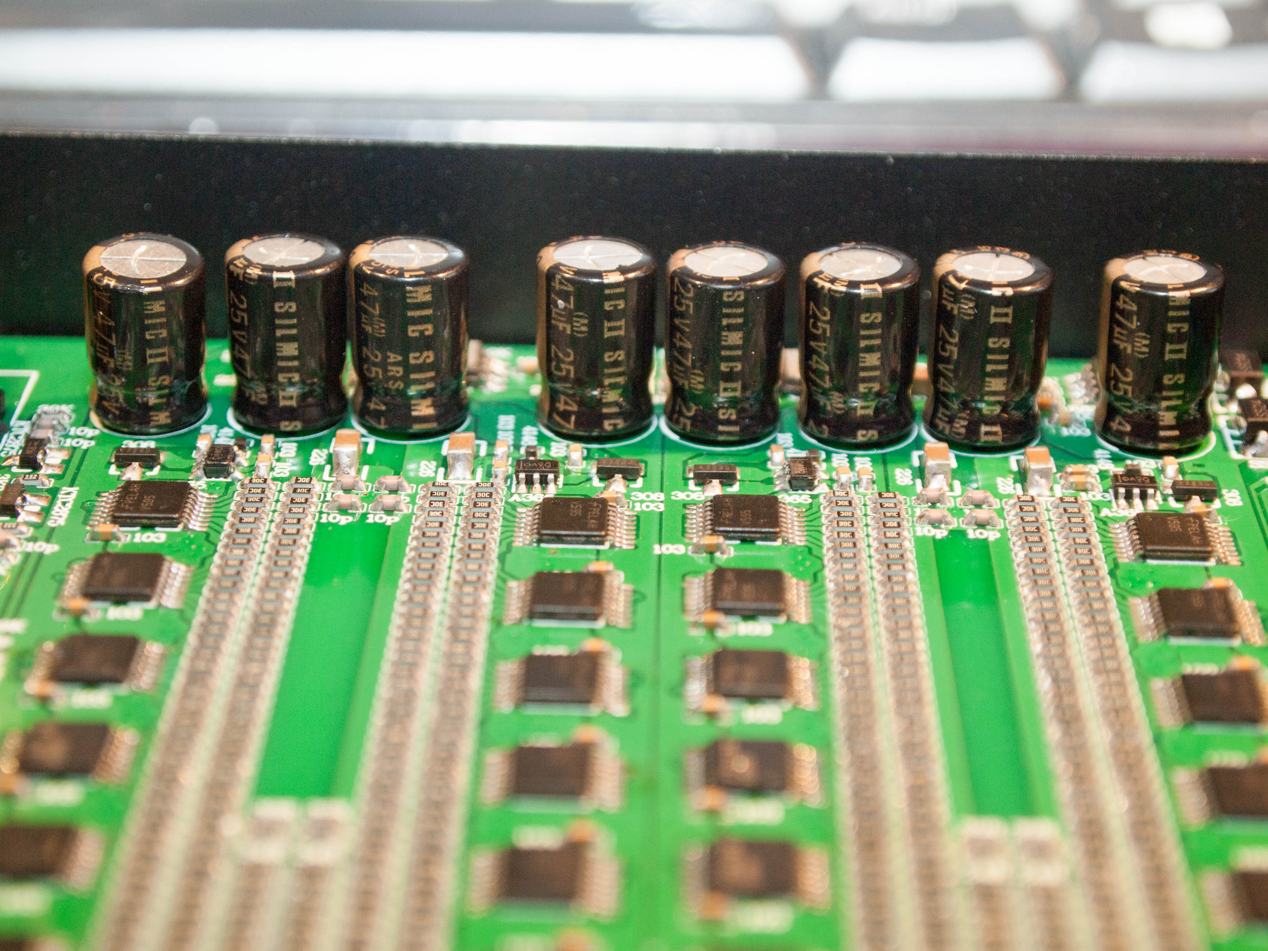

So the Denafrips arrived an hour or so ago and here are some pics.  First off, it can certainly hold its ground against the MSB Platinum DAC3 with the new Carbon CC and SR-007Mk1BL.  Way too early for an concrete findings but resolution in the Denafrips might be a bit better, the sound just a tad more forward and maybe a tad thinner...not sure to be honest but the DAC is still dead cold.

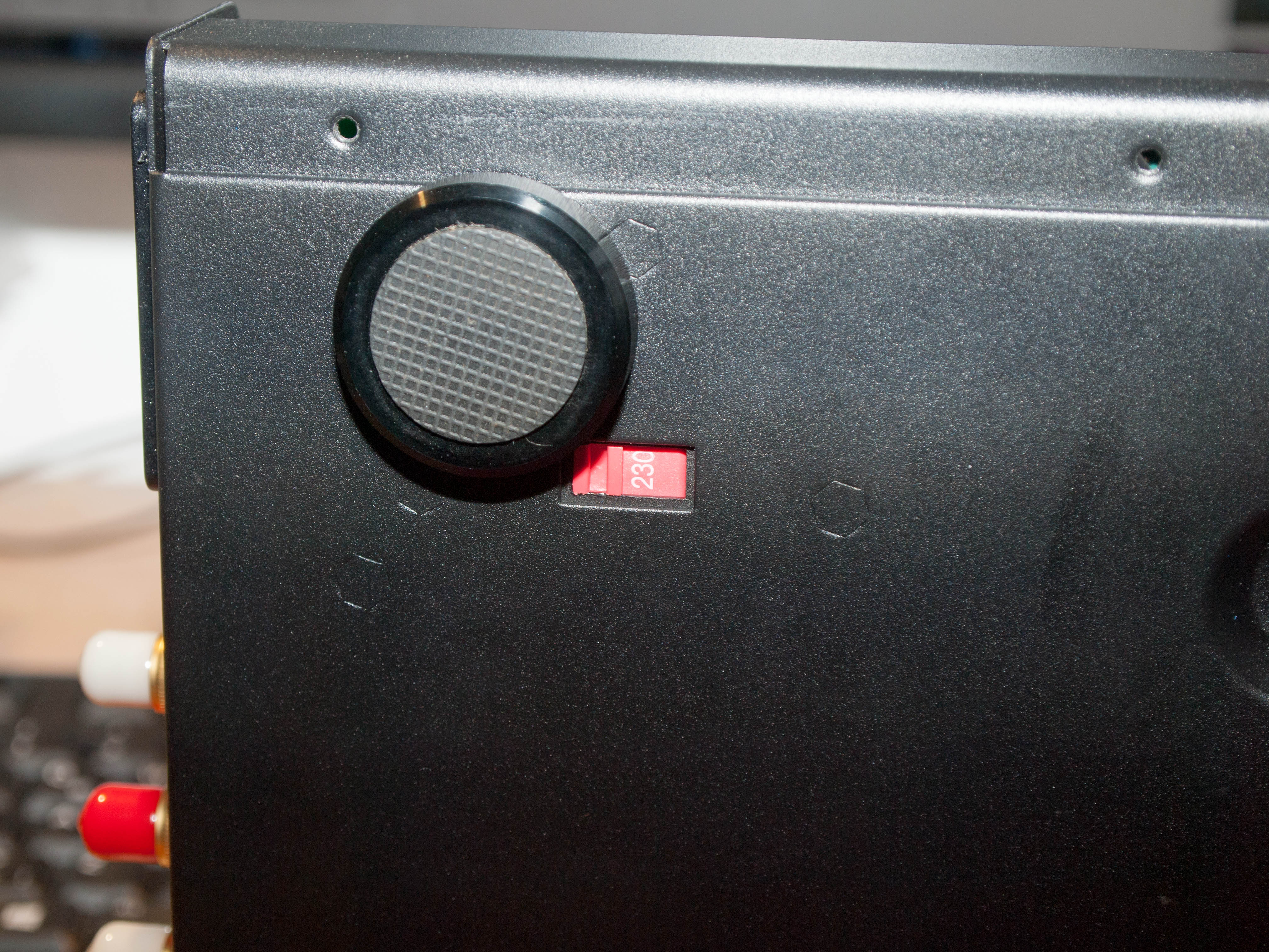

Over all the build quality is excellent, solid steel box with an aluminum front panel.  All quality pieces used through out and even the mains select switch is a nice C&K unit, not the horrible open cheapo shit that's in the Holo.

Those are 105°C quality caps so I would expect a lot of life out of them.

the pile of caps could still be a pain but not for a while

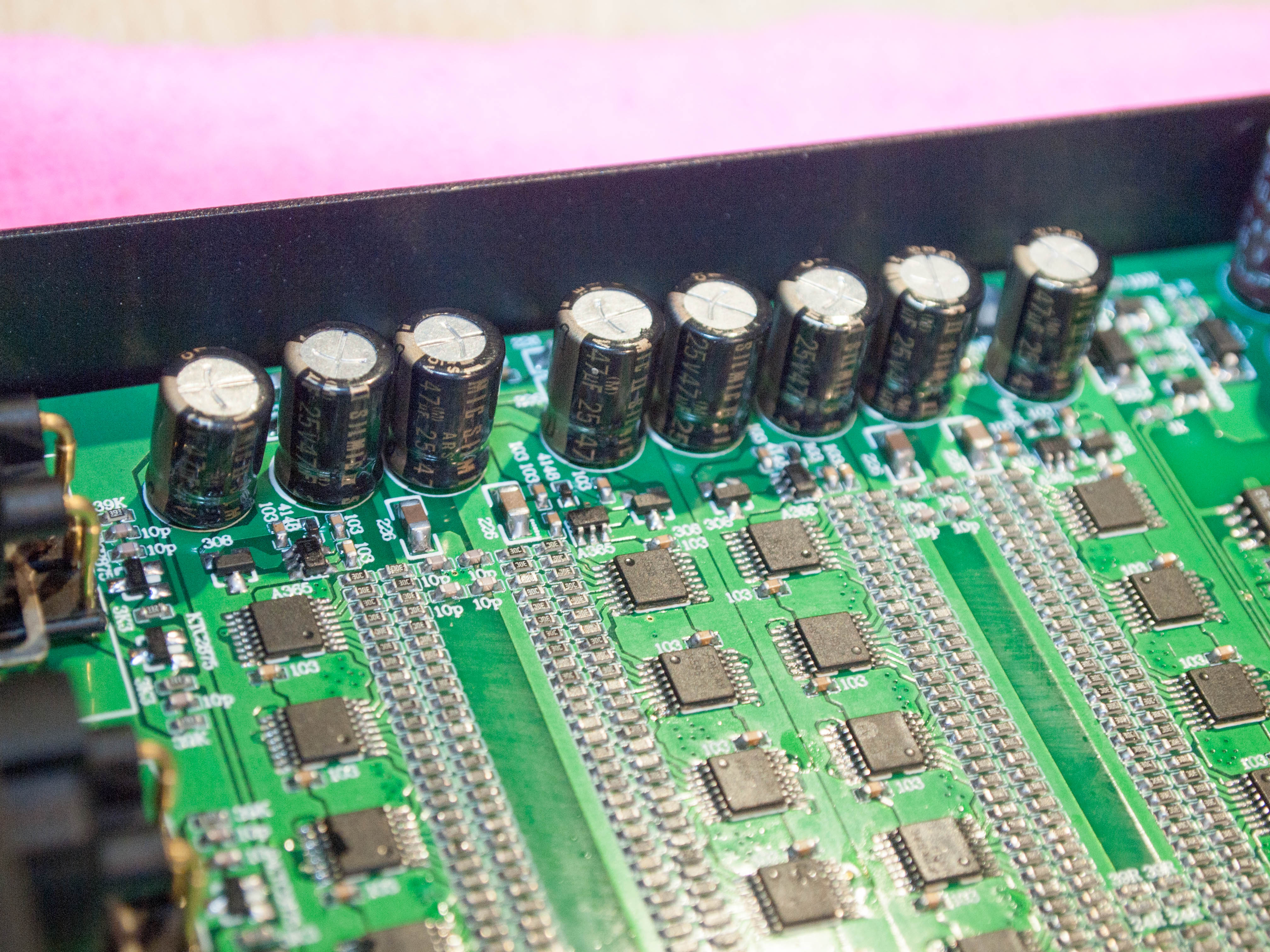

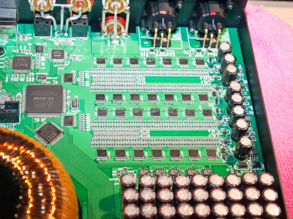

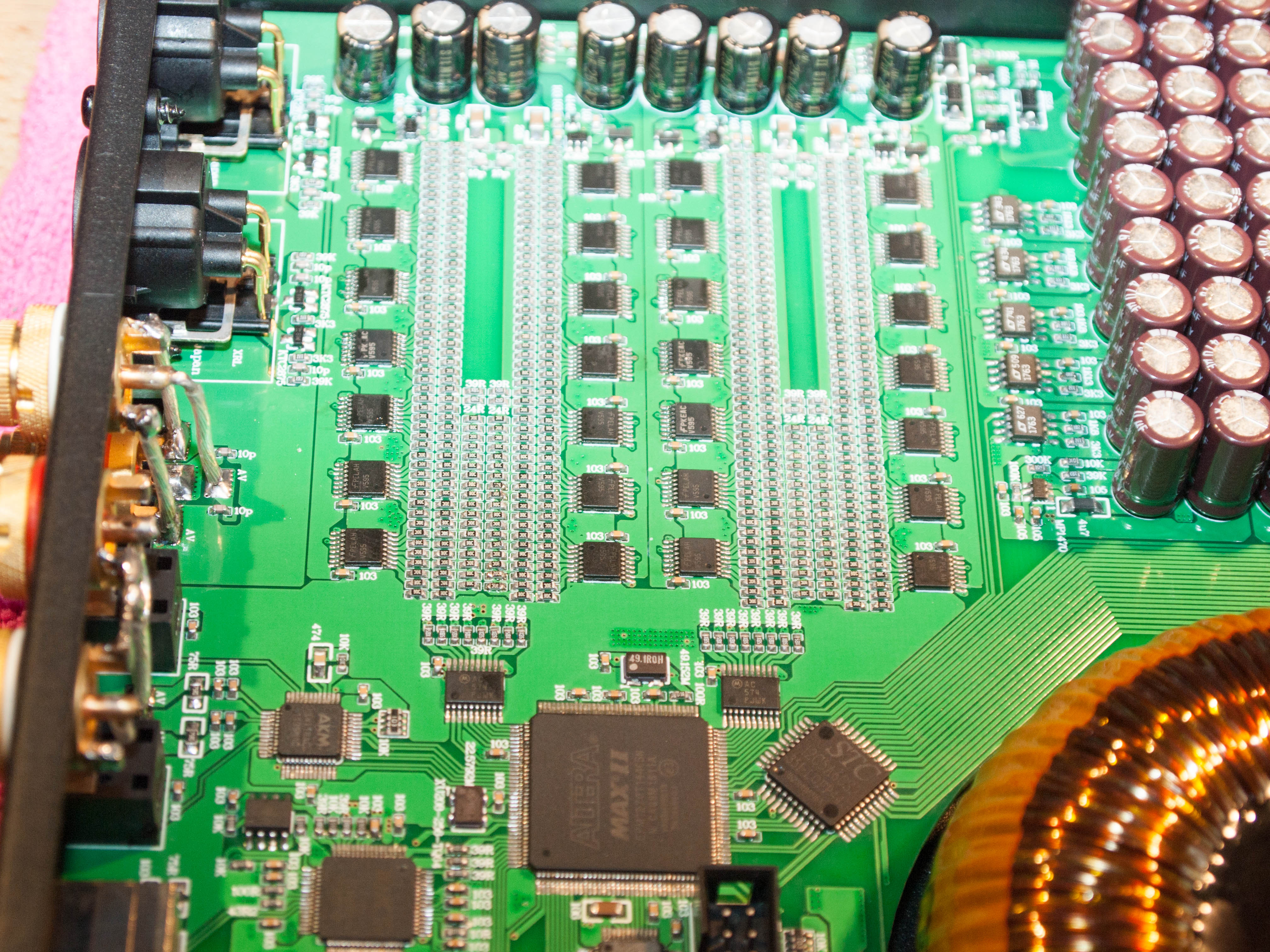

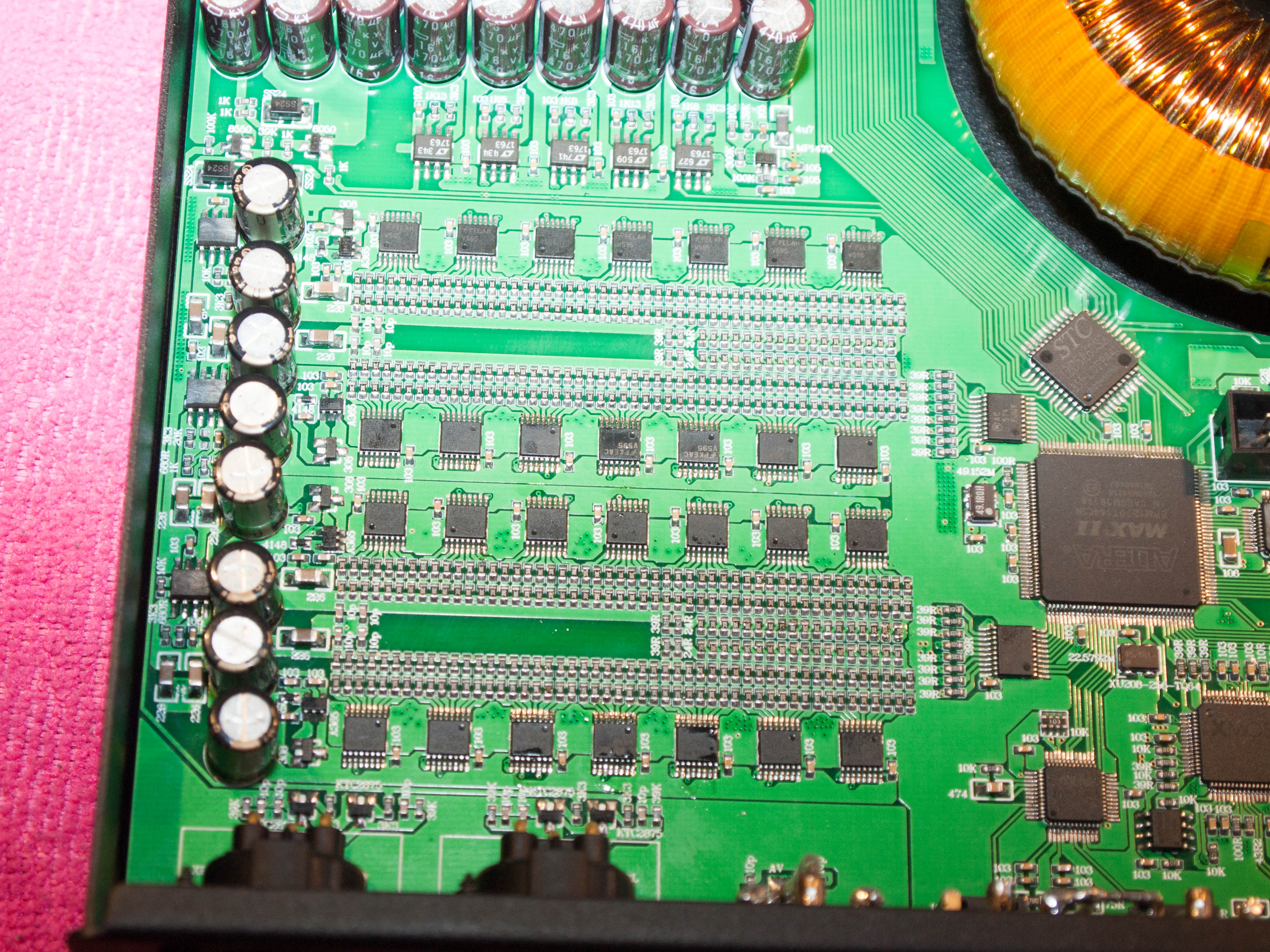

can't tell whether its sign/magnitude or not.  if it is sign/magnitude, then its not true balanced
I doubt it is fully balanced as the TOTL stuff has four discrete banks but I've yet to check under the board.
Spiffy Denafrips! Can you read what opamps are in the analog section on the left, or did they get the Ray Samuels treatment? Also, what regulators are they using in the PS?

There are a lot of sanded parts in there so the regulators and opamps are unknown at this point.

so if I count right, that is 50 resistors per string.  which would work out to 25 resistors (sign + 24 bit magnitude) x 2  and then 2 of them which would be balanced for one channel.
so it actually could be really balanced.  3 opamps at the outputs?
funny that they sanded off the part number of the eprom that loads the altera chip
Three opamps on the outputs and 50 resistors per string and 18 in the shorter ones.  Imagine doing this through hole...  ;D
