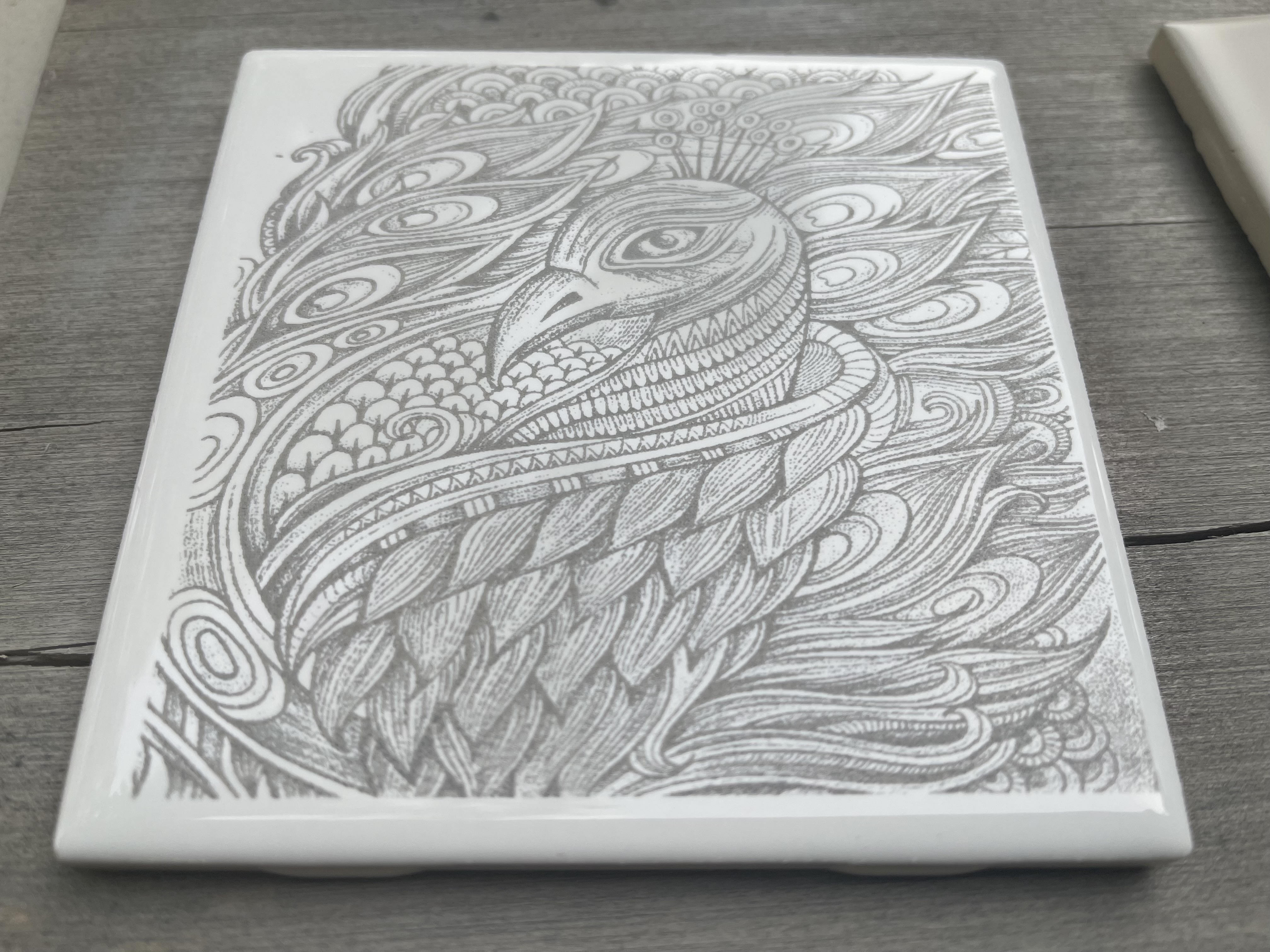

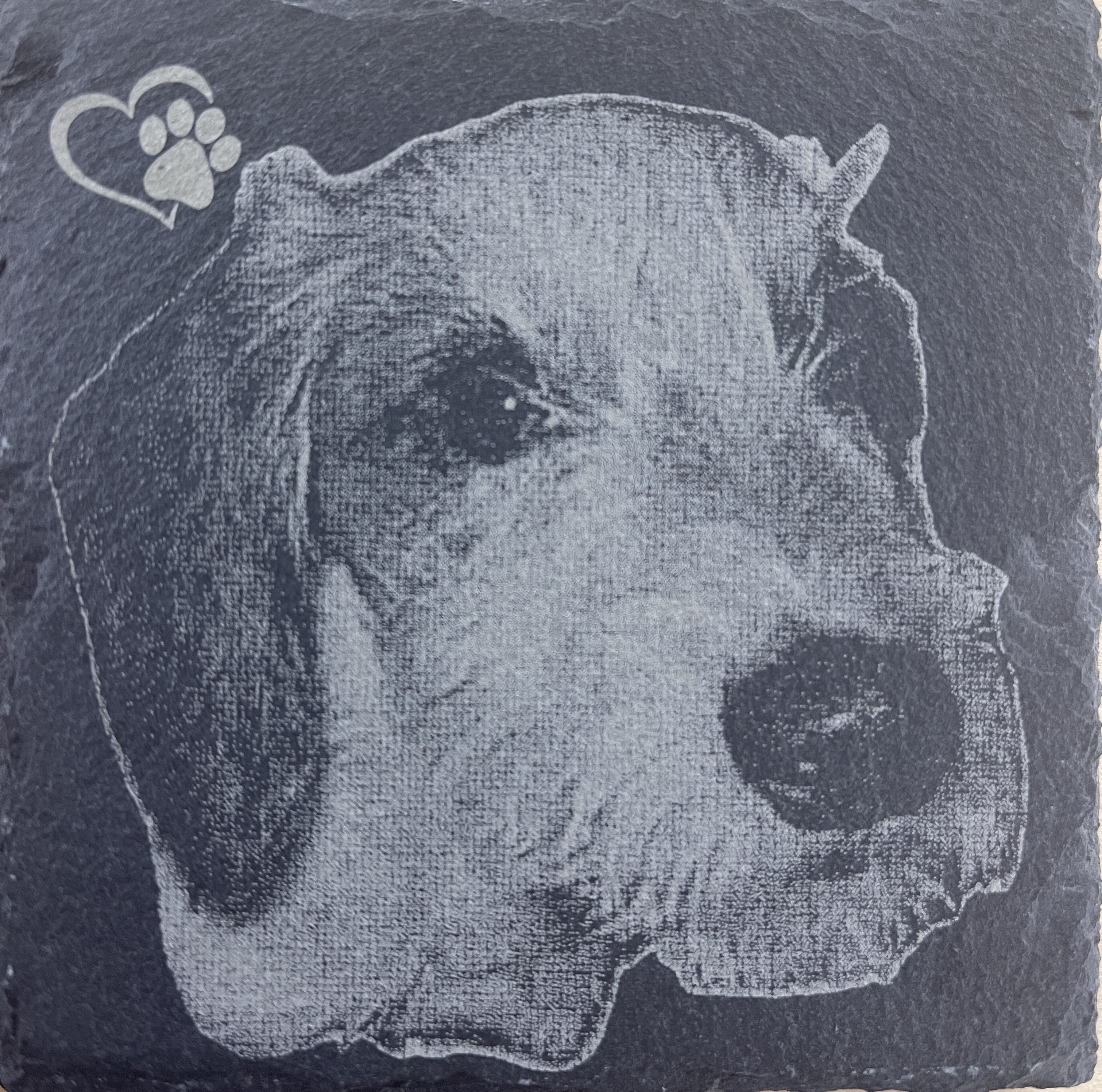

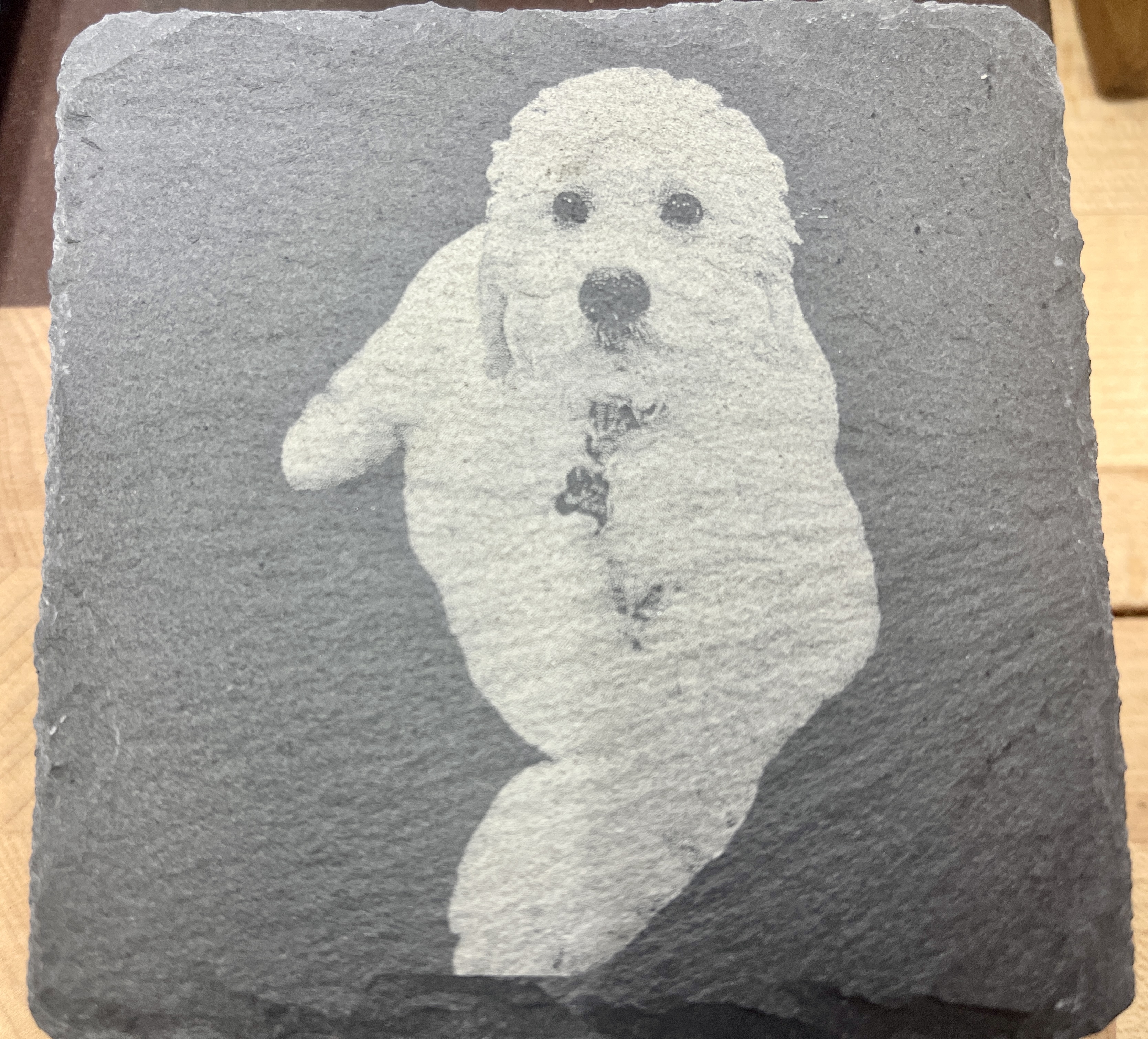

Moved to HD white tiles tonight. Much cheaper than slate and pretty damn nice when finished.
Need to build a jig to make sure I can center images.
Link to raw materials?
Also, jig = 1/8" plywood with a cutout of the shape with known coordinates of one corner.  Requires a little math, but generally works.

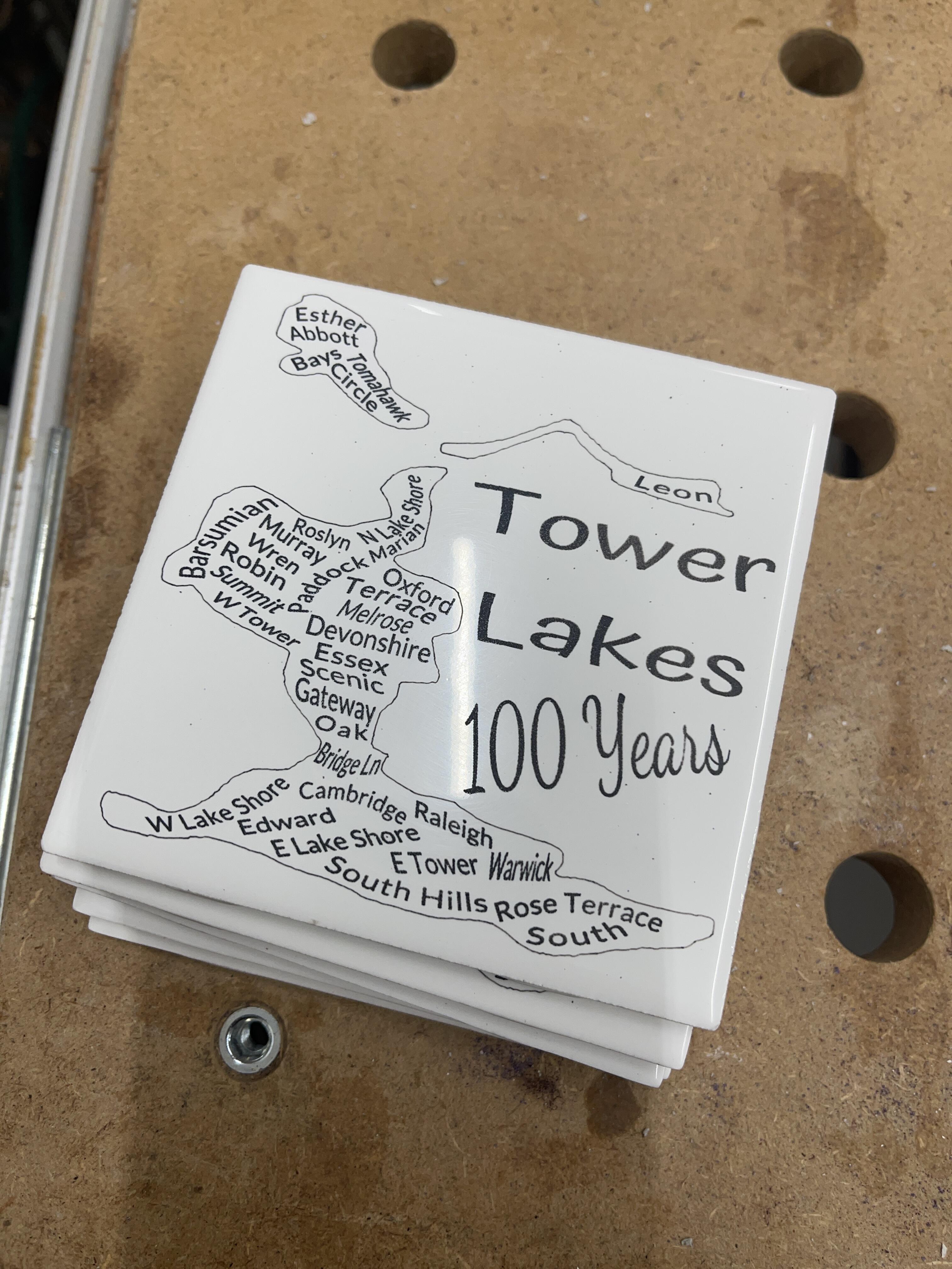

$.11 cent 4.25x4.25 wall tiles from HD, sprayed with white paint for the Titanium Dioxide and engrave and then clean off the paint in a bowl of thinner.
Sold 136 of these yesterday to neighbors at $32/set of four or $10 each. $15 in tiles, $6 in paint and then the design work.

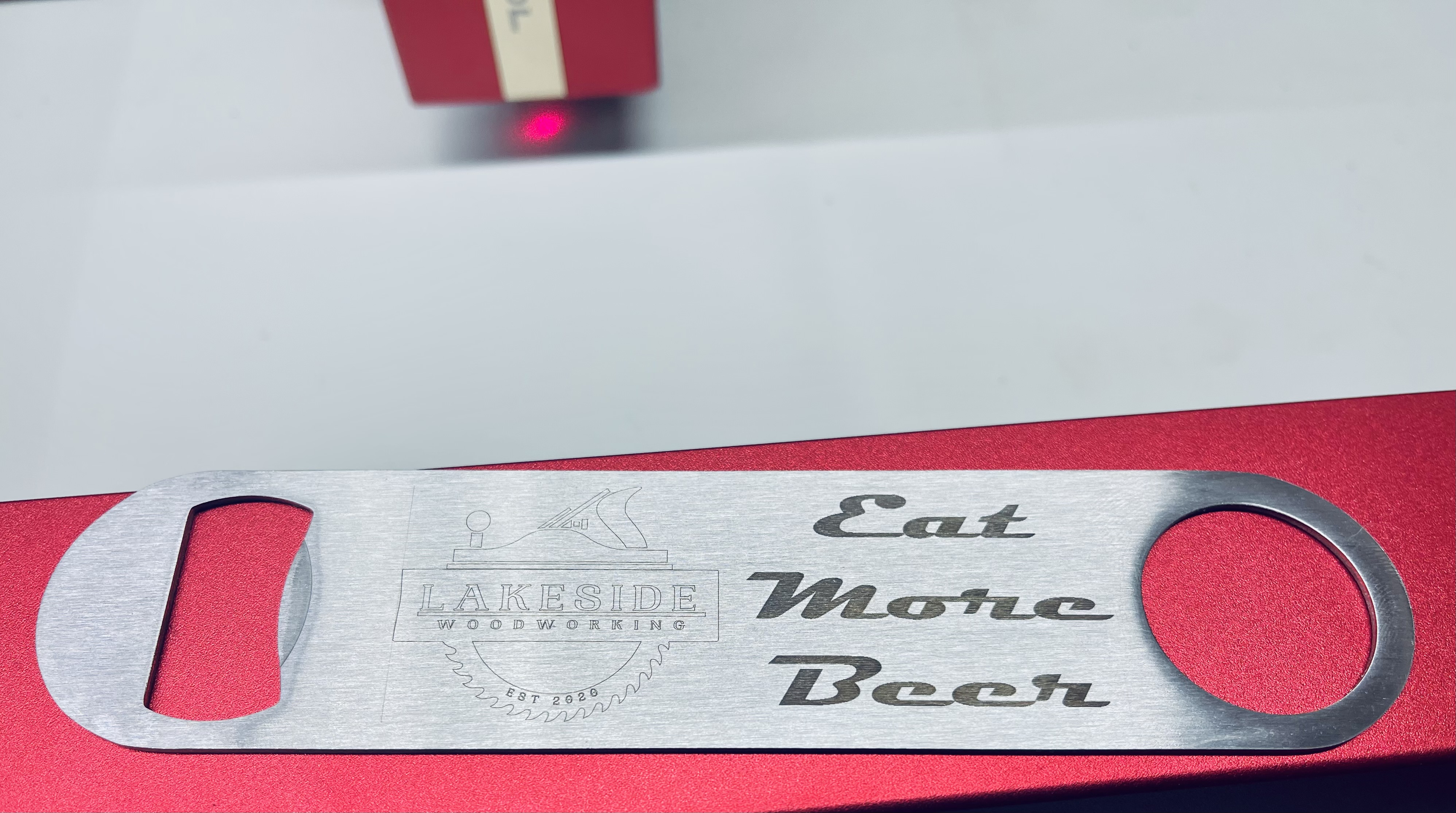

Some day I will actually get back to some woodworking, but tonight playing with Stainless Steel.

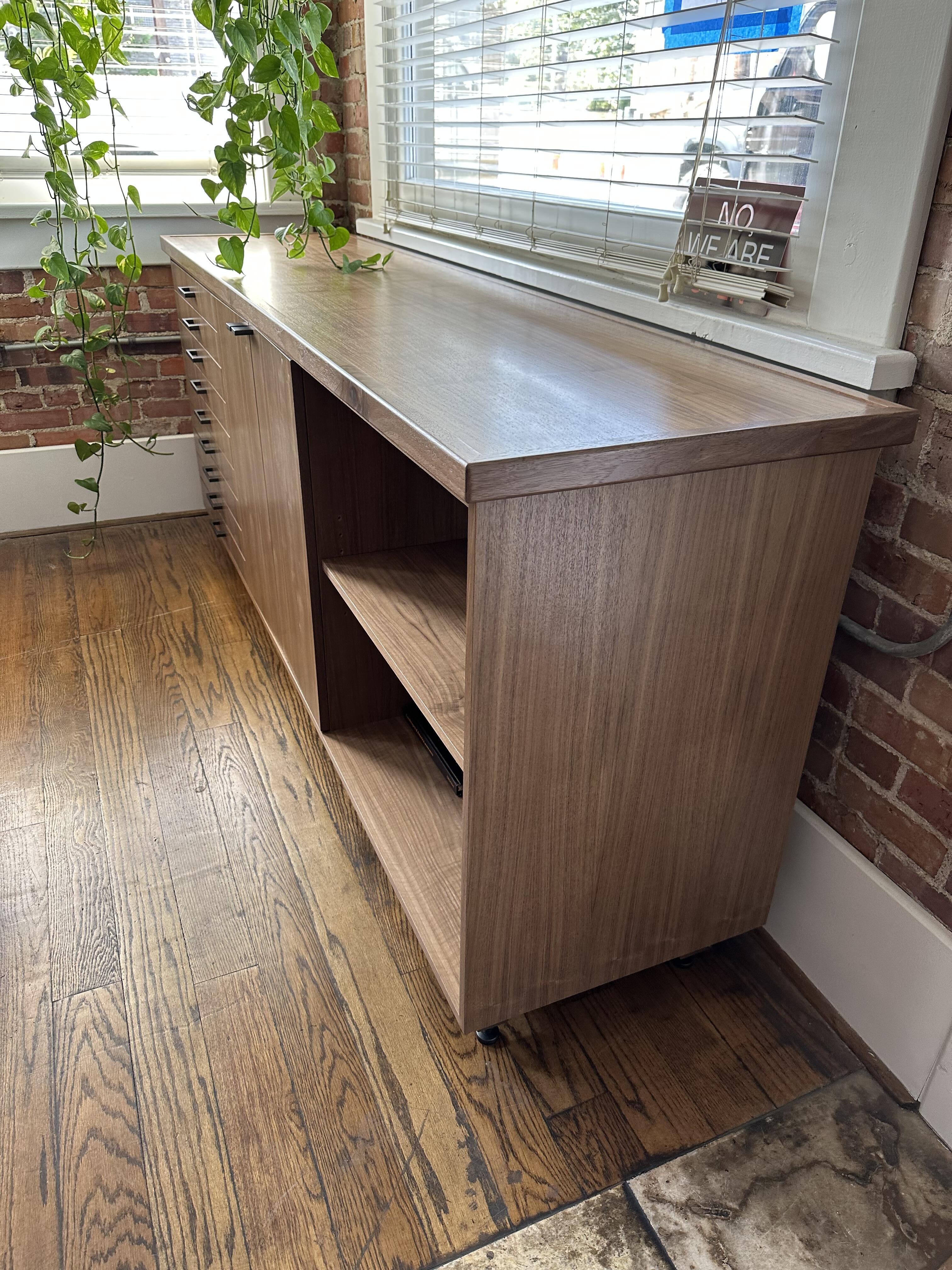

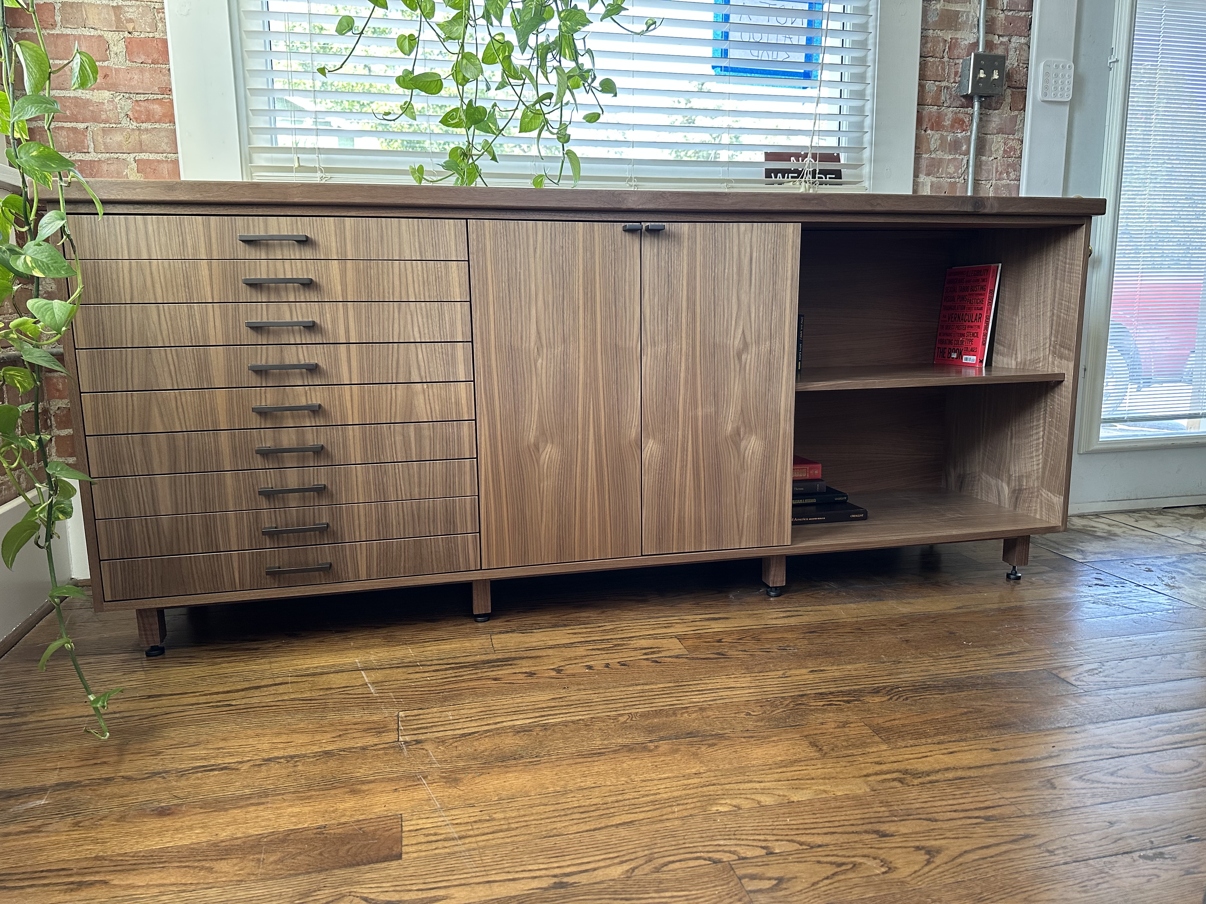

Slapped together a console for a friends business.
That's some real nice slapping! What goes in the thin drawers?
Customer paperwork/artwork.  They are a two man web/design/marketing company.
30 minutes ago, dsavitsk said:
@naamanf That's really lovely -----^
Thank you!
