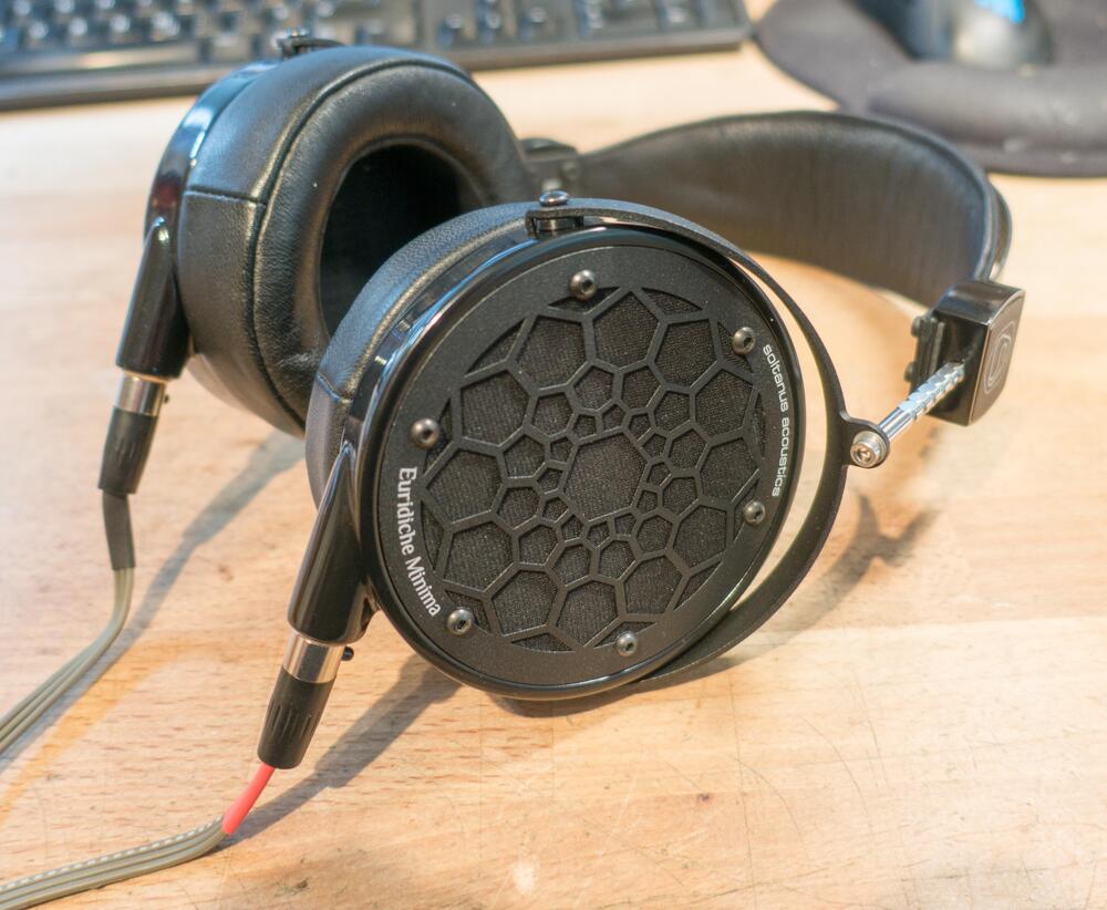

I've had my eye on these for the last year or so but waiting for a cheap set to come up.  There are three versions they sell and I found the cheapest one for sale, brand new in the box with the transformer adapter.  I'll take some pics of the system tomorrow (shortest day of the year here so... yeah not great for photos) but I've at least a pic of the headphones and the internals of the transformer box.

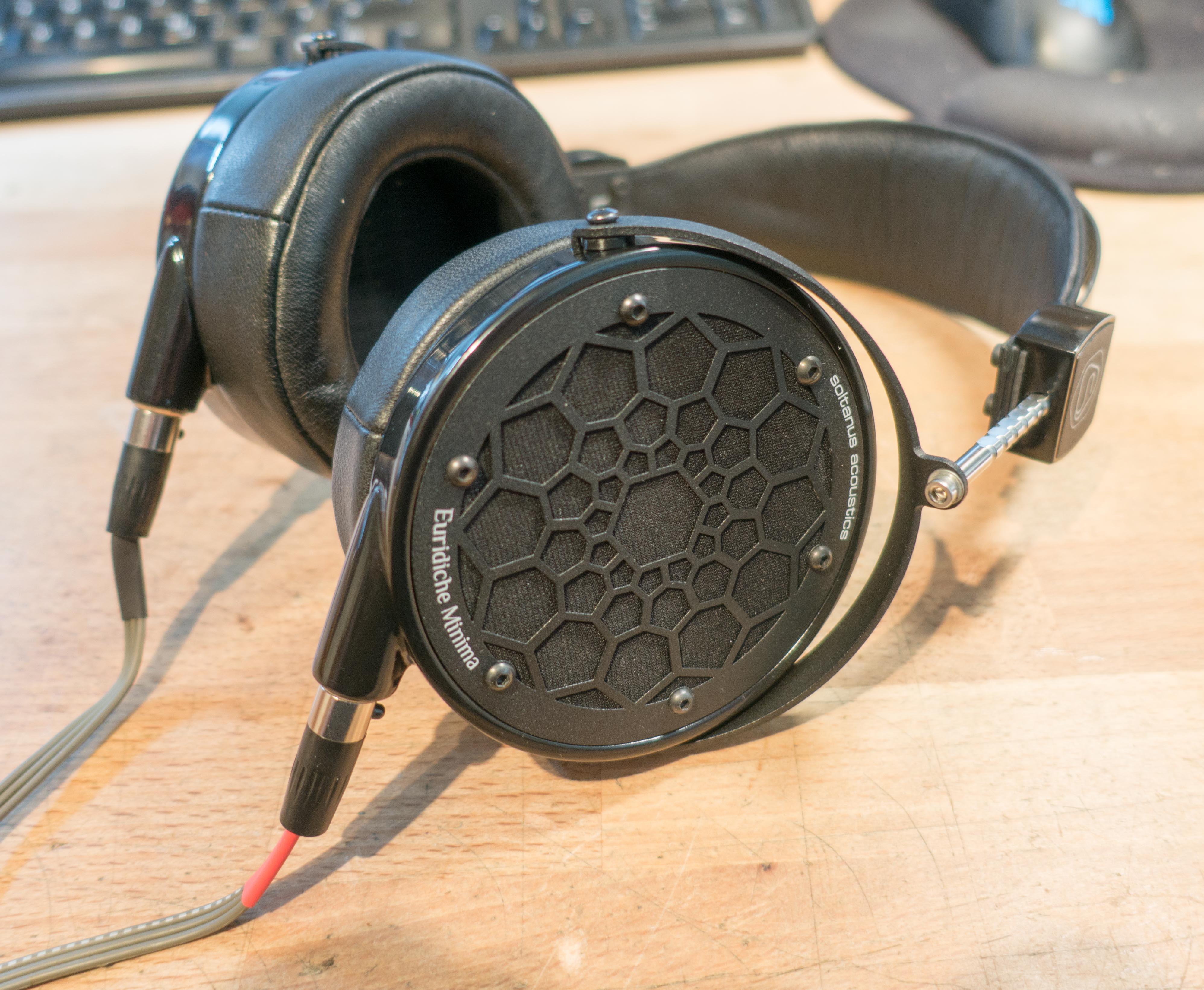

Here they are and I quite like the looks and the build quality.  They are using mini XLR's which is not ok but questionable connector choices are a theme here.  The stock cable is beyond crap (more on that tomorrow) so I'm using a Stax PC-OCC off my RR-1's.  They feel substantial but also light and fit my head snugly at the largest extension.

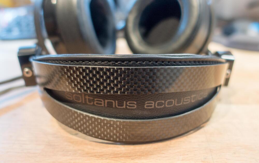

Carbon Fiber headband and the leather is nice.  On their site they claim the Minima is supposed to have pleather earpads but these are clearly genuine leather.

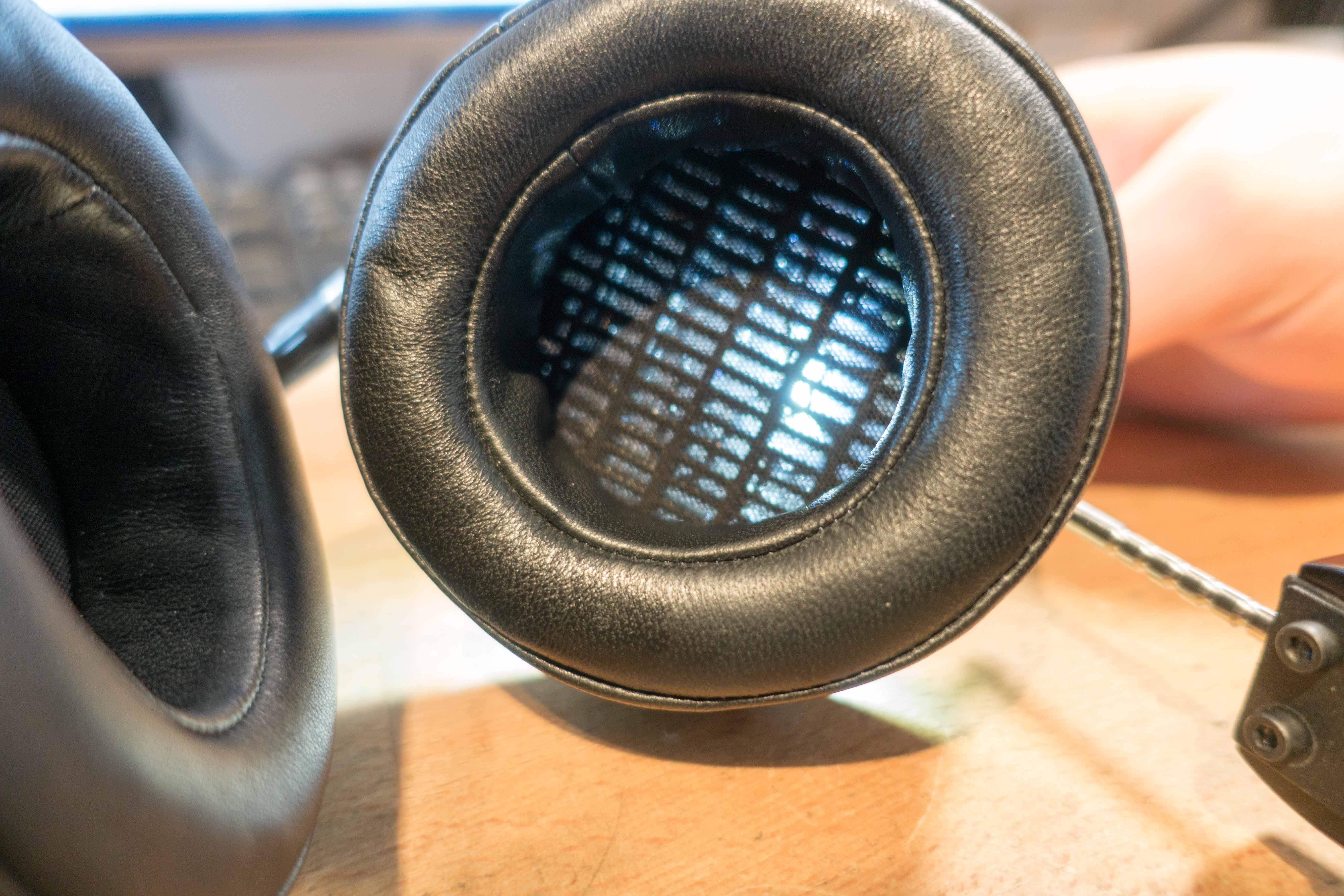

These look very similar to earpads I've bought from China in the past and nothing wrong with the quality.  I shone flashlight through the driver to you all could see the structure, very unusual drivers here.  Now onto the adapter box... yeah this is not good.

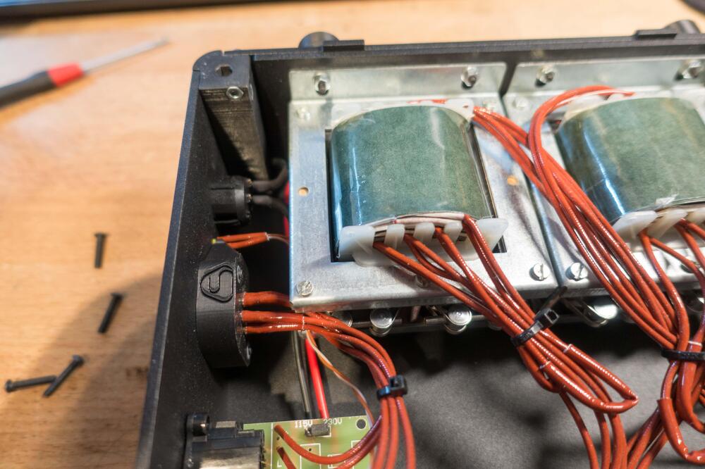

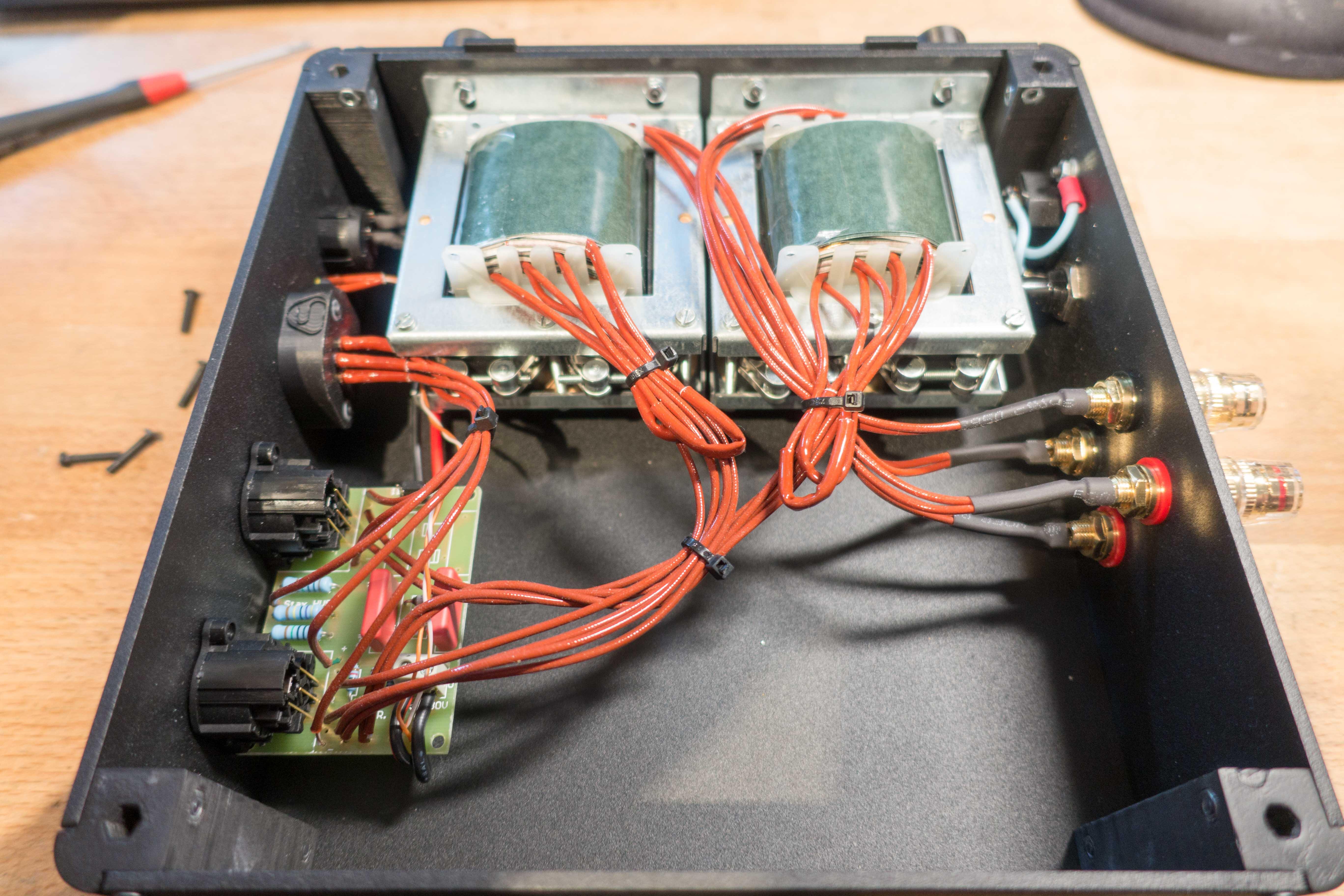

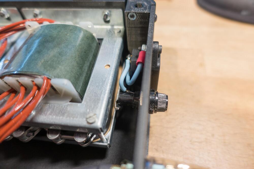

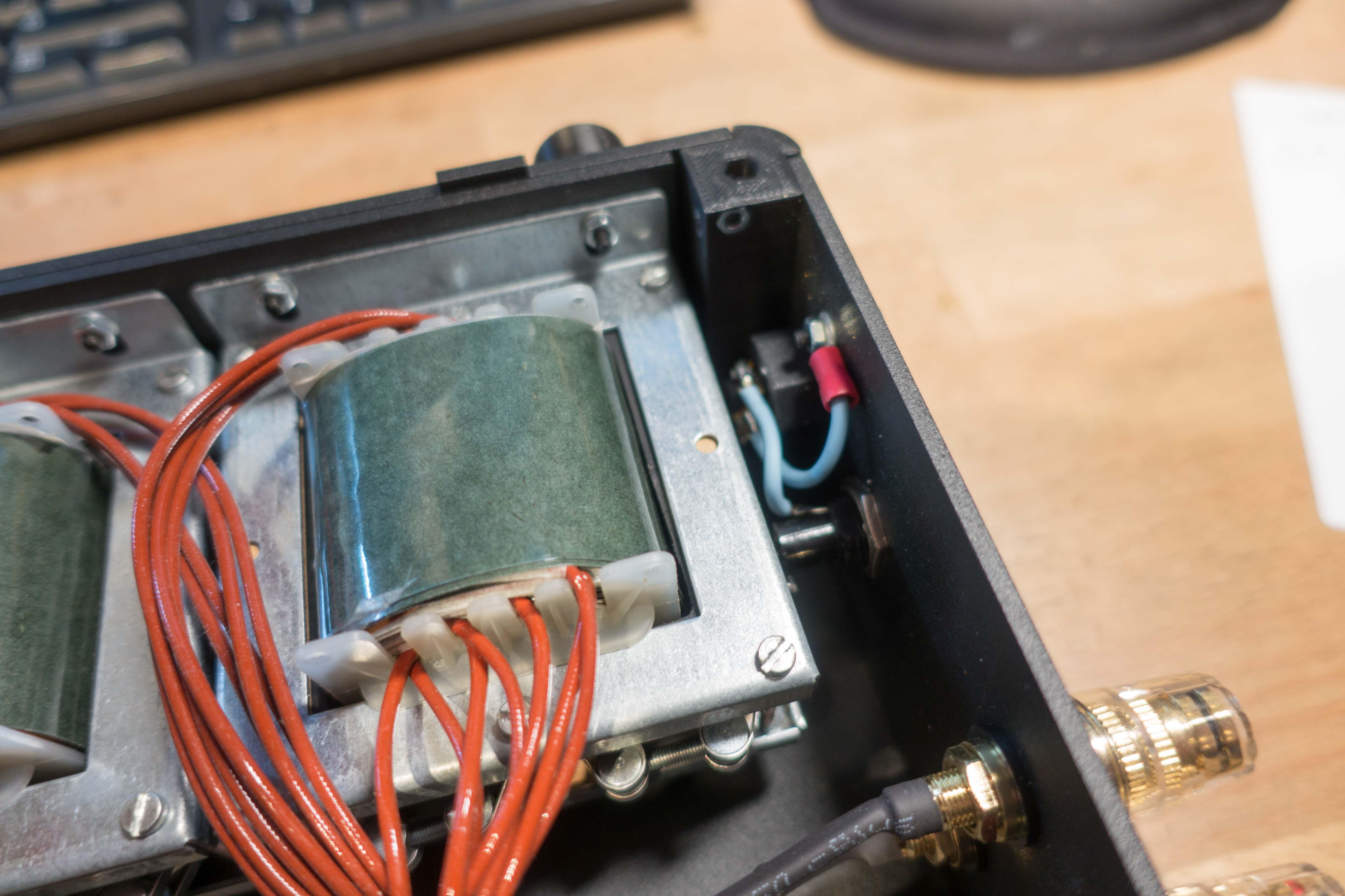

It's hard to capture on "film" but the IEC input and the fuse holder are completely uninsulated and mere millimeters from the metal frame of the transformers.  Thankfully the chassis is earthed but yeah, this is not to code and an instant CE violation there.
In the first picture you can also see there is no protection for the transformers at all and we will get to why that is an issue.  Now the active parts:

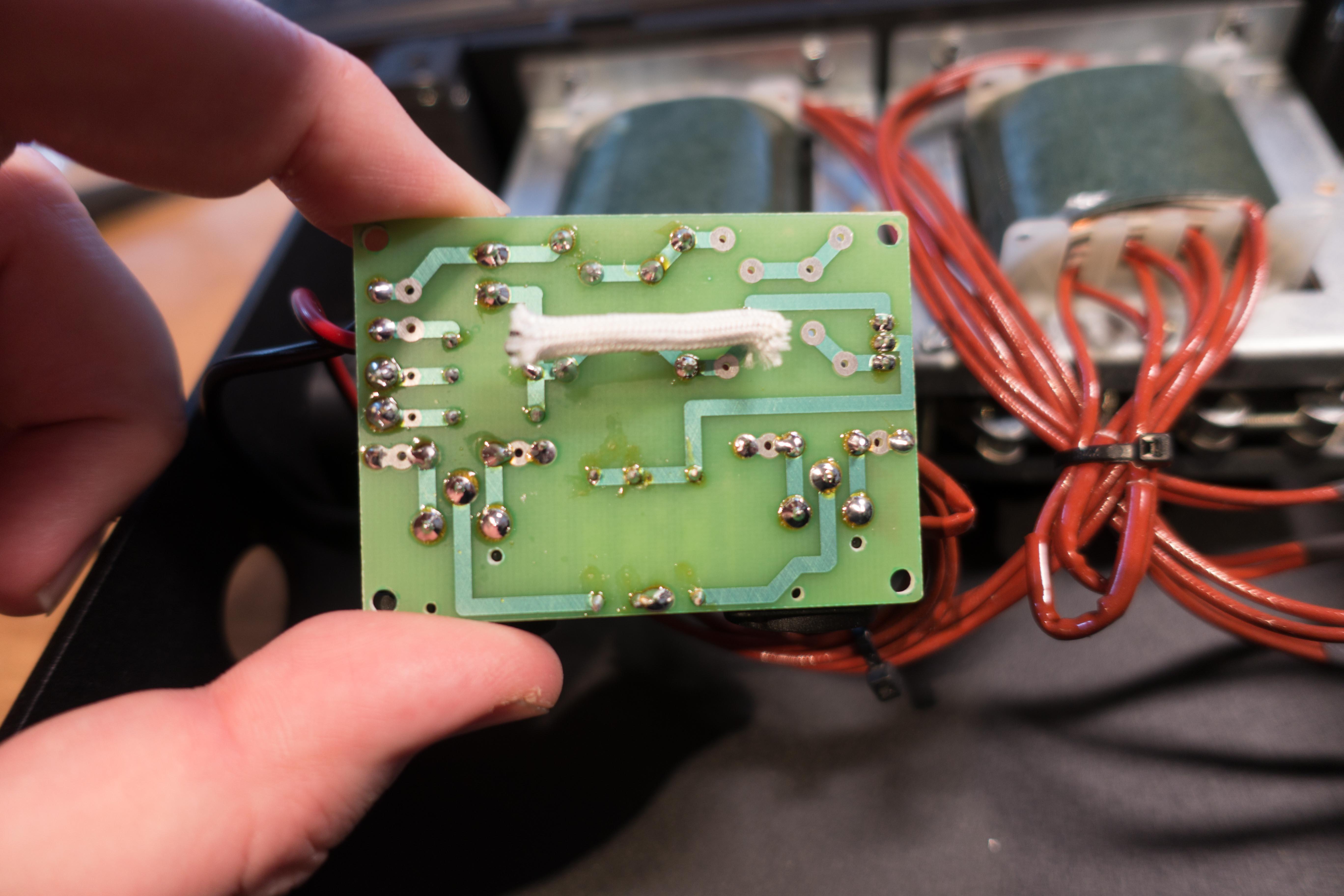

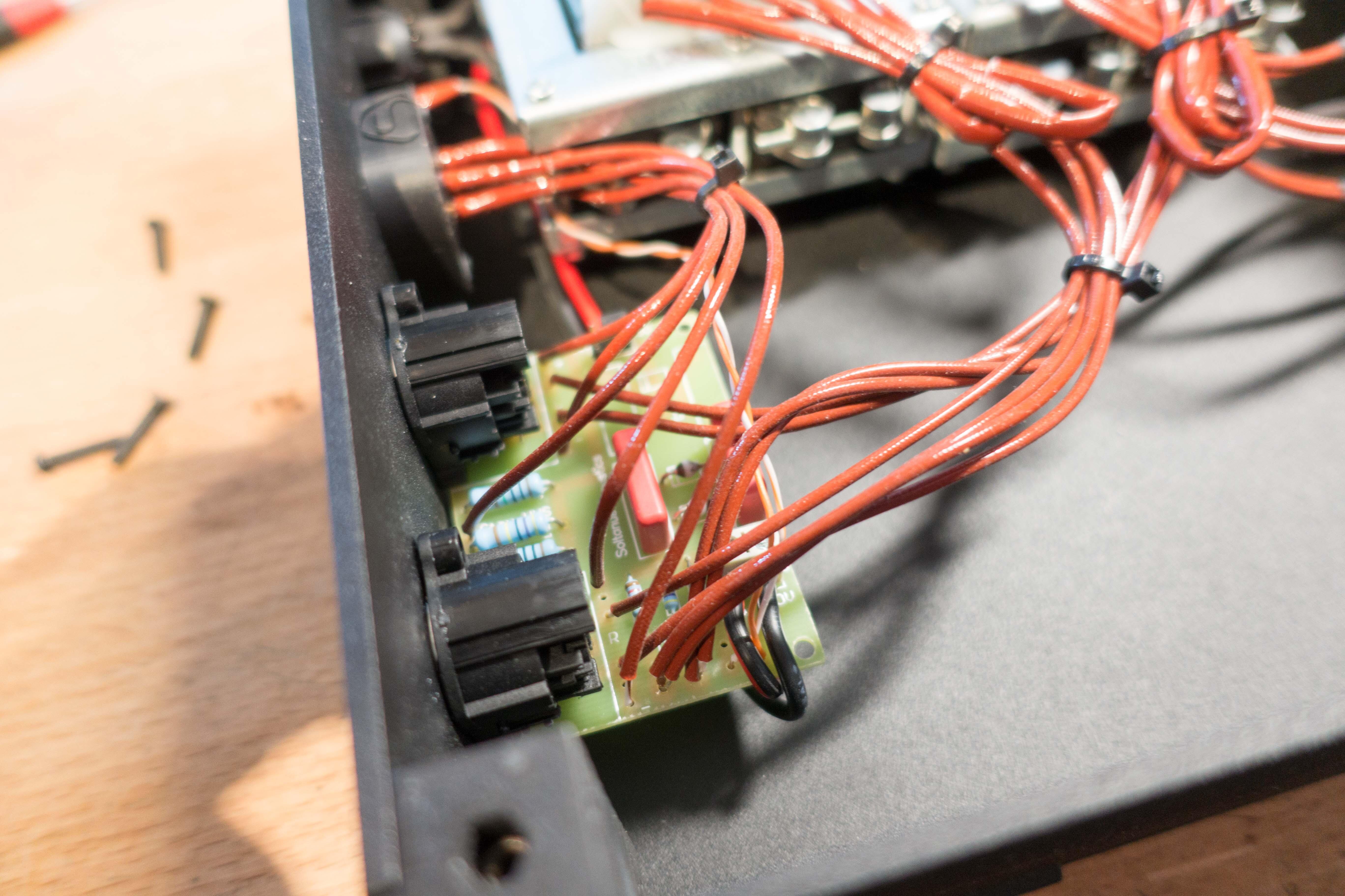

20211221-DSC00335.thumb.jpg.806c8e1caa509b428434e881a413c396.jpg20211221-DSC00334.thumb.jpg.85f0f74bb15475c9243a62be05ed7b28.jpg
The bias supply is driven directly off the mains, no isolation between you and the wall.  Now this was commonplace in the 70's but now... I'm not sure this meets any modern standards.  The bias supply is a simple voltage doubler and for 117V they just add another doubler on top.  There is then a 600V zener clamp to make sure the bias doesn't rise above that threshold.  None of this has the elegance of the Stax bias supplies and frankly this is just sad.  For instance the LED for power indication is driven directly off the mains, through one tiny resistor.
Now you might notice those 3 pin XLR's there and yup, they are the stock outputs for the Euridiche, the Stax output is just for convenience.  One of my biggest gripes is with using XLR's as they are in no way rated for these voltages, especially the cheap, no-name, units they are using.  Also check out the clerances on that PCB.. bias and high voltage signals less than 1mm apart.  Then we have what scares me the most, see those traces which go right to the edge of the board and into pin 3 of the XLR's...?  Yeah that is the bias so 600V is sitting there, pressed right up against the chassis with exposed solder connections.  Sure this is after the ballast resistors (one 4m7 for the Stax and separate 10M units for each side of the XLR's) but still... They have a lot of faith in the powder coating on the chassis.
Finally the Stax socket, 3D printed and fed directly off the XLR sockets.  Almost no way to actually cram a Stax plug in there but you know, I almost had to use a hammer.  😉
Then we come to the final issue, on paper these appear to be Stax compatible despite the stupid XLR connectors and similar bias supply but nope... they are so inefficient that my usual test amp (Icepower 50 module with a preamp tacked onto it) was at max volume to get these to my normal listening level.  I plugged in my test SR-207's as well and they were at half volume using this transformer box.  As seen in the first pic, I've fitted them with a Stax plug but they make the Carbon CC work for its pay so yeah, you need a very powerful amp to drive them.

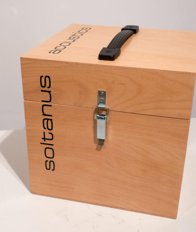

Now for the wanky things (besides that name, seriously... anus in your company name can never be a good idea ;) ) such as the box these ship in:
Almost Voce bad but at least it is well made, unlike the Mr. Speakers box.

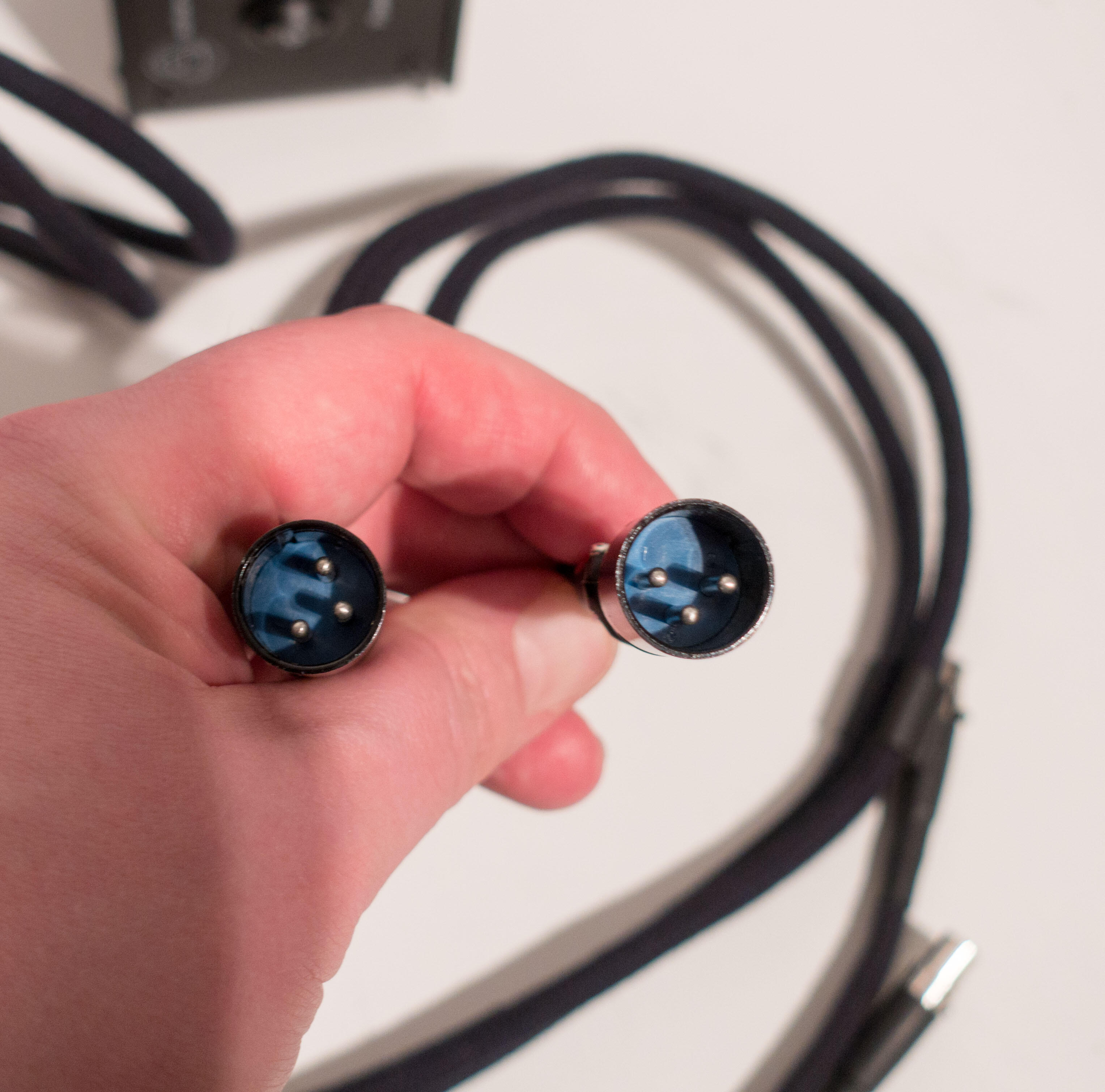

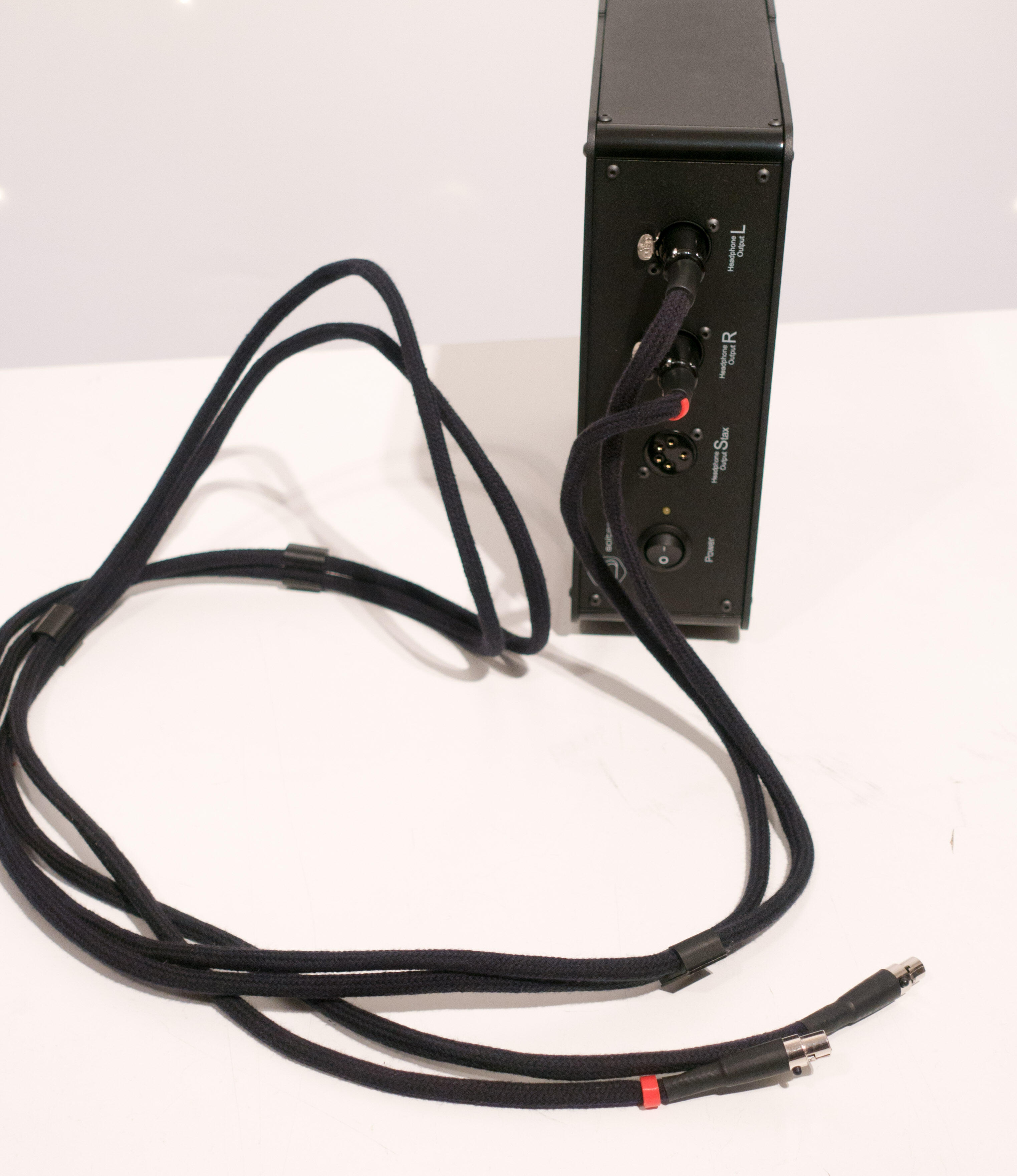

Here is the silly dual cable for these, male 3 pin XLR's on one end 3 pin mini XLR's on the other.  It feels terrible and I'll rip it apart later.
20211222-DSC00345.thumb.jpg.13b836a31c9016fa8e4a7b681353dc8e.jpg20211222-DSC00344.thumb.jpg.4110ac5ca5bfb5de14f739786c546b0b.jpg

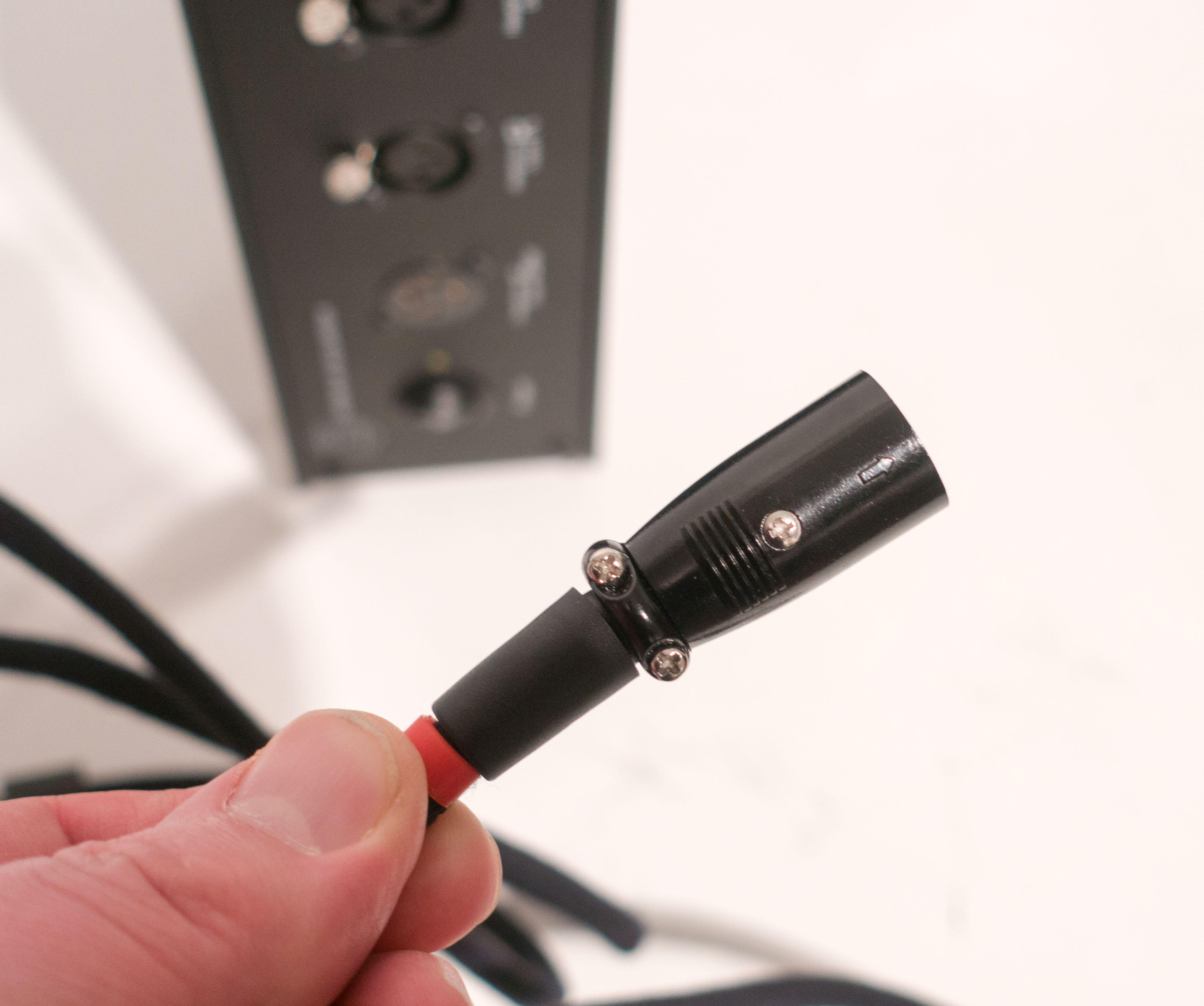

What truly bothers me is this shit, these are cheapest XLR's you can buy short of the knock off Neutriks and they are pushing 600V bias and 200Vrms through this?  Yeah it's not ok...
I'm thinking about what I'm going to do with that energizer as the transformers seem to be pretty decent.  Probably just fit my own PSU to it and change it to three Stax sockets that the headphones actually fit into.

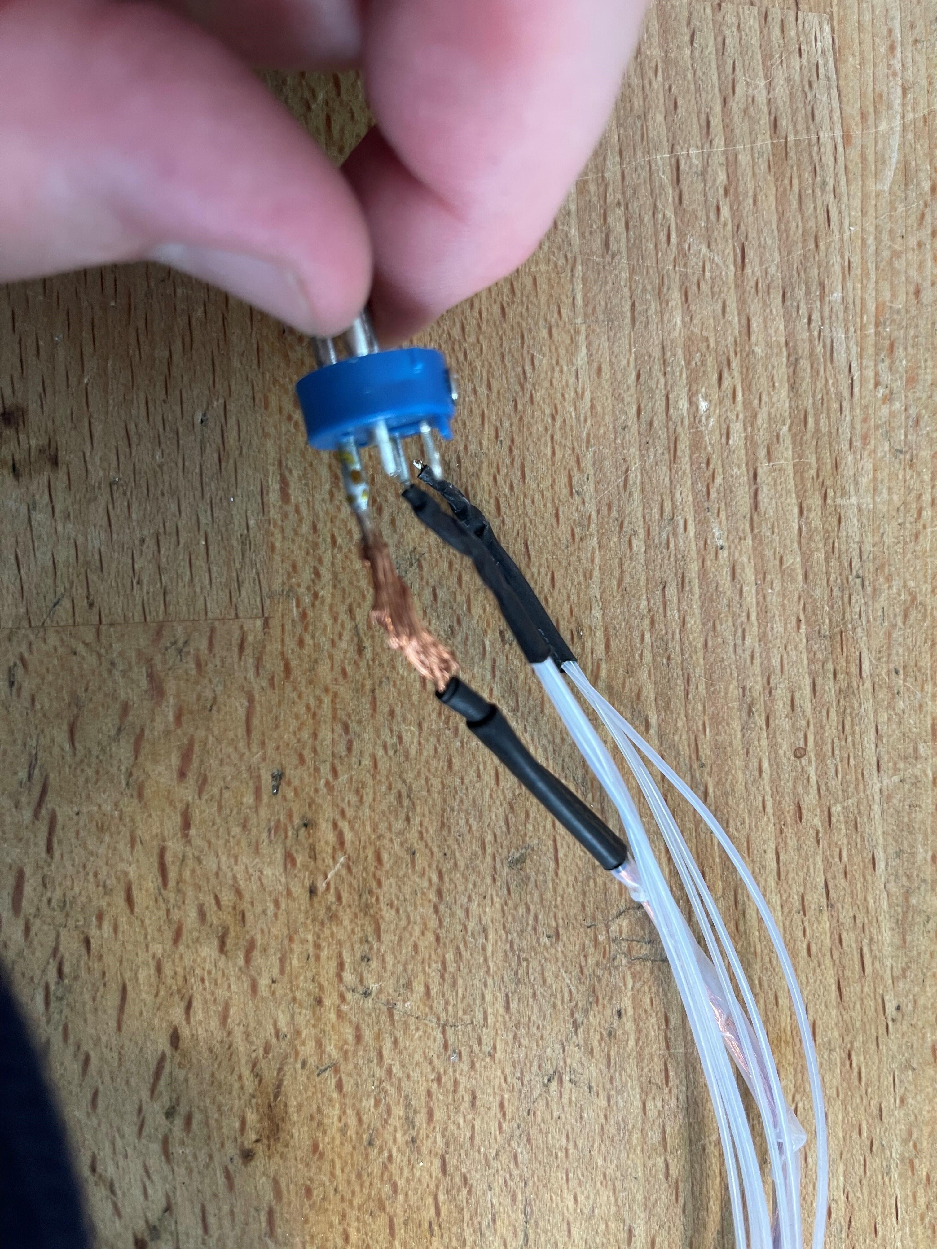

While I'm at it, here is the cable they use:
Just took some quick picks with the phone, can't be arsed to spend any more time on this:
So those are the cheapest XLR's money can buy and possibly the oddest cable I've ever opened.  The signal is carried on those thin wires but the bias is on a massive copper mesh for some reason.  Now somebody spent a lot of time making this but that doesn't mean any of it is a good idea.  First off, the teflon is clearly very thin when the proper 600V stuff is not and in what world is it a good idea to have the highest current capacity for the bias wires?  The bias supply is tied directly to the mains, if the bias resistors fail and all hell breaks loose... you don't want what is essentially a mains cable coming up to your head.
