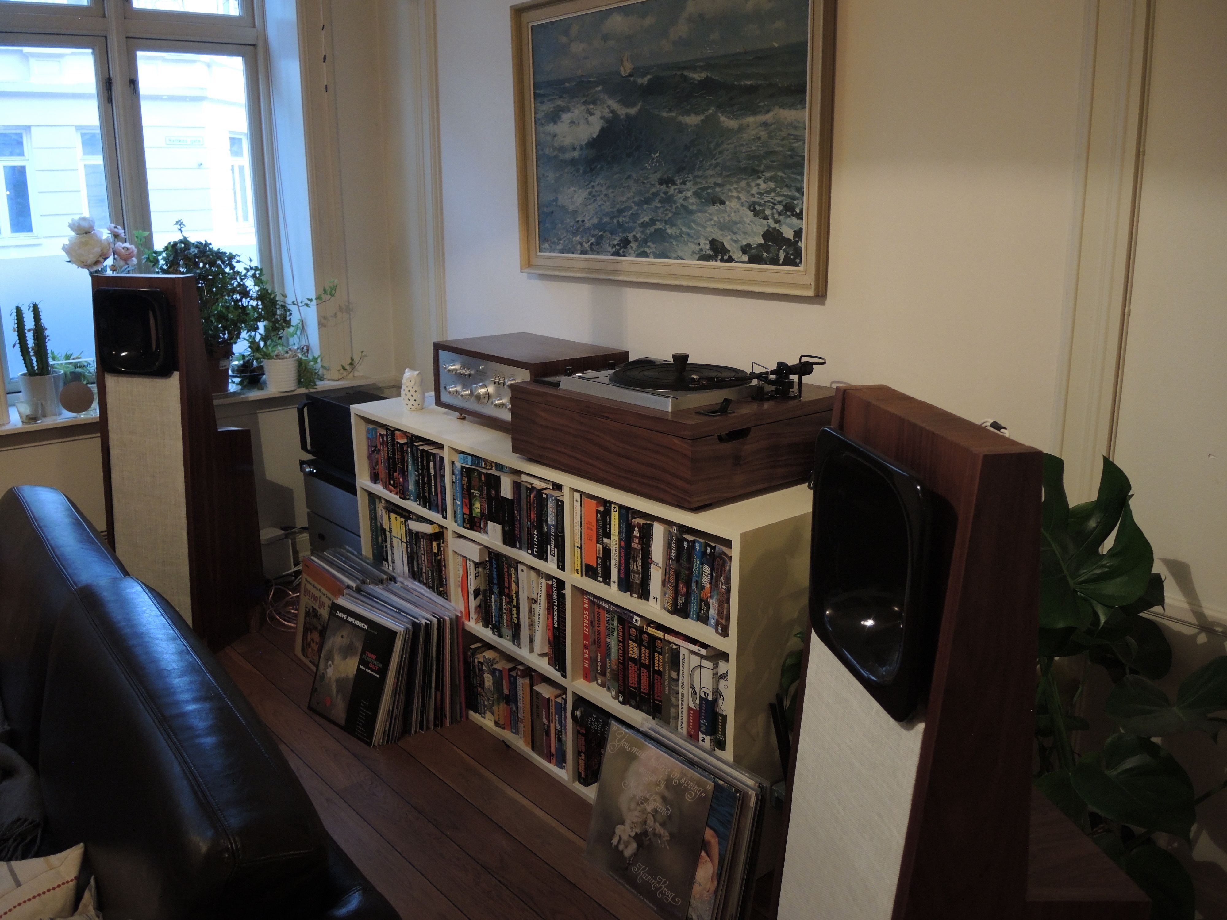

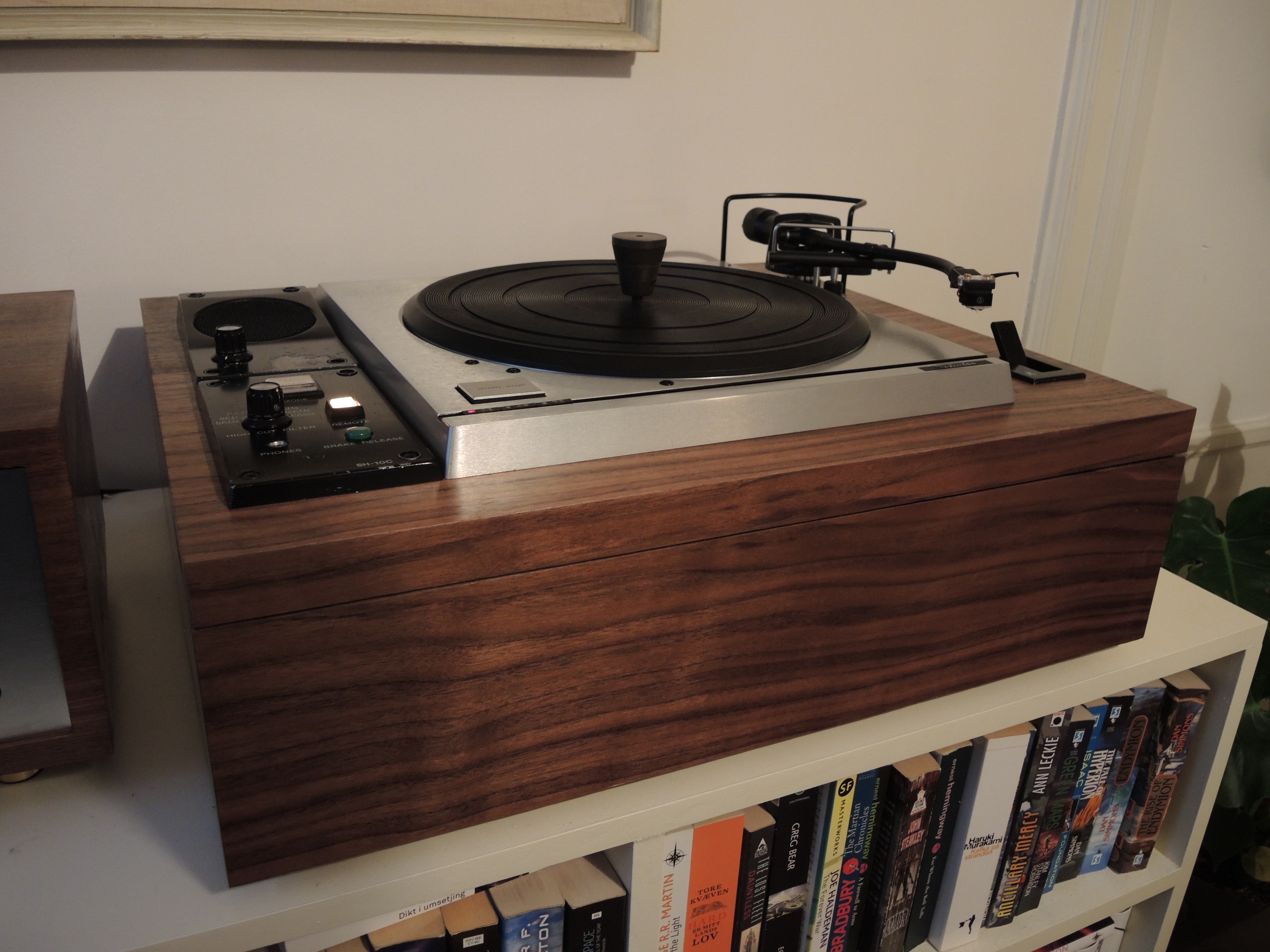

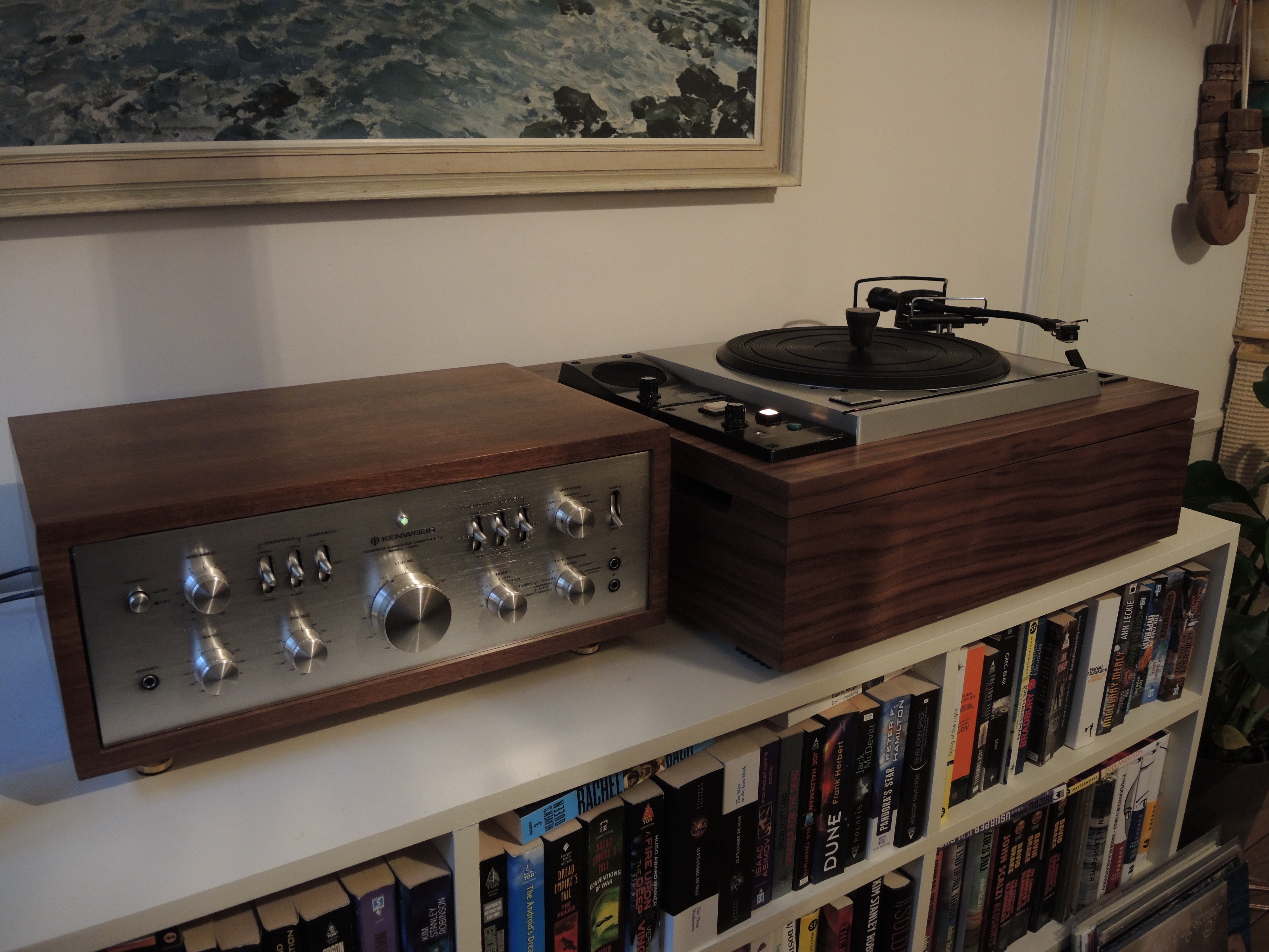

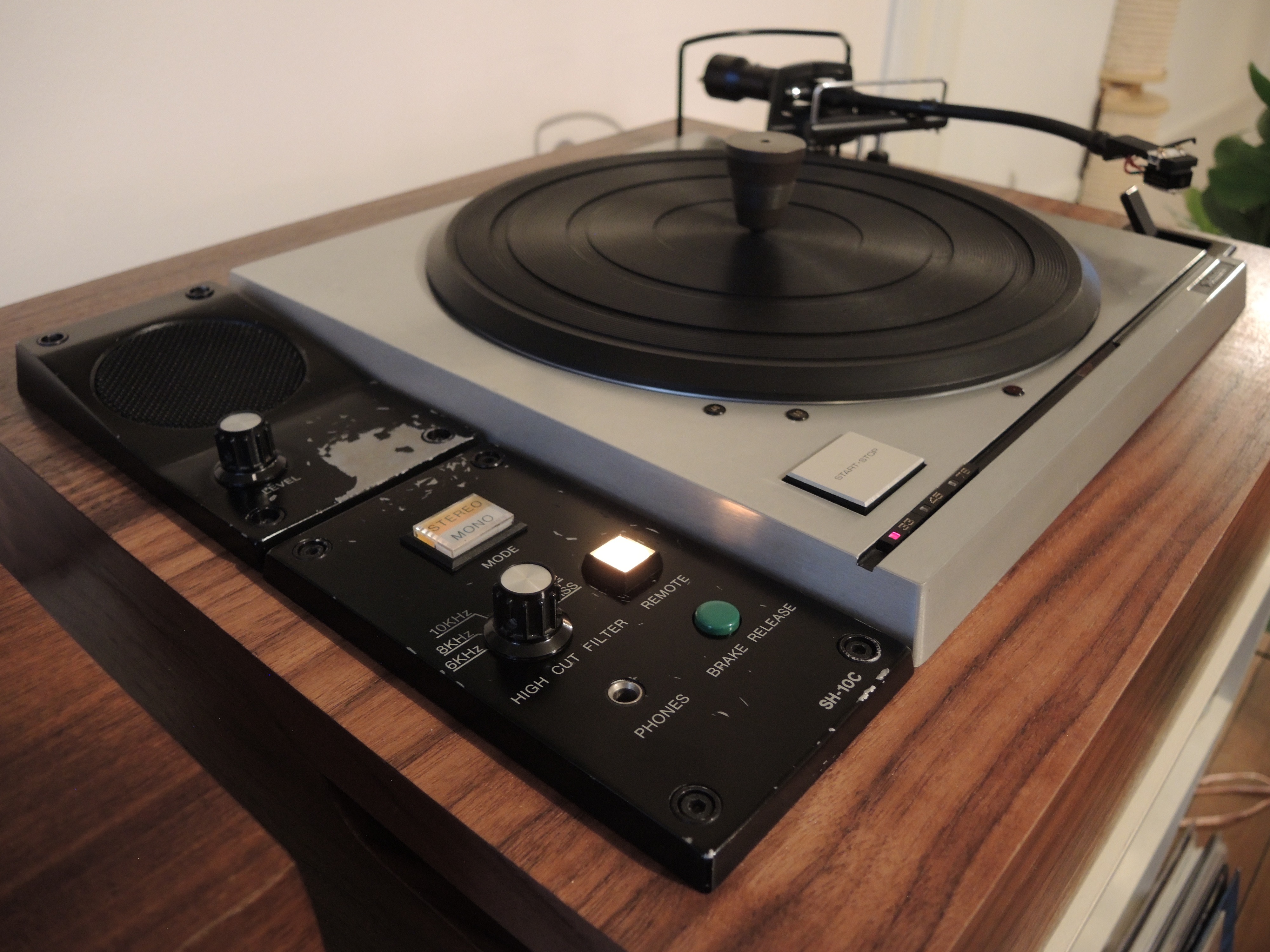

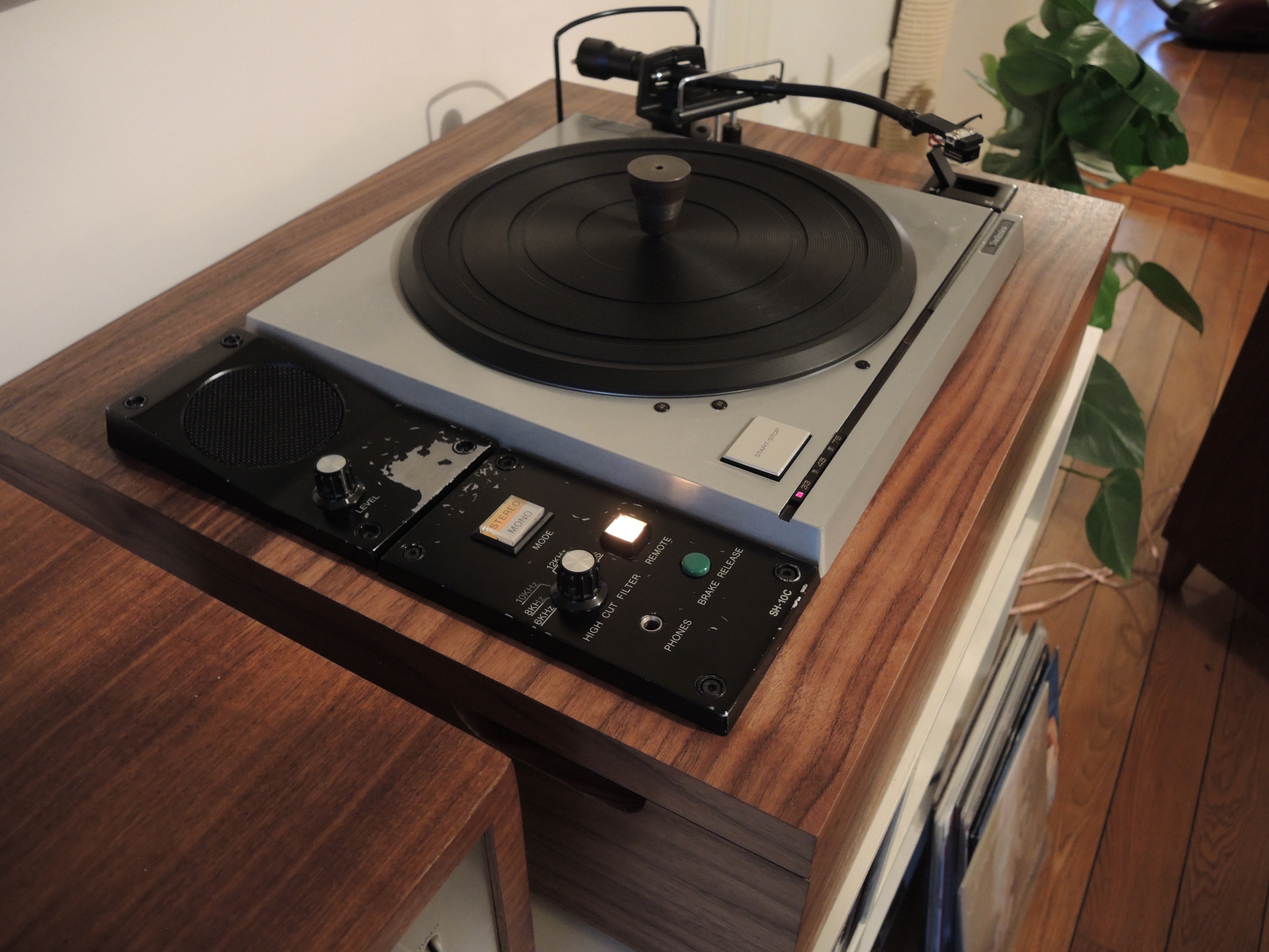

i think it turned out pretty well in the end!
1.thumb.jpg.ac7bb7f944c5adcac71a5baaa0543ce7.jpg2.thumb.jpg.0d813237d239f6511b0e48a221a92ce0.jpg3.thumb.jpg.012c5d684f9be3c708906992cb3f6576.jpg4.thumb.jpg.22a4c583e822d69849c8226151901598.jpg5.thumb.jpg.67600e1e4dad36fa6d0b7bd154b2f741.jpg
(sorry MPI, but i forgot to casually drape the Fostex T30 over it before the photoshoot)
9 minutes ago, Craig Sawyers said:
^This. Really nice job.

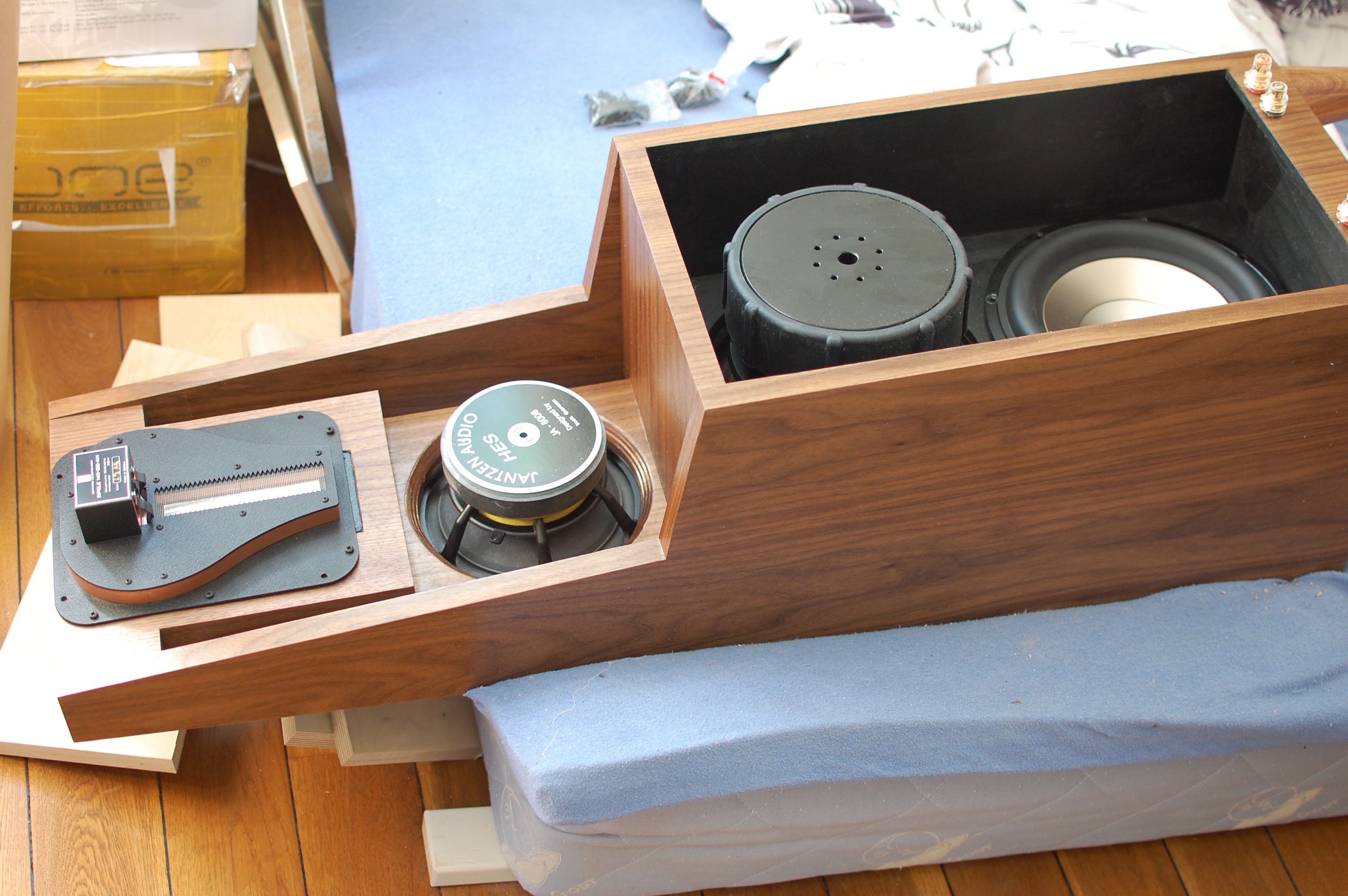

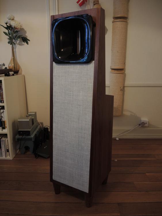

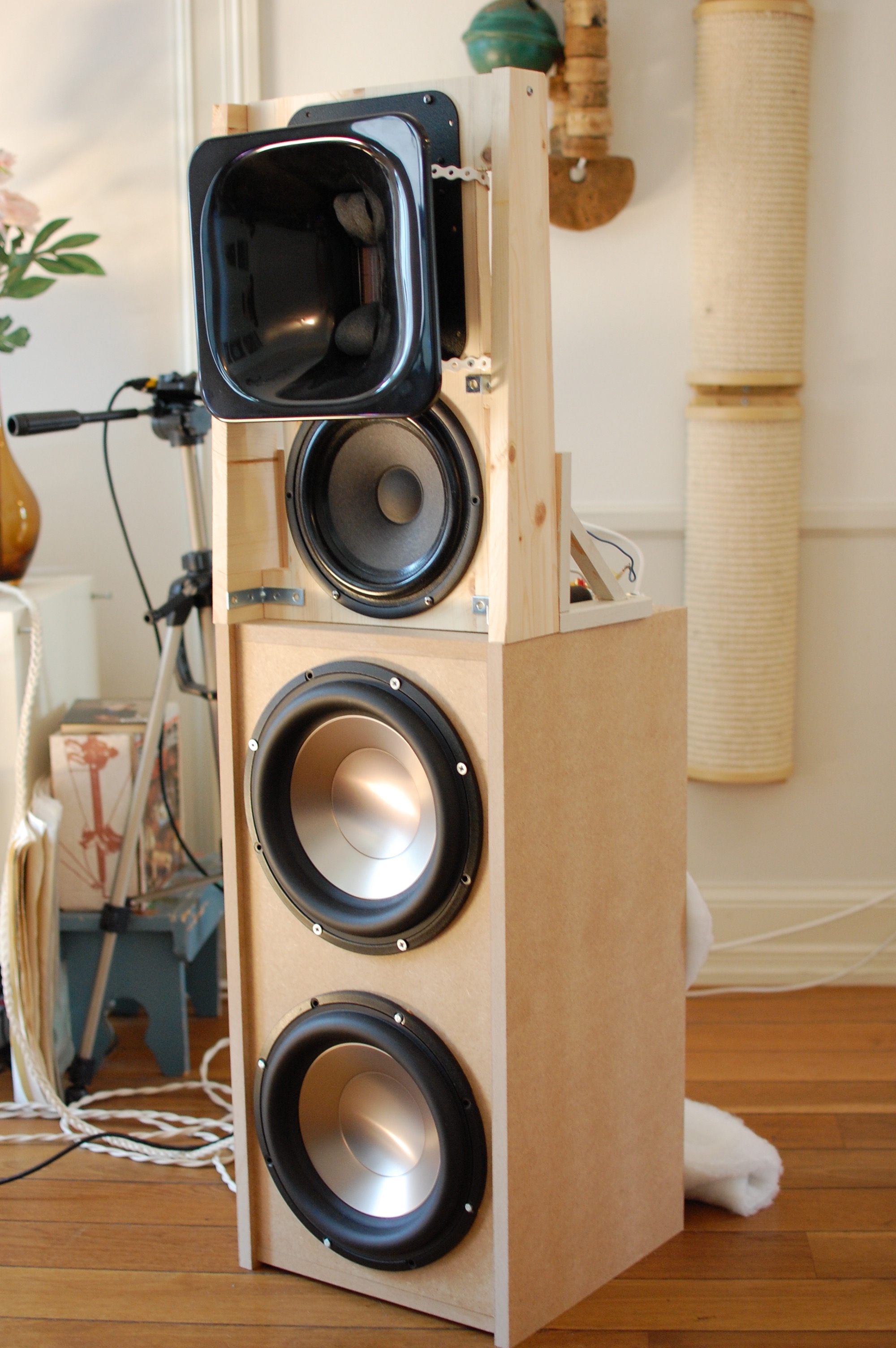

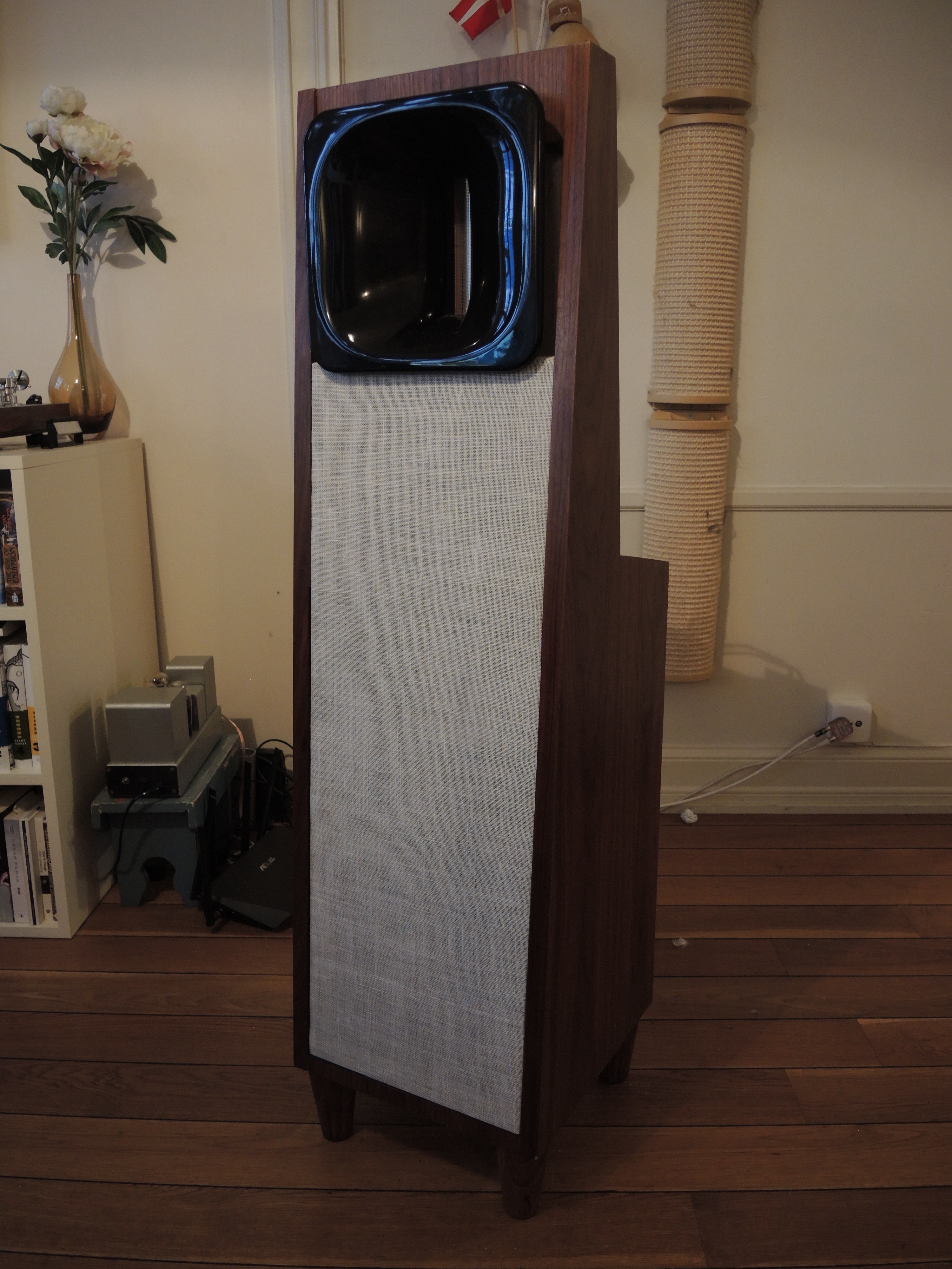

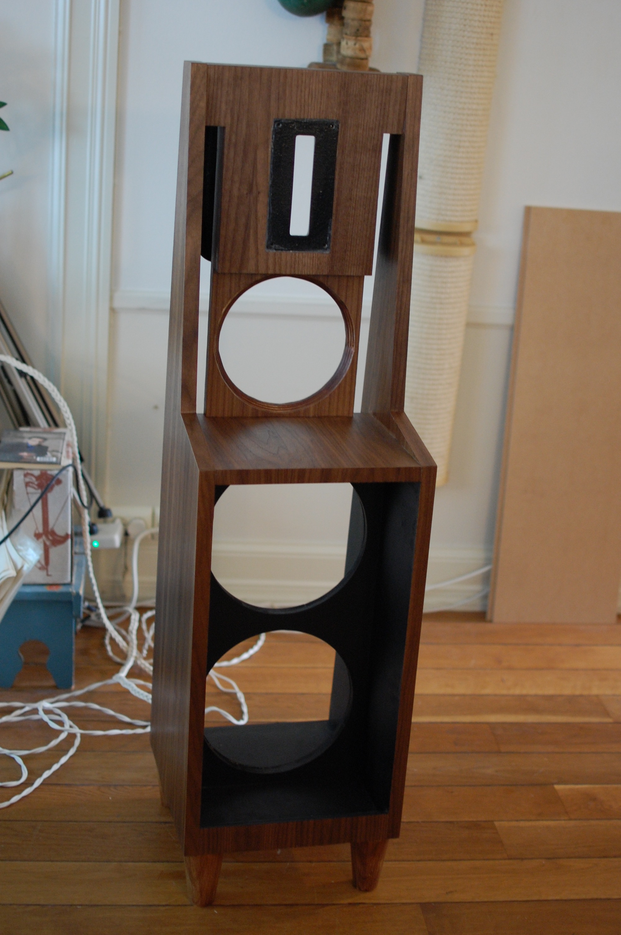

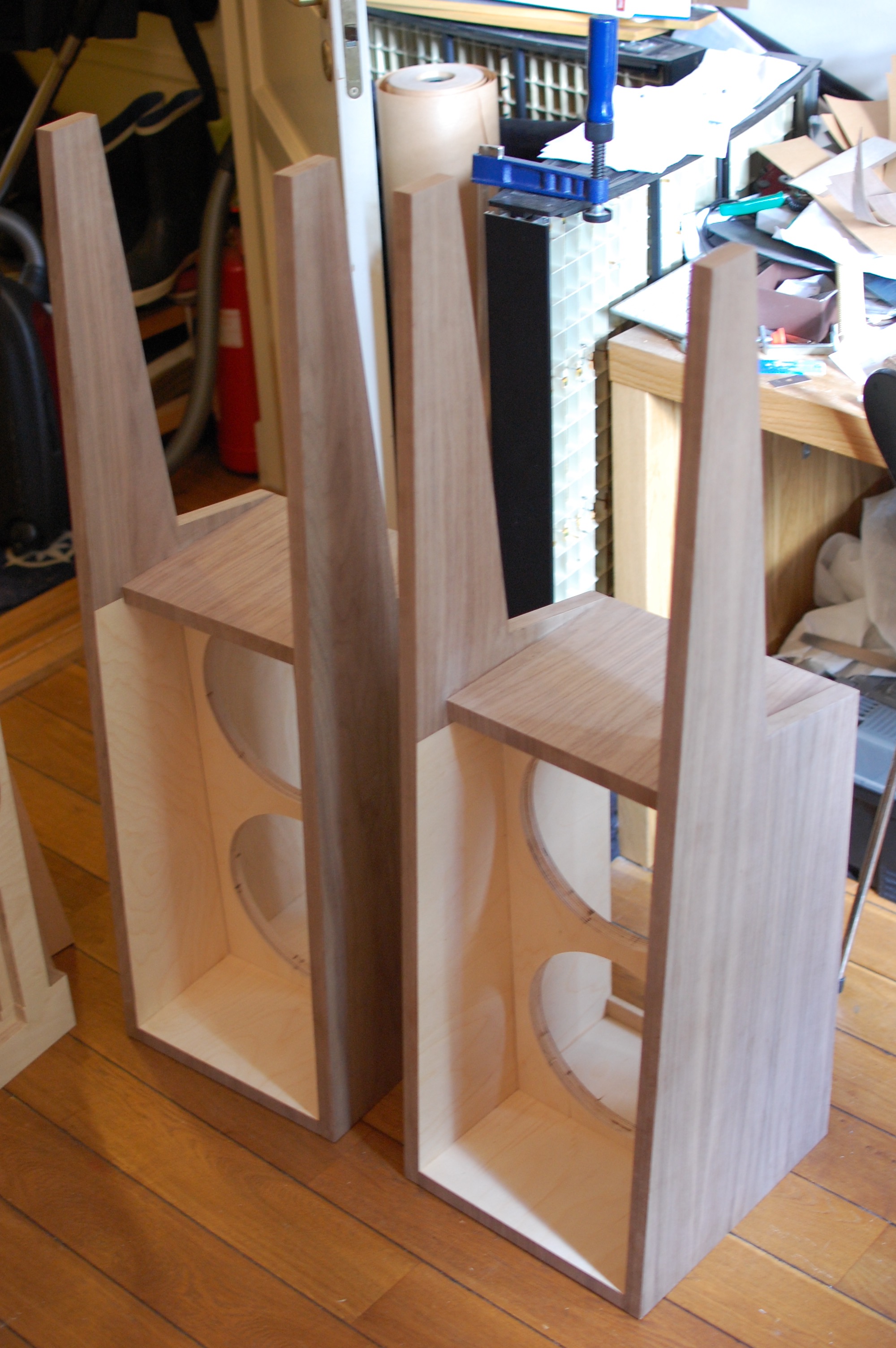

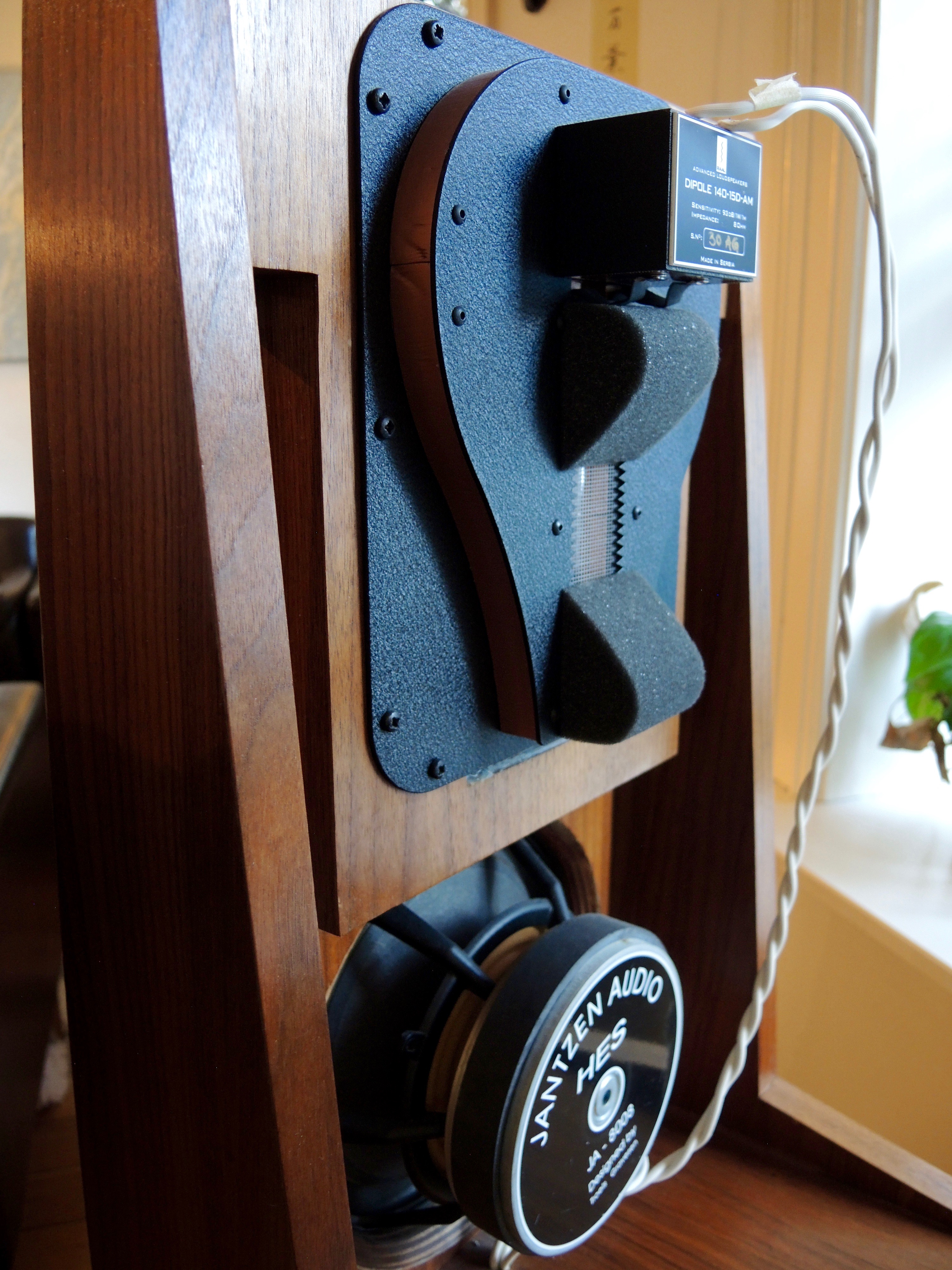

What are the speakers, Bjarne?
DIY OB speakers.
made them back in 2013, to replace my unreliable ESL63's.
DSCN5145.thumb.jpg.945e2375b3eed565ae3f6589b1e85b05.jpgDSCN5150.thumb.jpg.eb75daffca4dfbff359774a91446c7f0.jpgDSC_0357.thumb.jpg.76092233ba22d4a24cd418ceb8e5cd4b.jpgDSC_0362.thumb.jpg.26cb5348b30d1c9adc27a0f785743ec9.jpg

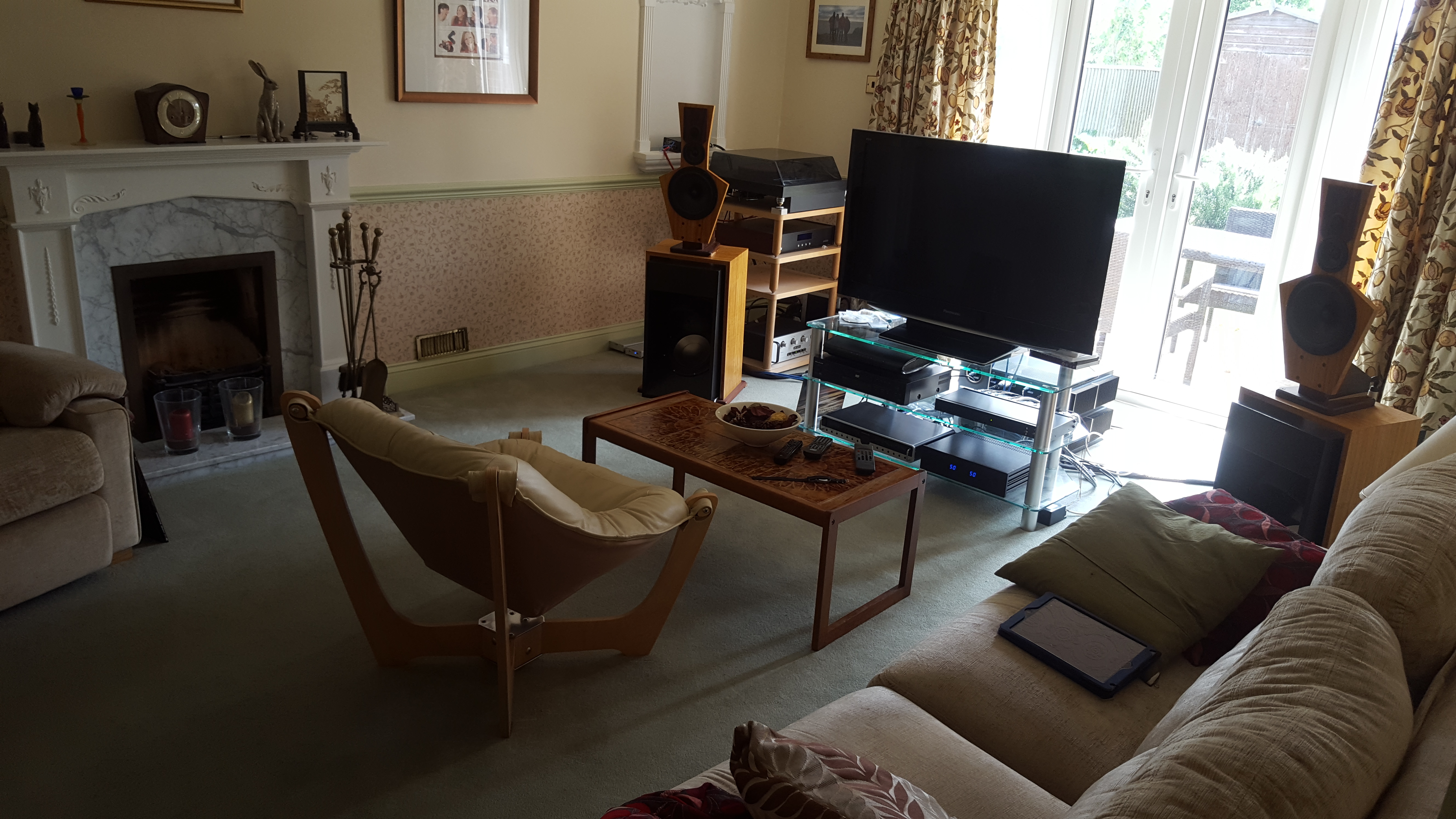

That looks like something based on the Linkwitz Orion. I have the same SEAS woofers in my Linkwitz LX521.
yep, it kind of uses the same principles as the LX521, only 3-way, and i used a waveguide to match the forward dispersion of the ribbon to the midrange.
the reason i chose the JA8008 was that it had nice and even dispersion all the way to 2500hz in a minimal baffle, so it could reach high enough to be crossed over steeply with the RAAL.
i probably did sacrifice some controlled directivity past 70 degrees due to the side supports, but i built a prototype with and without, and they measured pretty similarly, and i couldn't really hear a difference, so i kept them.
visually it was a big improvement ;)
i did try out a dampened u-baffle as well, but never could get it to measure like a cardioid, so went with an H-frame instead.
