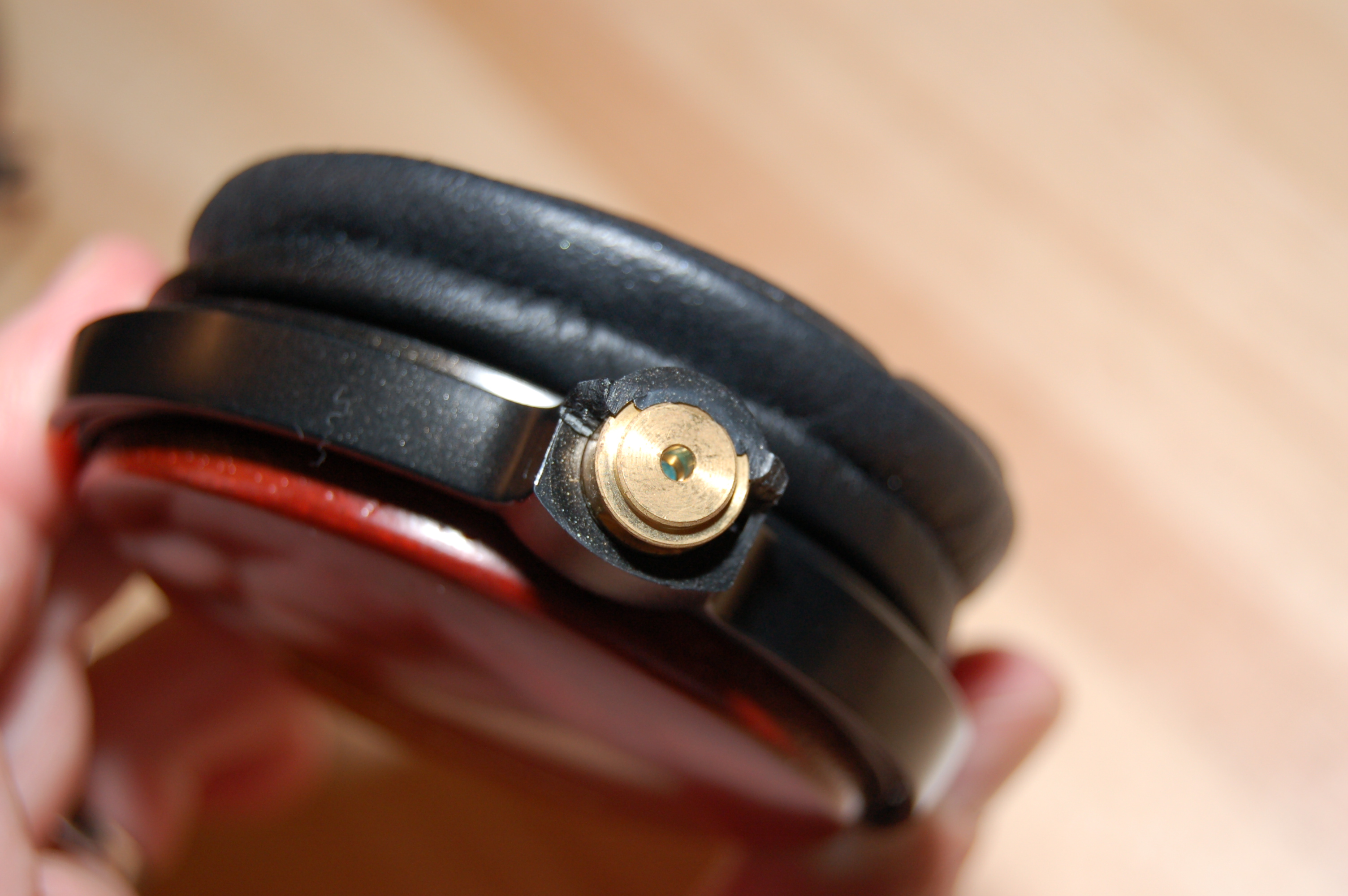

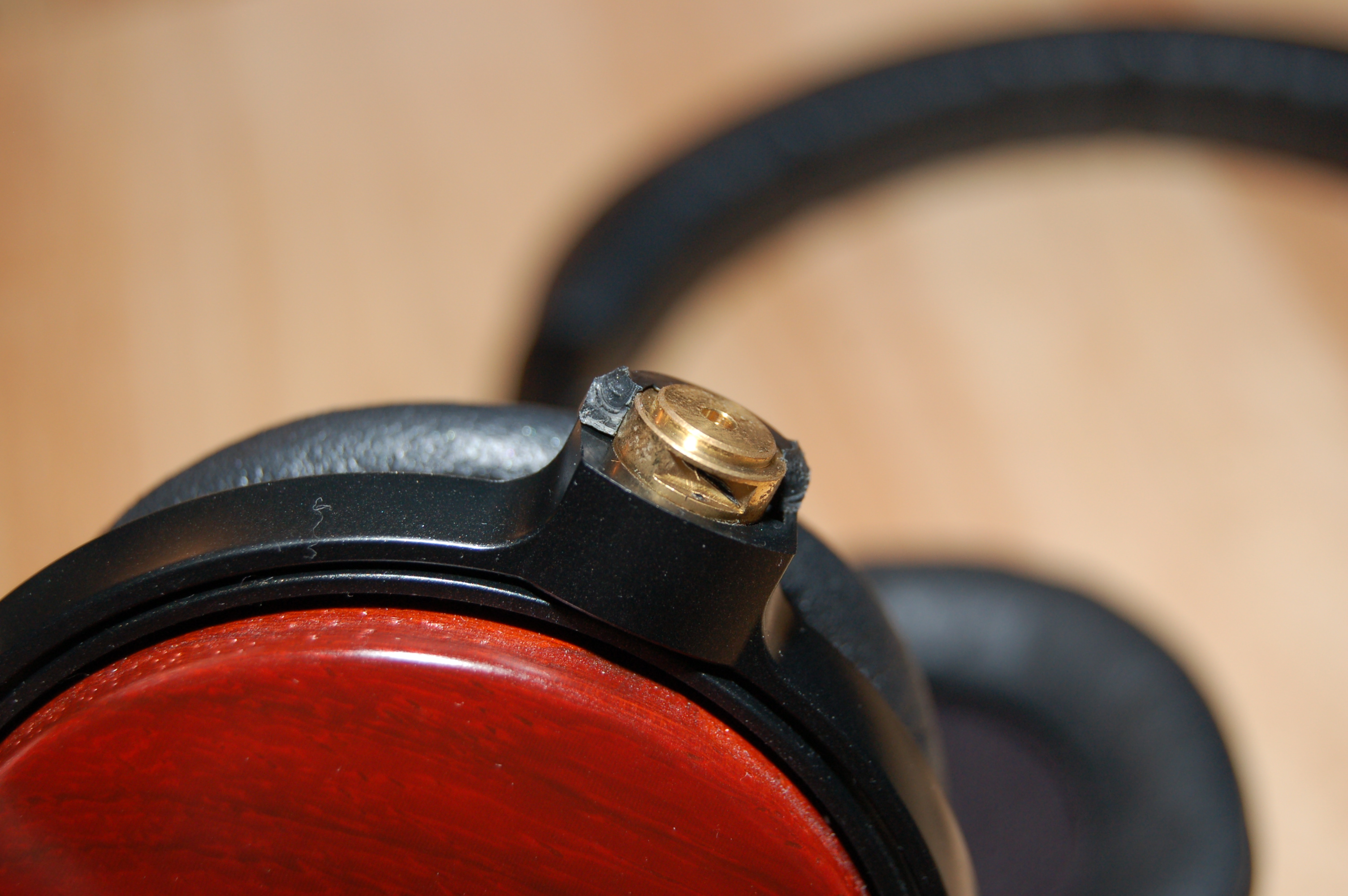

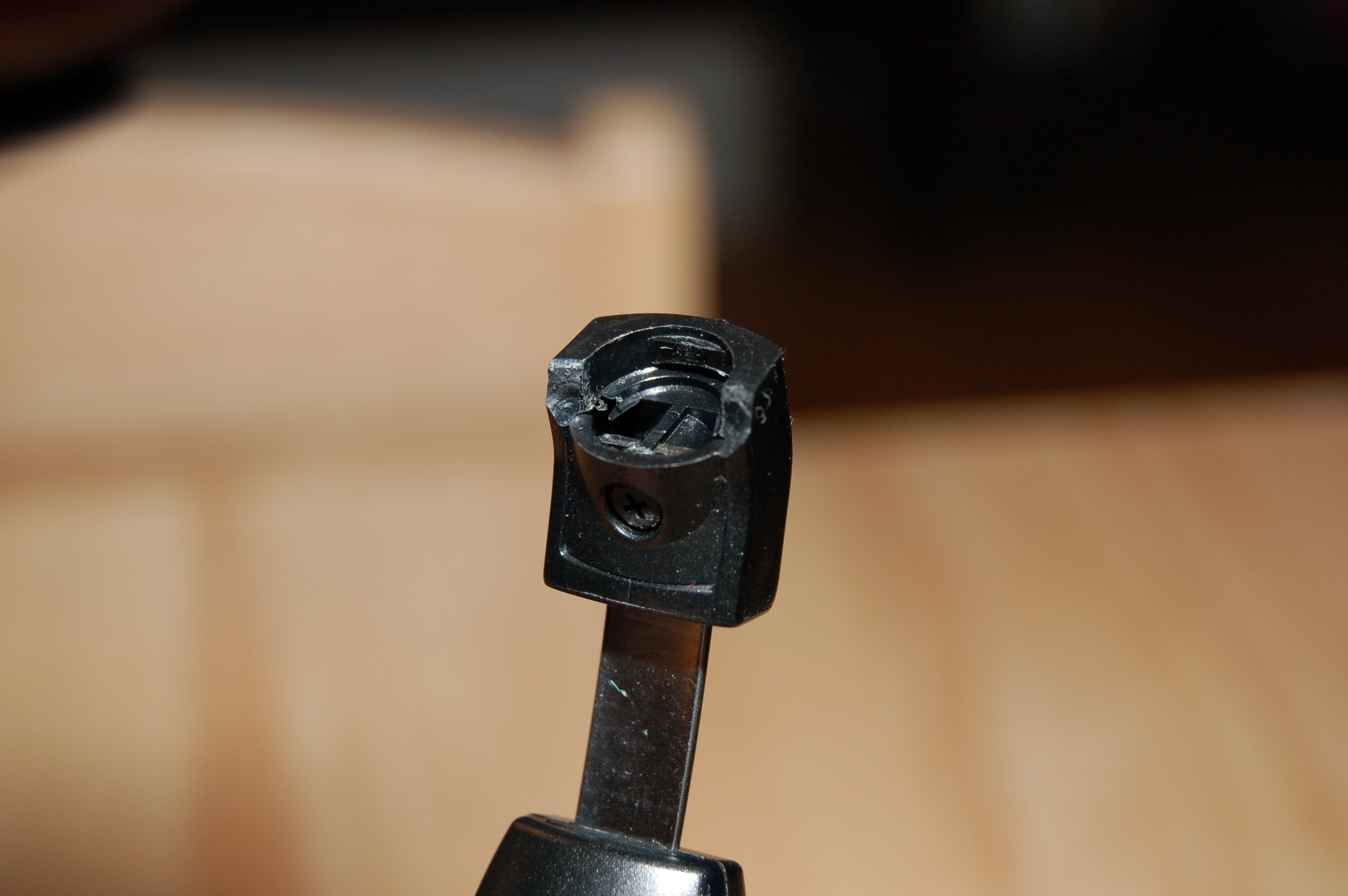

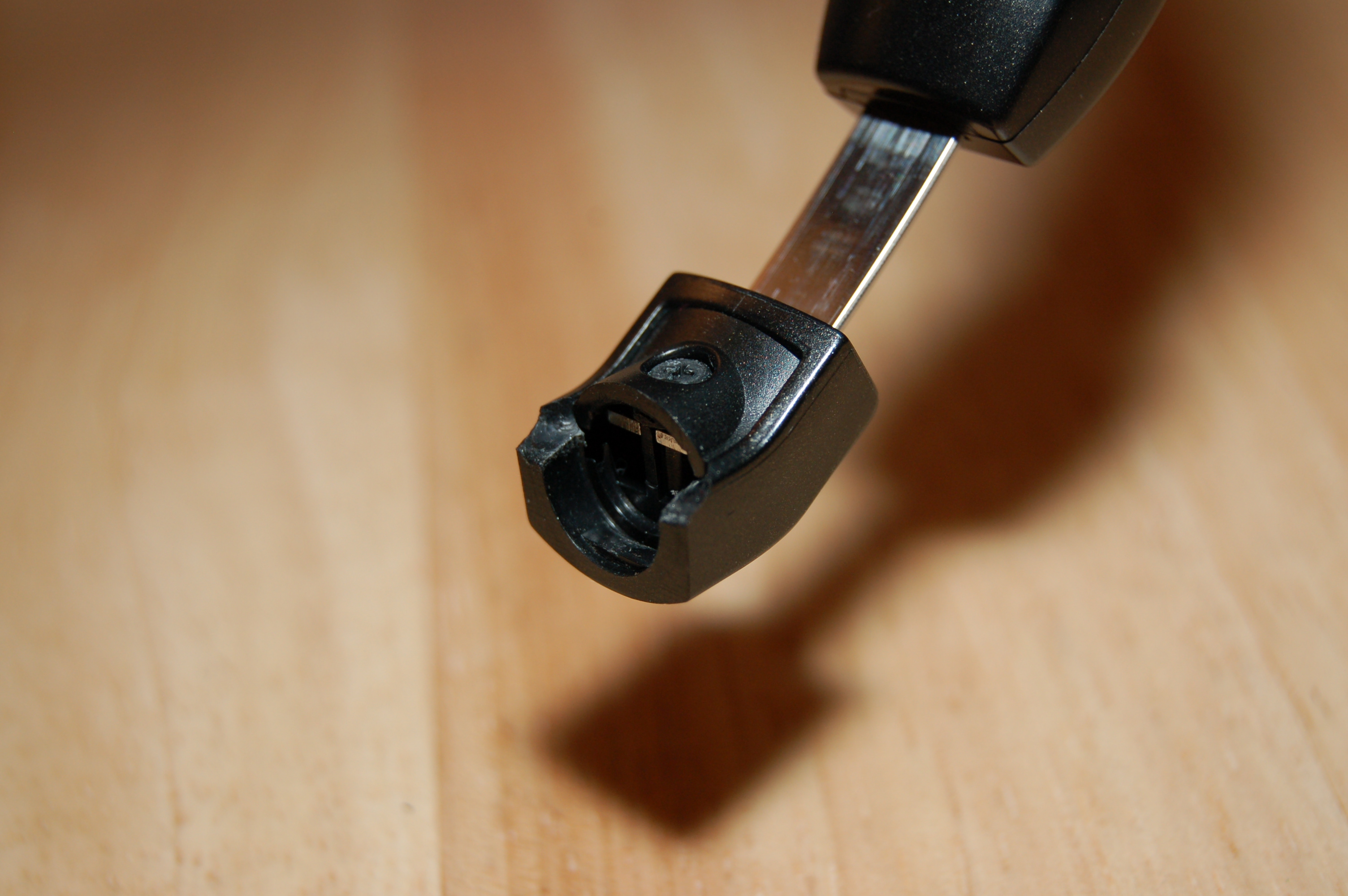

The left earcup snapped off. You'll see from the pics that there is a sort of ring or collar made of black plastic around a brass/metal part. That black plastic piece snapped. I'm not sure how modular these things are, but it looks like some Krazy Glue might do the trick. I welcome your suggestions.

Some krazy glue would do it, tho you may need to unscrew a screw or two to attach the two pieces back together snugly. You'd know better than me.
Just be careful when swiveling the earcup after the repair. (..and when headbanging)

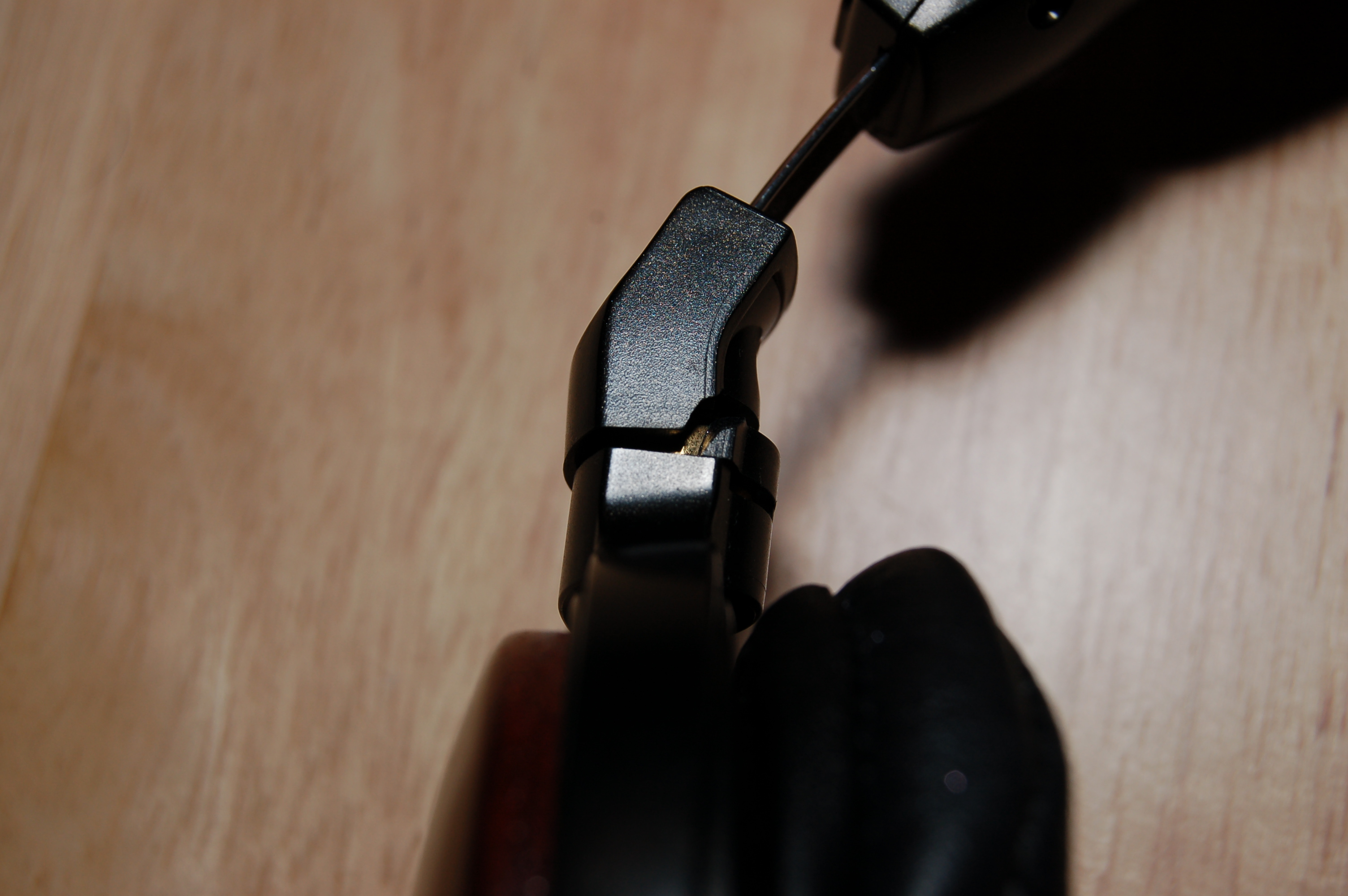

Hmmm. The plastic thingee pivots around the brass part, right?
It actually doesn't. I remains fixed and the earcup portion turns within that part of the plastic collar.

I'd drop the AT service center an email or phone call and see if they'll send you parts. Glue might work, but I'd prefer a more permanent fix.
Yup, I agree. Will touch base with them today.
I had been hoping to listen to Absorbine_Sr's at Chiunifi last weekend, but his had done the same thing. He said he has super-glued them a couple of times. I wonder if a good two part epoxy might work better? I would agree with Nate that replacement parts would be what I would do as well.
Surprised they made these out of plastic like that on a ~$250 phone :chair:
Yeah, I would use a good epoxy, JB Weld or something. Make sure to properly clean both joints first. Of course, a replacement part would be ideal.

Yes, a glob of epoxy will fix that, and probably make it stronger than it was to begin with. But, use a 24 hour epoxy -- not one of those quick set types. Also, don't be tempted by the Gorilla glue as it expands as it cures. Finally, get a small clamp to hold it while it sets -- it will need to be held firmly for a long time (hours) to make a good bond.
