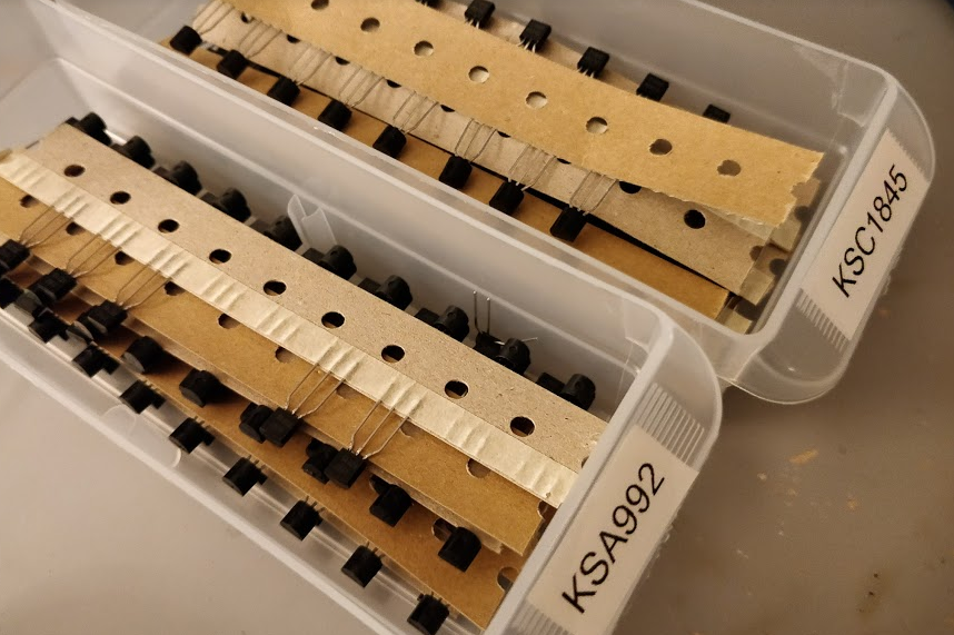

1 hour ago, PretentiousFood said:
I think I have about 100 of each (ksa992/c1845) that I'll never use if anyone needs. Can check tonight.
What grade are they? I'd love some if you can spare them!
Edited by Ariamella
Mouser's finest!
I'm not sure about the hfe grade as I can't find the receipt. The package says FCE. FCE is not an hfe grade, but E is the highest and sounds like something I would buy.
Shoot me a PM if you'd like.
3 minutes ago, PretentiousFood said:
Mouser's finest!
