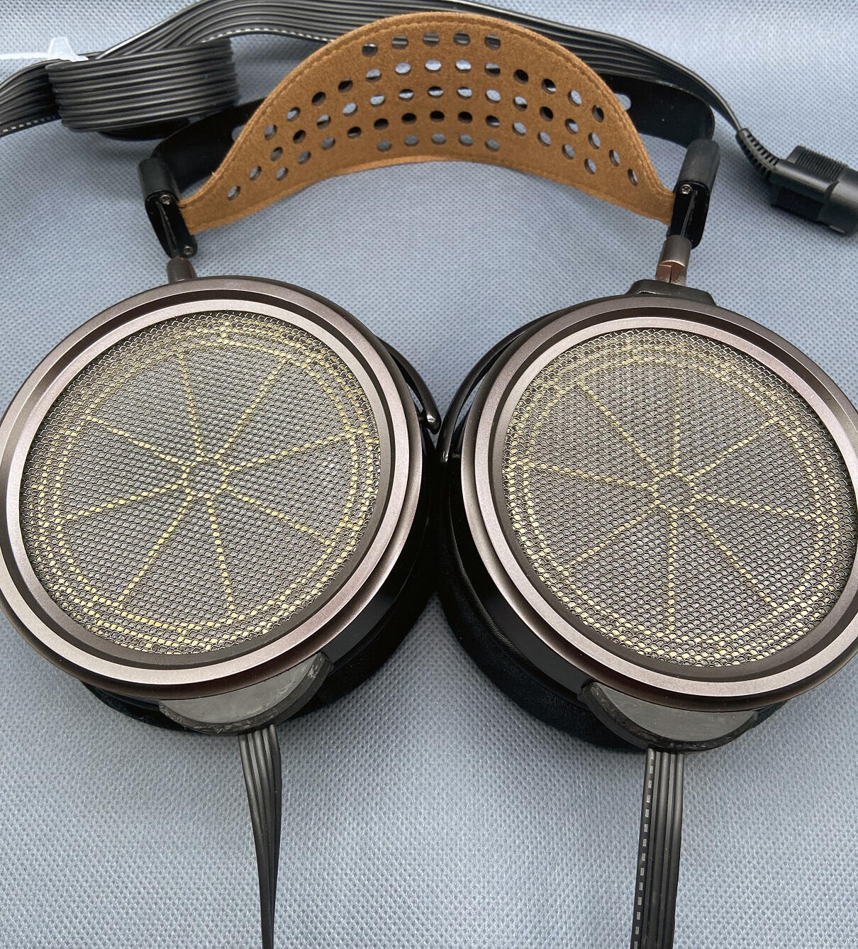

Hi-Fi-Anatomia Posted July 28 Report Posted July 28 (edited) I'm really thinking that they "gimped" the 007s design on purpose.... They moved away from the gold plated fiberglass electrodes to what appears as aluminum electrodes just like 009 and Lambdas. The outer area that was solid on the previous iterations of the 007 have also been reduced probably to reduce capacitance, but this decreases the damping on the membrane. I'm sure that the new 007 probably presents with a degree more of that midrange "rising response" that we see on nearly all the other STAX using similar design philosophy and brighter treble. The pads now resemble the dimensions of the 009 especially with the uniform opening. I think that a big part of the 007 sound was the D shaped pads which would distribute front volume modes better than a uniform circle.... The 007 was a distinct tuning in the line-up and they for reasons only known to god put it in line with the rest... Some sorta 009 lite design. I can't say I really like STAX sacrificing the engineering of their older models for "easier to drive" alternatives that don't sound as good.... Edited July 28 by Hi-Fi-Anatomia Quote

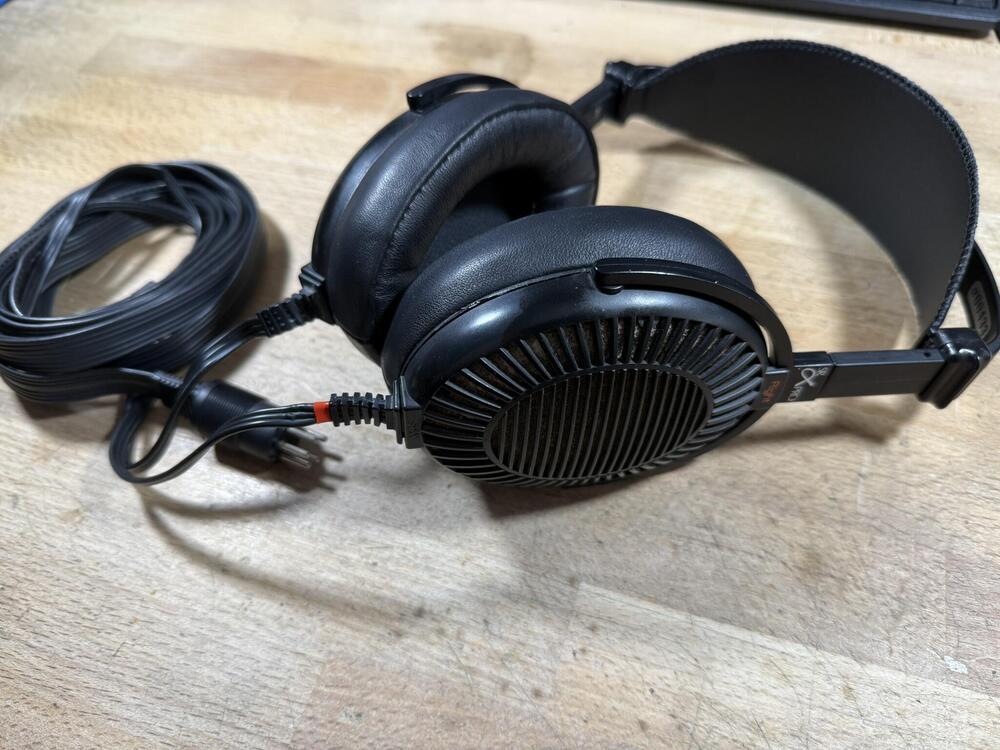

spritzer Posted July 31 Report Posted July 31 Well he has lost his marbles... I must say though that I feel the same way for current day Stax, they just sound a bit soulless and appear to be lost. They came out with the L series... but why make those changes? What is the purpose of fucking with the imaging on those and the X9000? Take this SR-Alpha Pro (Japanese Gamma Pro btw.) I got this week, it was utterly disgusting when it arrived so earpads and headpad had to go and a lot of time spent cleaning them up. Drivers were perfect though and they did clean up nicely: They sound far from perfect but I'd much rather use these than the 007S. They sound more alive despite their limitations and the tiny driver. 2 Quote
Hugo Posted August 1 Report Posted August 1 On 7/31/2025 at 9:11 PM, spritzer said: Take this SR-Alpha Pro (Japanese Gamma Pro btw.) I got this week, it was utterly disgusting when it arrived so earpads and headpad had to go and a lot of time spent cleaning them up. Nice! Are those pads DIY? Quote
spritzer Posted August 2 Report Posted August 2 I think they are HD650 pads but they were just some I found in my stash of earpads. I had to trim off the plastic ring at the bottom and attach them with double sided adhesive but it fits nicely on there. 1 Quote

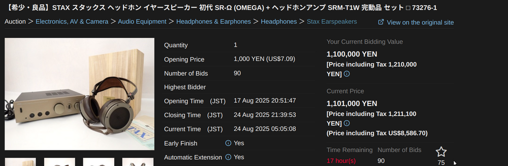

Oneguy Posted August 23 Report Posted August 23 I like the Omega but, as with all rare items, it depends on how bad you want it. Also, have to factor in import fees depending on where you’re at along with running the risk that it could arrive and have an issue. Will you be outside the window to return (if there even is one)? 1 Quote
Omega_ELS Posted August 23 Report Posted August 23 +1 007s user here also if anyone knows where to buy something similar - please let me know somehting like this 1 Quote
