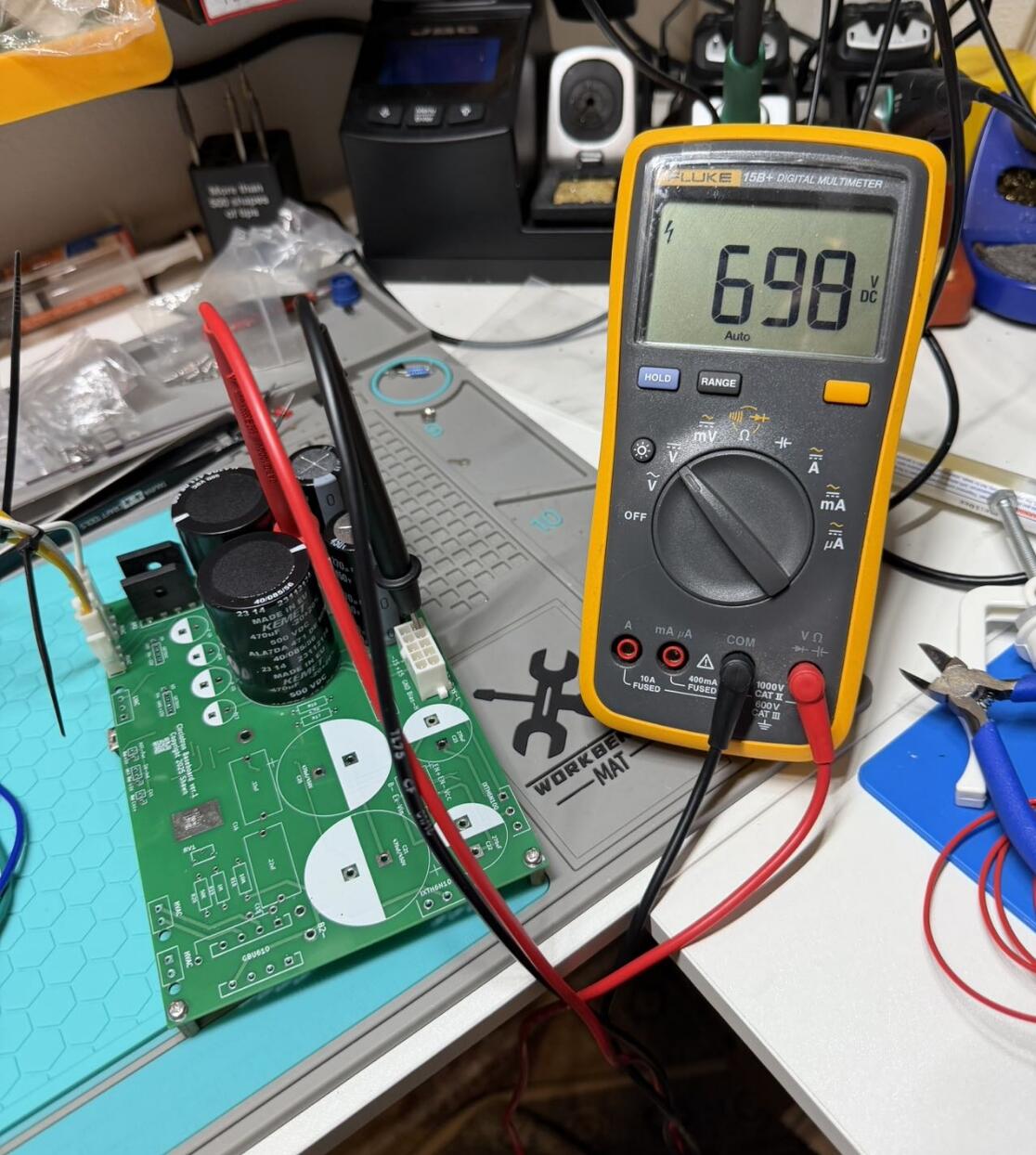

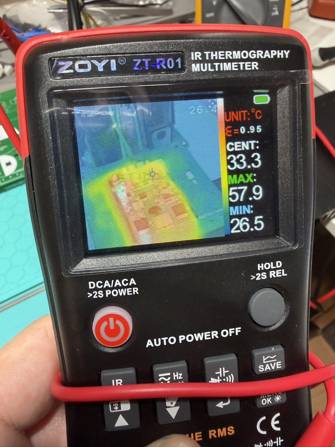

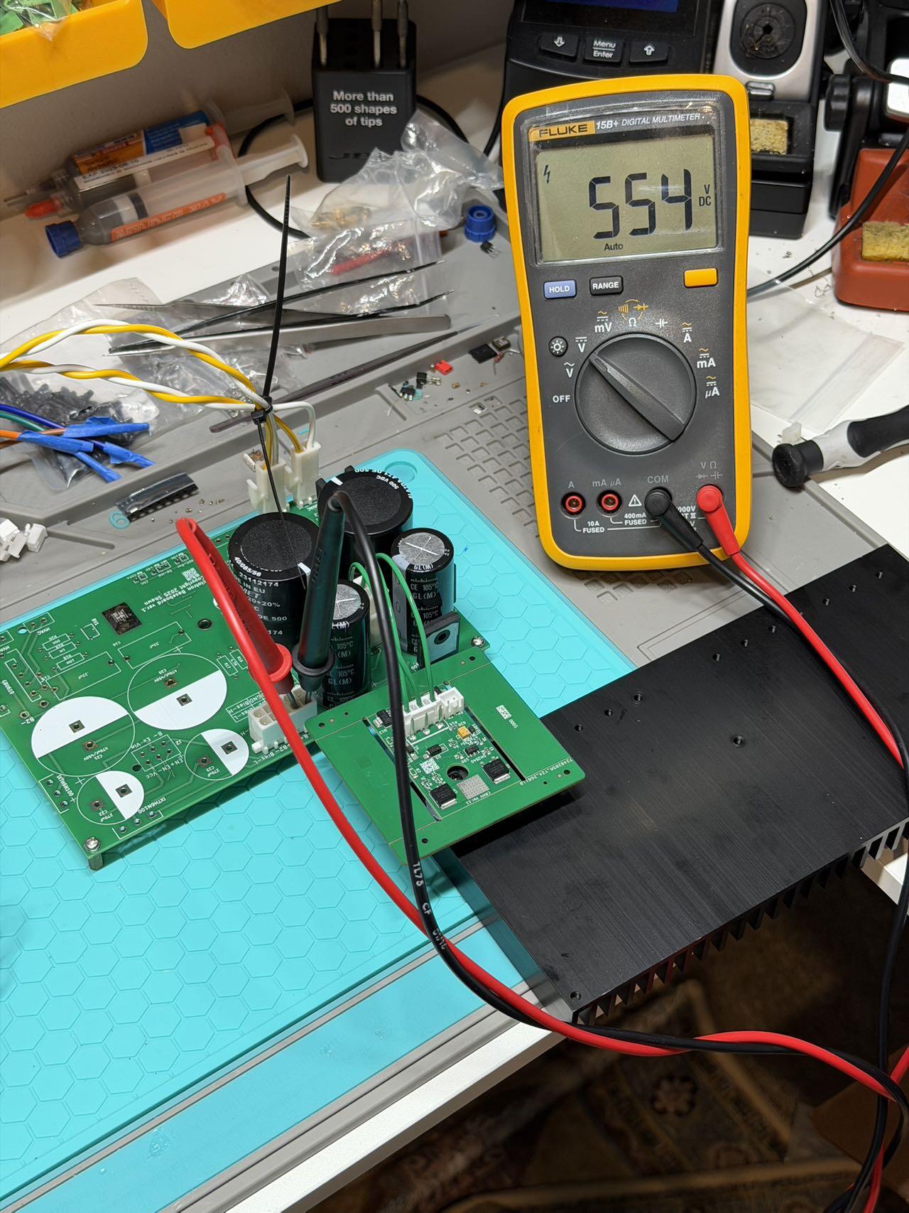

OK. Did a first power-up test for CRHV today. With 360k set for 550 V, I’m measuring about 554 V in practice. I only let it run for ~10 minutes. A quick IR check shows the CRHV peak temperature at ~58 °C. I suspect running it from dual 250 VAC inputs targeting ~600 V output may result in slightly better thermal behavior. At the moment, only the high-voltage section is populated. The delay soft-start and ±15 V sections are not installed yet, but they should function as expected once added.
