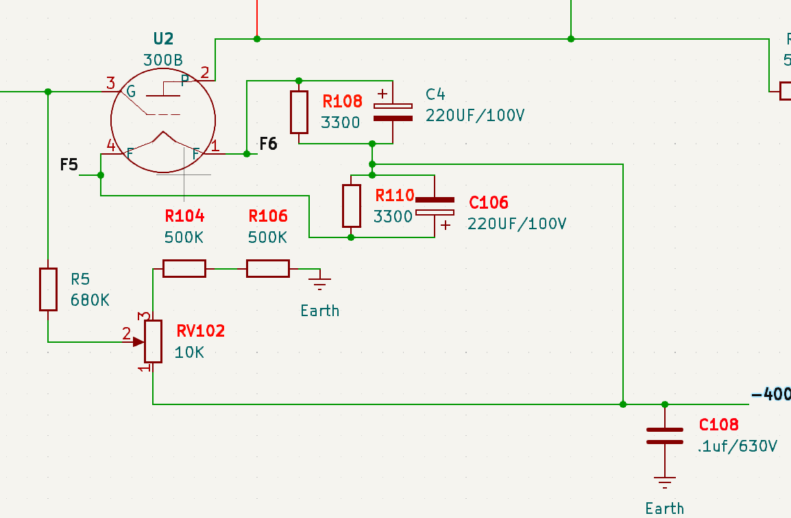

The grid’s pull-up resistor is R5 (680 K), and the pull-down side is two 500 K resistors. The 10 K trimmer (pot) has a very small effect, just about 1–2 V of offset adjustment range. With the current 7500 Ω cathode resistors, Vgk is roughly –76 V. To reach the WE datasheet’s recommended value, the cathode resistance would need to increase further, but that would push the offset even farther out of range. So the grid trimmer really needs to have more authority. The 10 K value is clearly too small here; something like 50 K or even 100 K would likely be a better choice. I’ve noticed that at this: 75 V operating point, there’s slight low-frequency distortion at high volume. I’m not sure if that’s because Vgk is too negative (too “deep”) or not negative enough. Yep, it’s a real hassle. At the very least, having to remove and reinstall the PCB every time is incredibly annoying.

so more than a few people are getting clobbered with 300b that don't even come close to the original published western electric document. of the 7 different varieties i have, only the original 1960's manufactured western electric comes even close to the spec. and the new western electric tubes come in low vgk and high vgk versions. (The B series tubes) just means you have to mess with the resistors. and yep its a major pain in the ass. the el34 original version pretty much worked +/- a few volts no matter what tube you stuffed in there as long as they all from the same manufacturer. or build a megatronxxl now known as optimus-prime. more money, but less of a balance problem. -

How much offset can you trim away with the trimmers? I guess one need about 15K to get rid of +10V offset (with 2 x 500K resistors in the voltage divider). -
Today the 7.5 kΩ resistors I ordered arrived. To swap all eight cathode resistors I pretty much had to remove every screw on the chassis. Long story short, the offset is much improved, going from –100 V to about +10 V. Big thanks to @JoaMat for the help! For me, this voltage is acceptable, but if someone wants to get even closer to 0 V offset, I think 7.0 kΩ might be the sweet spot. Also worth mentioning: the G-grid adjustable pot on the board offers around 2–4 V of Vgk trimming range. My 300Bs are running at ±400 V, since I feel 450 V is pushing things a bit too much. I think the main reason(Correct me if I'm wrong) for the original –100 V offset was that the cathode resistance was too low, allowing too much current. This made the anode current too high, and because the EL34 CCS isn’t perfect, it compensates by lowering its voltage output. With the original 3300 Ω resistors, I saw the B+ drop from 400 V to 370 V under load. One more note: after increasing the cathode resistor, Vgk sits around –80 V. For safety, I’d recommend replacing the original 220 uF/100V cathode bypass caps with 160V rated ones. More pictures will be posted later.
