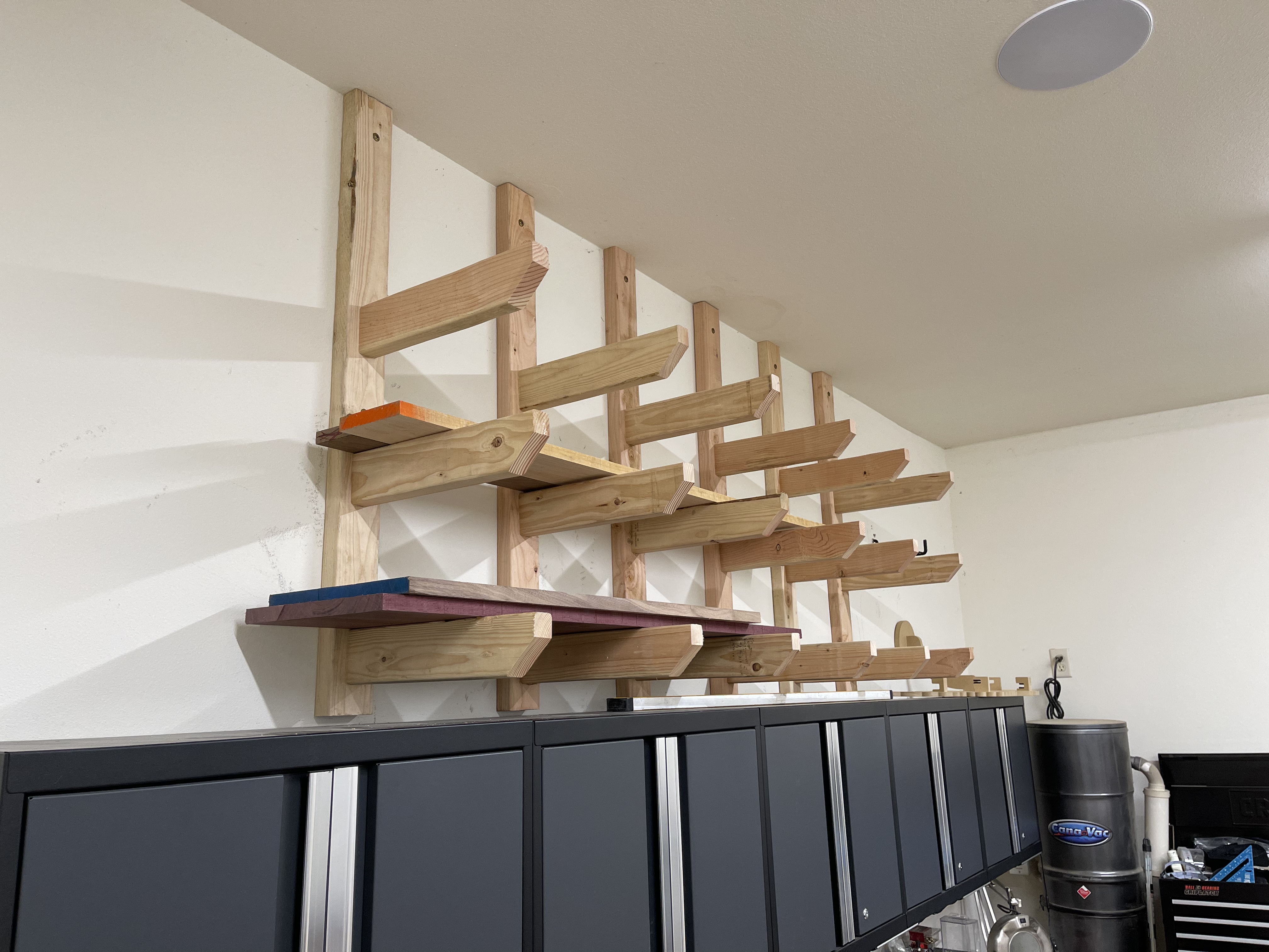

  • Just put up some shelves and cabinets in the shop space preparing for making things again!

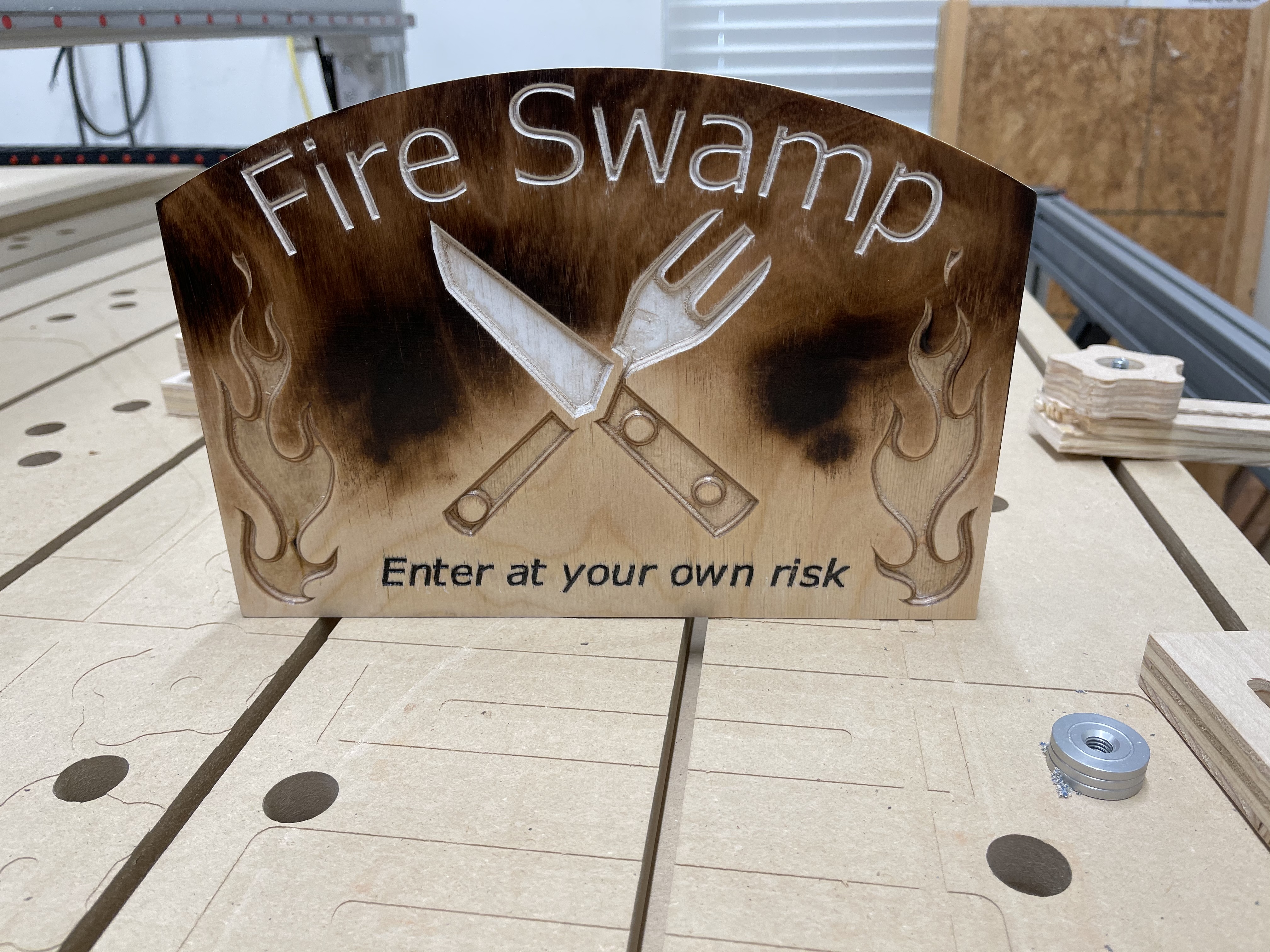

Thanks. So much to learn, so little time. No intentions of become a sign maker but it’s a little fun.
13 hours ago, naamanf said:
Gag sign for a friend whose wife caught herself on fire while cooking.  Learn something every time. Should have used a bolder font.
Tip for the future, in case this isn't what you did to fix it, but if you're v-carving and finding that you aren't getting a "bold" enough result a quick attempt at a fix is to simply cheat Z zero down a bit (experiment, it's easy to go too deep in a hurry) and then rerun that section of the program.  I've found it works acceptably well without butchering the tapered sections.  One other option is to rerun the program with a 90d V as opposed to a 60d, but that only works if your first effort was with a 60d bit.

Exactly what I did basically. Set the start depth at .0015. All done with a 90.

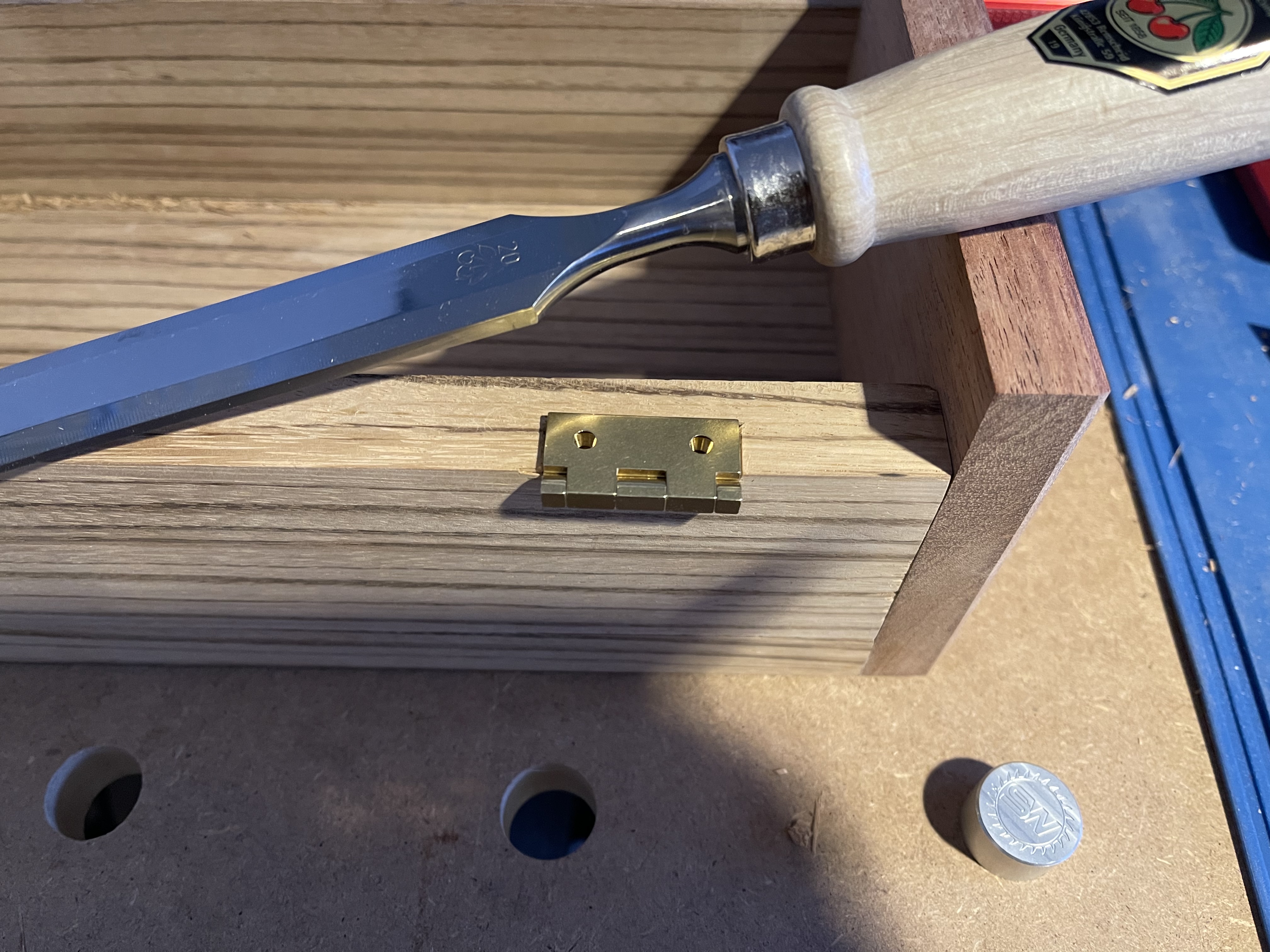

Spent way too much time trying to chisel out a space for the hinges for the box but now that it is done, I think they look too small.
Using the router and cleaning the edges with the chisel would be the faster method. White side even makes a corner chisel. Looks good to me though.
I’m also no expert, but I think you might be using the wrong chisel.
Edited by naamanf
They make some chisel with arms to make it easier but all the YouTube guys used what appeared to be regular chisels. You just make a whole bunch of slits and then come in from the side and clear them all out.
Yes, that’s the one with the arms, but Rockler was out of stock.

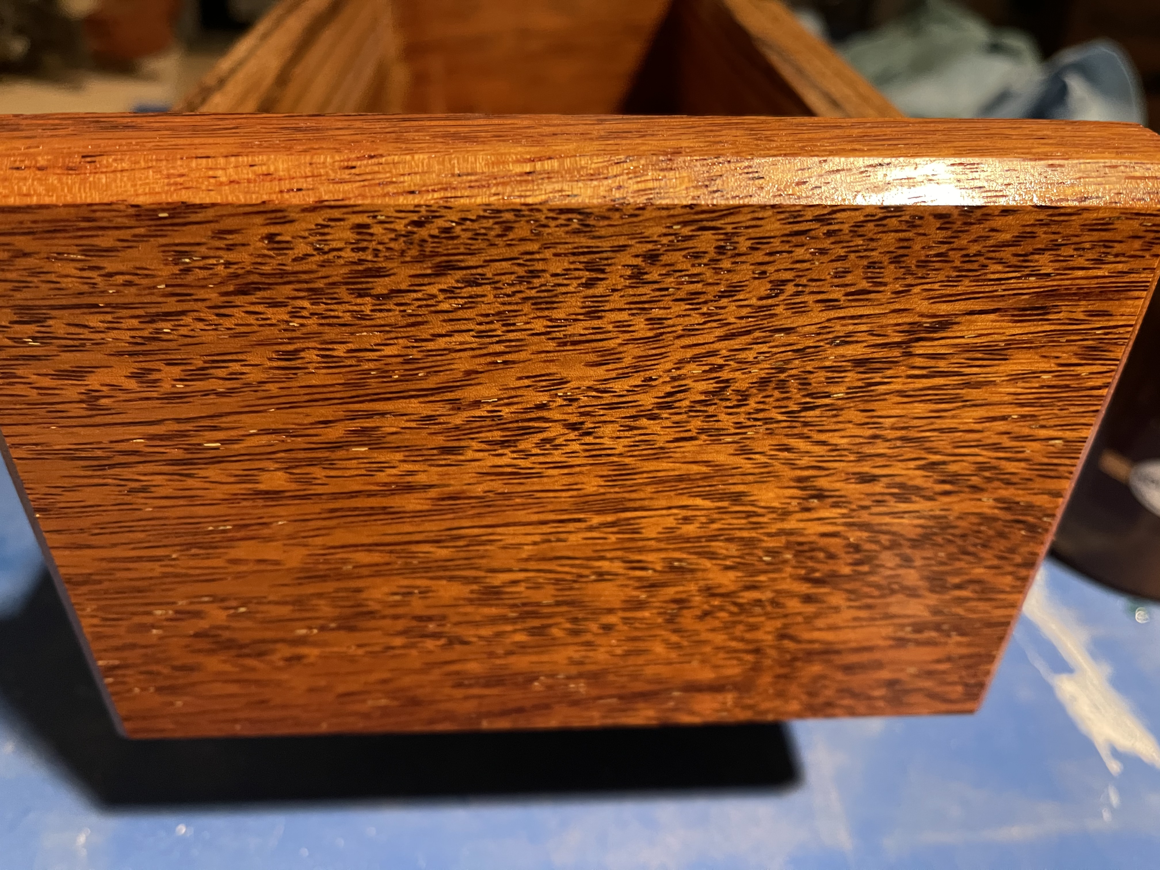

I have found that Boiled Linseed Oil hates residual wood glue and I am going to need to do some serious sanding before the next round.
Really digging how the BLO does with the Mahogany.

Looks great!
I find card scrapers more effective for removing glue residue that sandpaper. Or chisels.

Yep. I meant to grab one of those when I was out.
I think those hinges look just right. I wouldn't go bigger. Looks great.

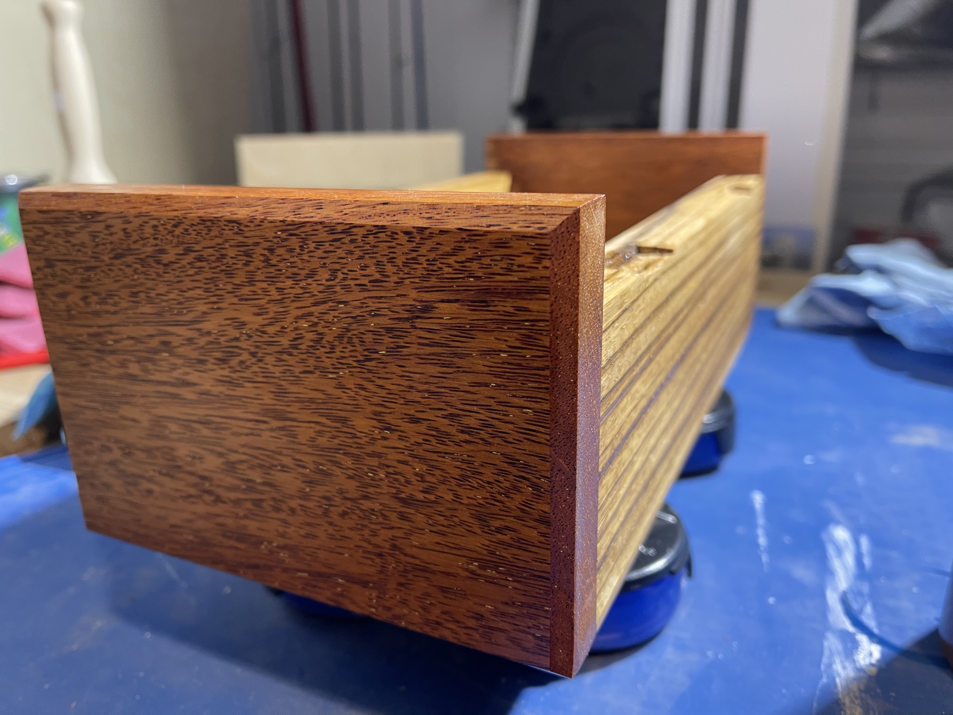

Have you figured out why they call it Zebrawood?
Because it smells like a herd of Zebras pissed on it when you cut it.

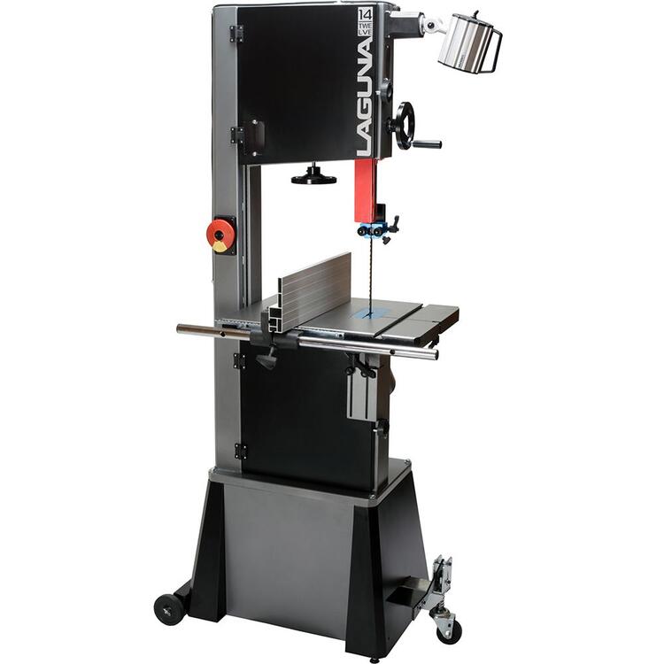

It appears the only model of Laguna bandsaw available before the middle of the year is the little 14/Twelve or whatever.  Might actually be better as it is fairly small, but does not have some of the fancy brakes and stuff of the slightly more expensive models that are on long back order.
Not necessarily.  I have two 12” sticks that I wanted to split in two to make a pair of 24” side tables and I have some crooked line shit I want to do.
My main thought is that the cheap Laguna is probably more than I need so there is no reason to wait months for something with an additional option or two.
