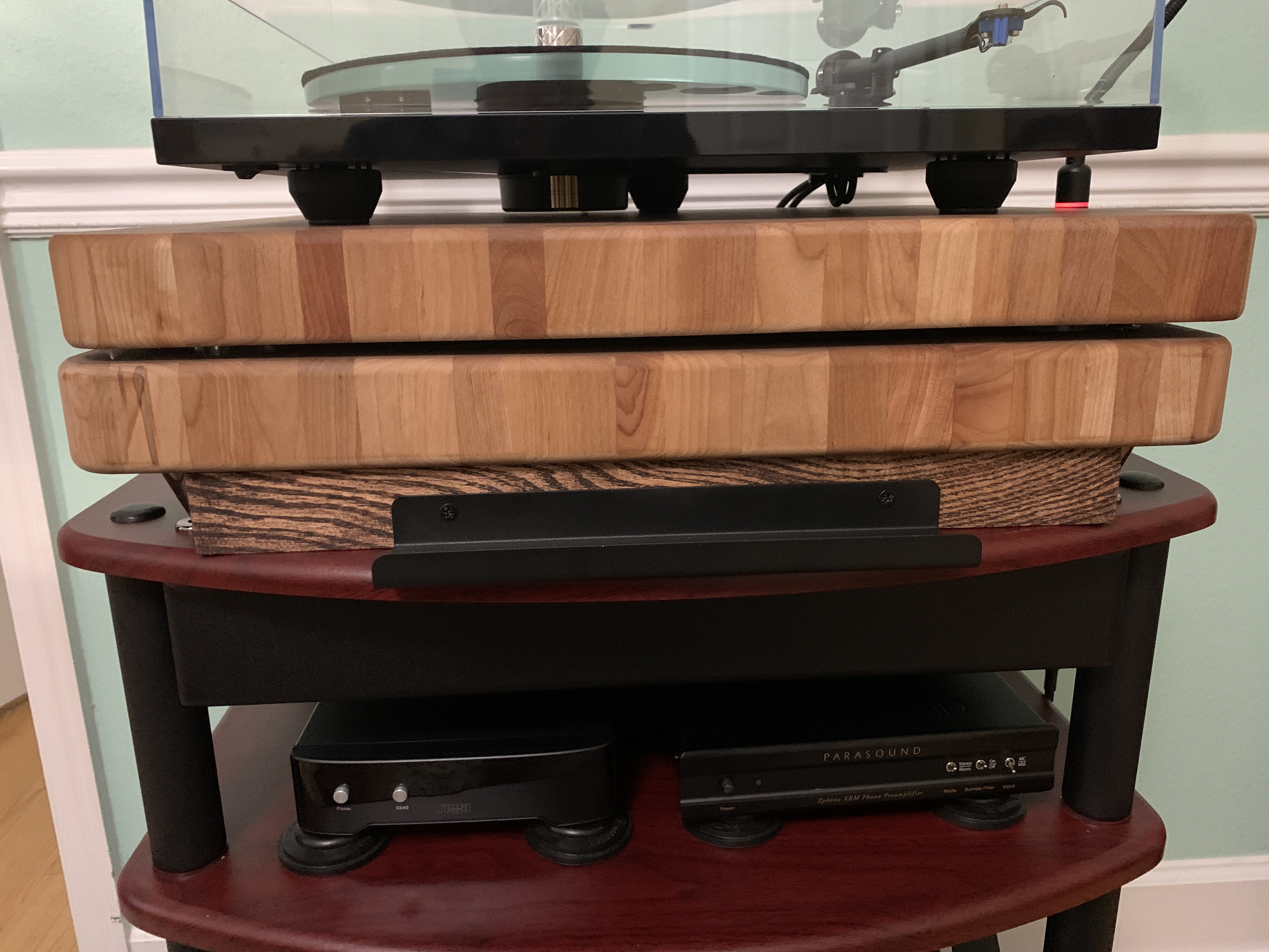

  • The Cherry is lighter than the speakers, but will darken quickly next to the window. I have a vented front plate coming for the top space. The cooling fan sits in that space, and is really quiet.

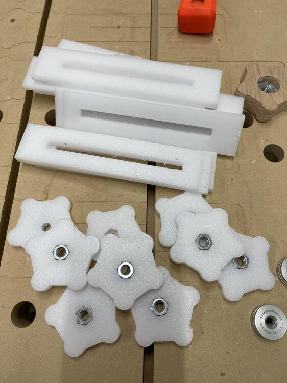

Needed some lower profile hold downs. First time cutting plastic, worked great, except the plastic is to flexible to work well for hold downs. Time to see what Amazon has.
7 minutes ago, dsavitsk said:
Have you tried double sided tape?
Okay for small parts, but really not feasible for doing larger panels or sheets.
3 minutes ago, dsavitsk said:
How about phenolic sheets?
I was going to order that or delrin.
Good idea!
Delrin is quite soft and bendy
I use HDPE for that stuff. I’ve always had problems working with delrin. It melts as you cut it.
Delrin definitely lasers better. Danger is that it burns with an invisible flame, so if it catches you don't know until it's gone.
Blank pcb material is another option

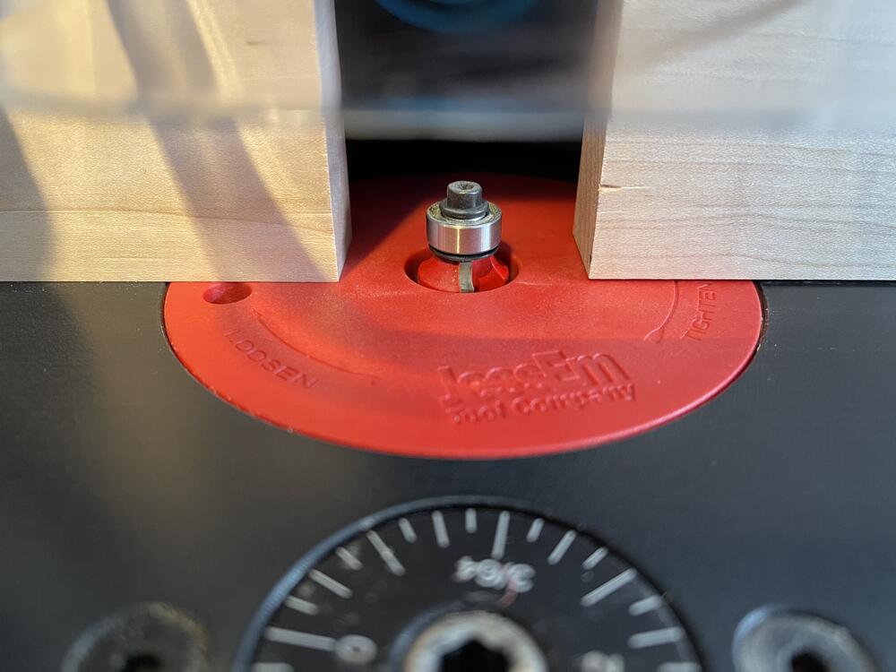

Set up the Murder Machine with its tiniest bit for an almost imperceptible to the eye round over for the sled tops.
