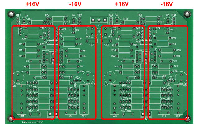

This is a screenshot of the duals portion of the board. Reorienting them into back to back (quad?) would not be easy...

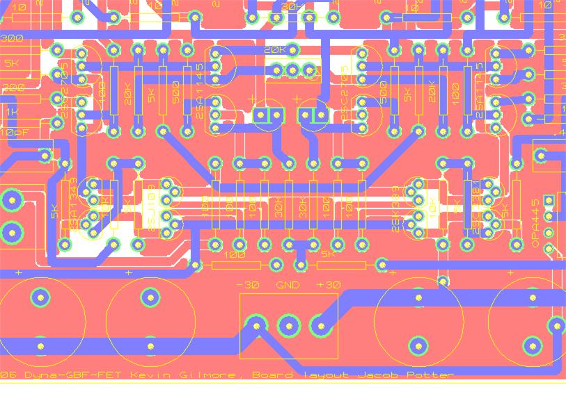

Just to contrast, this is the group buy Dynalo board that does allow zip sockets (U1-U4). Pads are still too small in general however.

I don't really care who uses it... the point is they are too small and there is no valid reason for doing them this way, other than the default libraries of whatever layout package being used have them this way :indra:
I'd volunteer to do the layout but I only have the free copy of Eagle and it won't do a large enough board for this.
I errrmmm, may have access to a copy of Eagle that you could, ermmm, like use and such.
Break the mold and use diptrace. Everyone's doing it. Sensible defaults to boot!

Does the Freeware version have a board size limit, or just the 250 pins?
Freeware Eagle will only do a 100x80mm board (~4"x3.2"). I need something that runs on a Mac also, ruling diptrace out (I believe??).

If Kevin is willing to share the board files we may be able to import them and save a bit of time making new boards from scratch.
