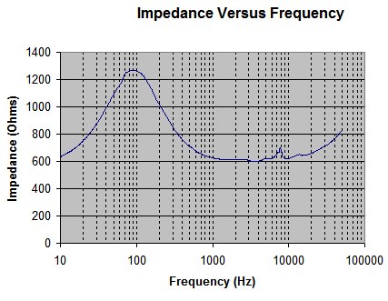

Is there any measurement data to show if the T1's have a significant variance from their nominally-rated impedance across the FR range?
Yes but the impedance curve seems to be outside of the Headroom graph.:rofl:
Gotta get some files from another computer ..... Augie.gif .... here you go:
http://putts.smugmug.com/HeadRoom/On-Line-Content/t1-impedance/805803381_RNtX3-O.jpg[ATTACH=CONFIG]2785[/ATTACH]
Yeah, I've asked about that before; I can't make it hit the priority list high enough though. C'est la vie.
Gotta get some files from another computer .....here you go
Thanks, T. It appears from that graph that it never drops below 600-ohms.
Doesn't that indicate the amp's output impedance would have even less of an effect?
Interesting...the sharp peak in the impedance graph at ~8kHz matches up with a similar peak in the frequency response graph at about the same frequency. I'd suspect this is a resonance of some sort though I'd need to see a cumulative spectral decay plot to be certain.
Yupper. That article I pointed to makes that point. It is more complicated though, because it's really the phase angle (amount that voltage leads or lags current) that makes the headphone a difficult load to drive. Simple sine wave sweeps is one thing, but instantaneous changes in random signals relative to the current nature of the signal can set up very complex relationships that deliver a whole different set of problems. It's why a lot of analysis is done with impulse responses, MLS sequences, and transient measurements. It is friggen complicated; I don't really know shit about it, but I read quite a bit lately. The funny thing is you'll still get camps of differing opinion publishing AES papers. Who the fuck knows WTF to believe sometimes.
From what I've been reading today, the first hump (around 100Hz) is the mechanical resonance of the driver --- the pendulum effect, so to speak, of the diaphragm. It's mildly inductive before the peak, at the peak it's purely resistive, and then is capacitive after the peak. Tradition says that the characteristic impedance of the cans is the floor after the first peak, so the T1 indeed shows 600 Ohms. Then gently rising slope starting at 1 kHz is the ever increasing electrical inductance of the voice coil itself.
My guess is the little glitch you see around 8kHz has to do with acoustic frequency shaping. I'm coming to the conclusion that you want a low response between 1-2kHz to keep things from sounding harsh, and then you want a bump somewhere between 5-8kHz to bring out air and imaging. But that's kind of a guess on my part; none the less the glitch is either an acoustic tweak, or some kind of mechanical resonance in the headphone.
