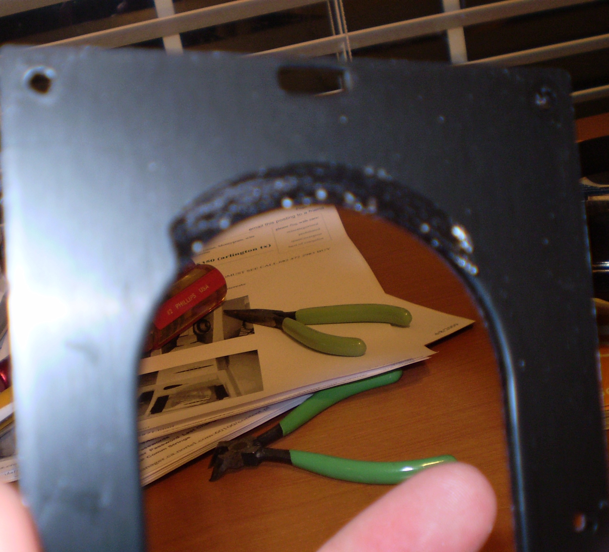

Boy, some DIY guy I am. But I got one housing open on the 202's.
Same two sided sticky tape. You can see some of it on the inside mounting plate. I hope the rest of the assembly is glued. The inside
charged pieces look glued, but I cant tell if the screen that faces the plate is glued or sticky taped to the driver assembly. I'll wait for daylight
to look. Do I need to wipe off everything and white glove it on re-assembly?

All the Stax phones have the drivers mounted with double sided tape. I'm going to try and find some time today to open up the drivers and start the glue process (takes 24 hours).
To reassemble you can use the old adhesive but I would use some new one. The old one should be easy enough to scrape off with your fingers.
