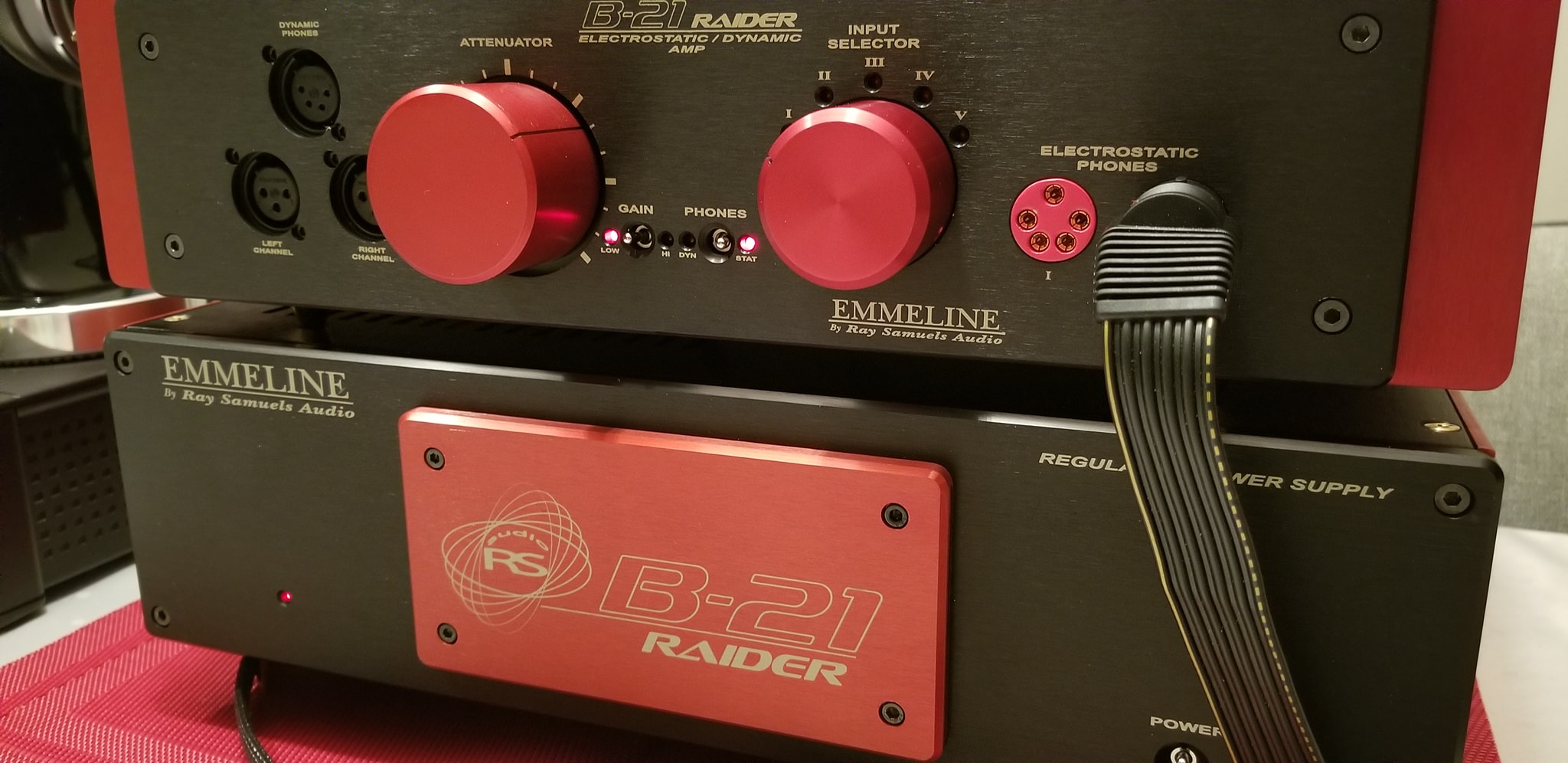

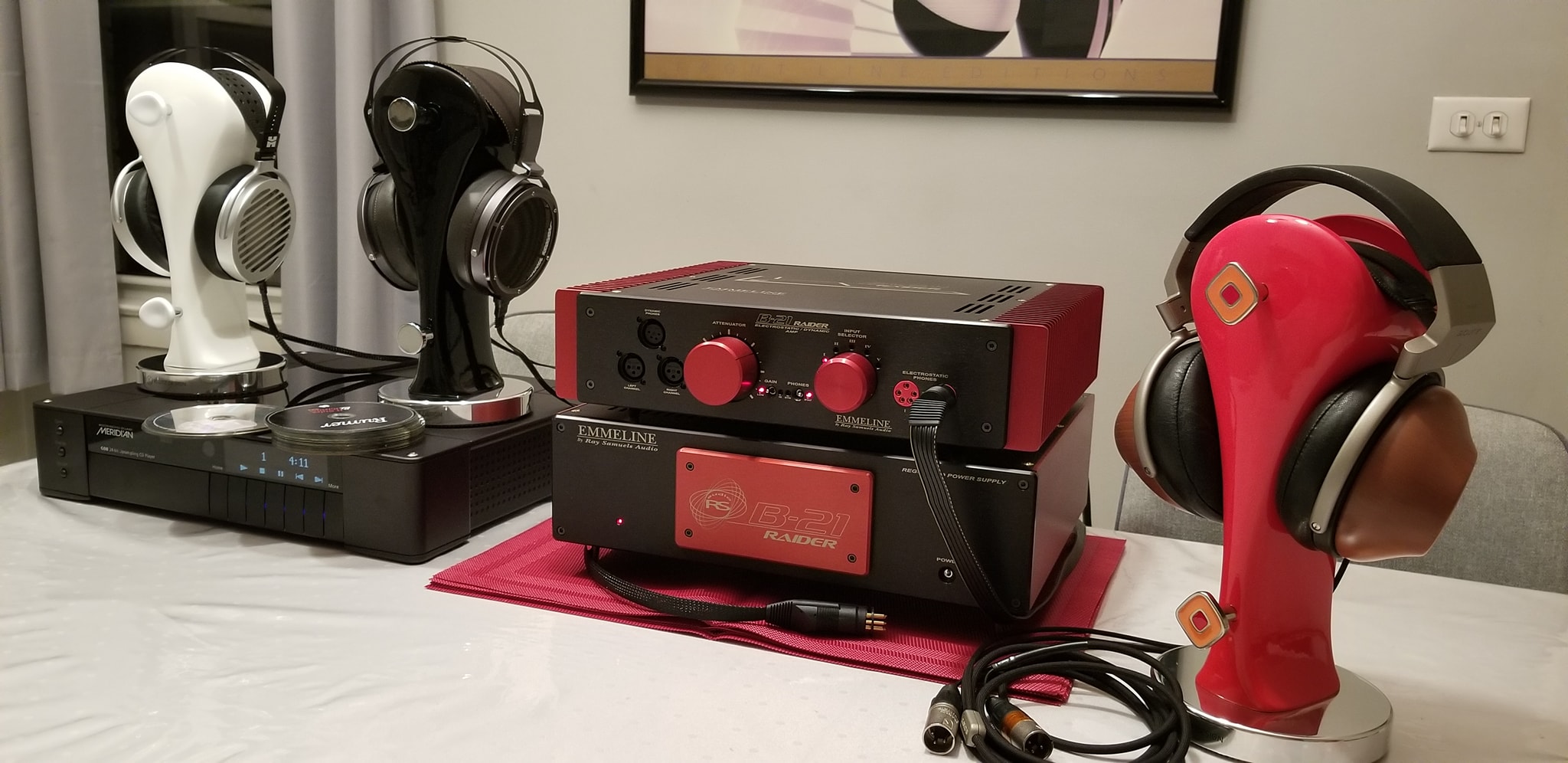

::)Ray samuels the old friend of stax mafia just released a new amplifier B-21, the electrostatic part claimed 1800Vpp voltage swing with 200mA continuous current output performance just shocked me. . . Reminds me of the horribly weak output performance of the A10 he designed before, this new amp is also questionable...
Holy fuck that thing is ugly and yeah... color me skeptical ;) of those numbers.  1800Vpp would point to either +/-450V or +/-500V rails (given the regular losses) so either 900V or 1000V at 200mA.  That's 180-200W, per channel and those heatsinks are not big enough for even a tenth of that.
I also love that Ray dug out a 20 year old CD player (which I'm shocked still works as I had one of those)...
so a darkstar driving transformers.
yep great idea.
no toobs :(
where else have we seen a red knob.
on the brighter side its probably better made than the viva. and cheaper.
possible spoiler:  transformers made by audiostatic, holland.
spoiler is incorrect :D
and ray clearly does not understand how current works.
