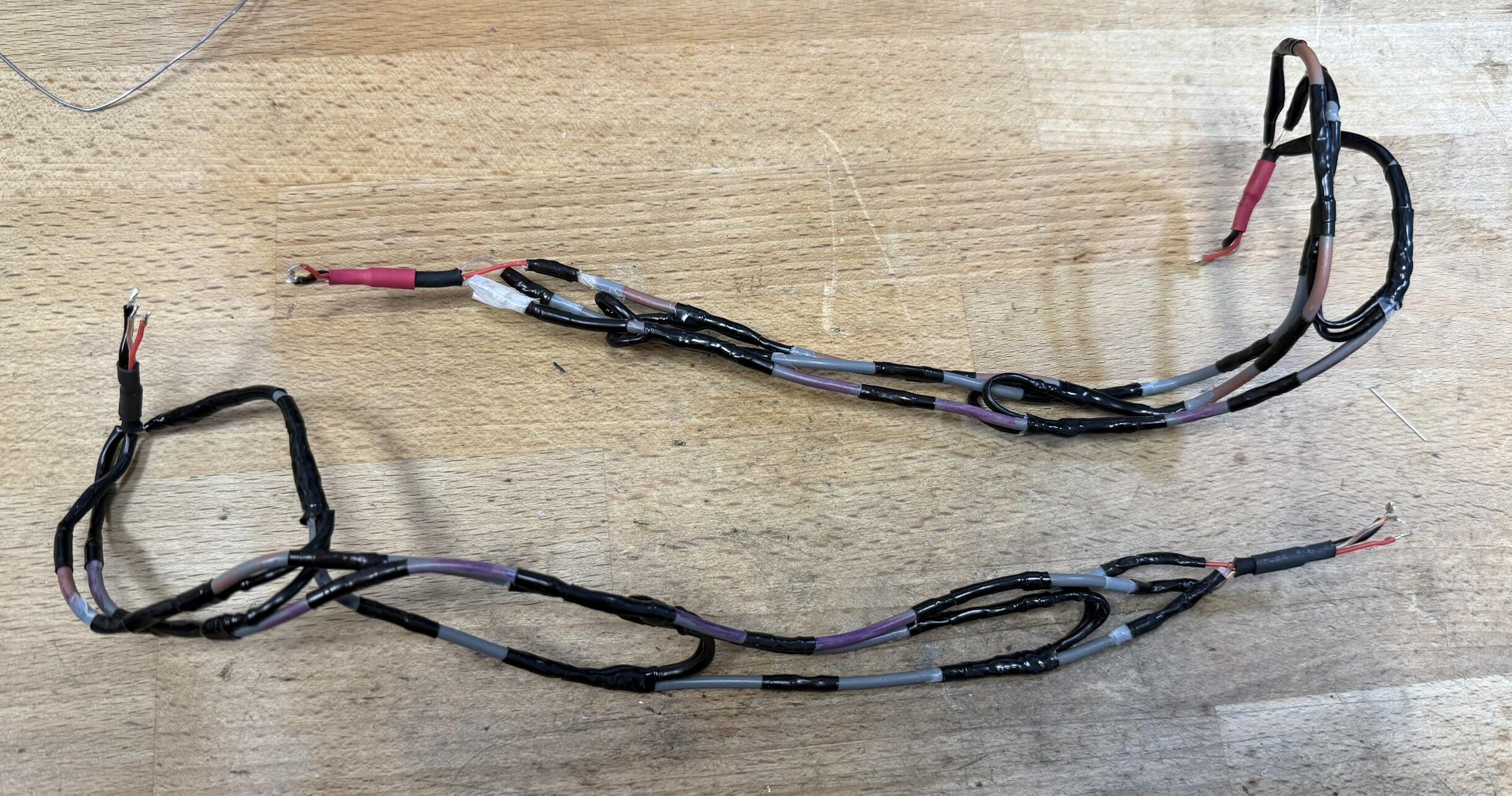

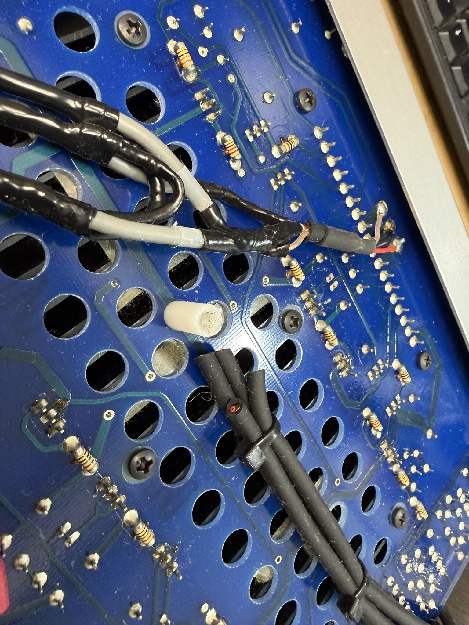

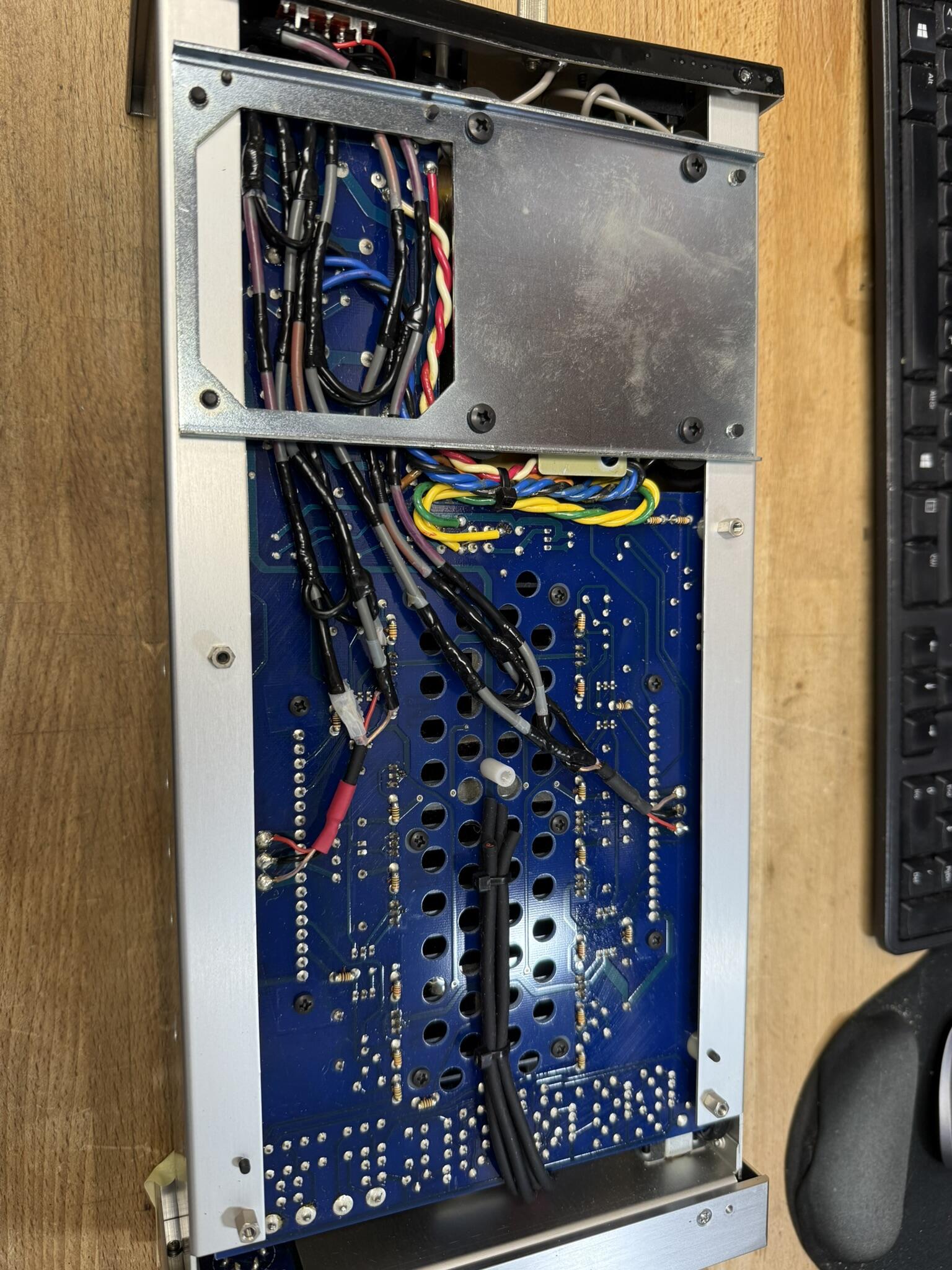

This has to be the week of stupid mods, cue this 727 in for full surgery and mods. Nothing abnormal on top but below I find this: Hmmm not quite stock that input wiring In and output wires from the volume pot were simply cut and this new monstrosity was sliced into ends. The plan was clearly to bypass the volume control but this is a 727... which has a switch to turn off the volume control and bypass it!! Just flip the switch the volume control does nothing... fucking hell... One more thing, can anybody make heads or tales of this monstrosity? That's two three conductor cables, basic mic cable would do the job but why set it up like this? Each conductor is screened and they are bridging it ever 10cm or so for moar cancellation? Ground for your ground... for your ground? Also, I'm not truly prepared for the 727 to be almost 20 years old at this point. The caps in this one had a date code from early 2007.
There's an awful lot of solder on your SMD parts.
