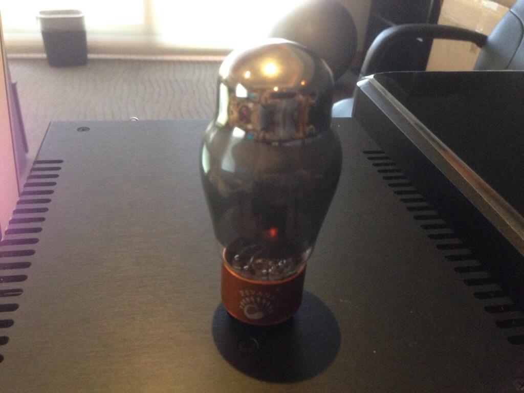

cutestory Posted October 28, 2013 Report Share Posted October 28, 2013 Update:The Psvane tube I bought looks like it has some kind of shielding internally:It's smoky on the sides and silvery at the top. In any case, with this tube it's entirely noiseless now. 1 Quote Link to comment Share on other sites More sharing options...
shellylh Posted October 28, 2013 Report Share Posted October 28, 2013 Wait, so you hadn't tried the Psvane before or it was noisy and now it is quiet? Don't use the stock tube, it's teh sucks. Quote Link to comment Share on other sites More sharing options...
nikongod Posted October 28, 2013 Report Share Posted October 28, 2013 [Nitpicking start] "grey glass" tubes do not have more shielding than normal tubes. The grey stuff (graphite) was applied to the glass to improve performance in certain conditions. The MFR's all swore that they figured out a way to solve these problems without the grey glass after a certain point, but I think they just got lazy and cheap.[/nitpicking end] Happy you got it to run quietly. Some tubes are just noisy. Quote Link to comment Share on other sites More sharing options...

cutestory Posted November 5, 2013 Report Share Posted November 5, 2013 FWIW, a single one of these worked on the Sophia and the Tung-Sol tubes, making them nearly silent. This doesn't mean I'm using the Tung-Sol tube. I ain't. The Psvane and Treasure tubes are both silent without it (and it doesn't quite fit them anyway—the tubes are too wide at their widest point). The Ety ER-4S sounds pretty nice through the Peak. I can now listen open or closed at work and not disturb anyone! Ari thx for the nitpick—although even with a silent tube or with a shield/tube combo I hear the same noise if I plug in the JH16s (and not with the ER-4S or HD800). So in this case it's environment noise and not "tube noise"—although I guess maybe you were saying that the noisy tubes are the ones that pick up more RF interference. They don't seem to be generating any noise of their own... Quote Link to comment Share on other sites More sharing options...
