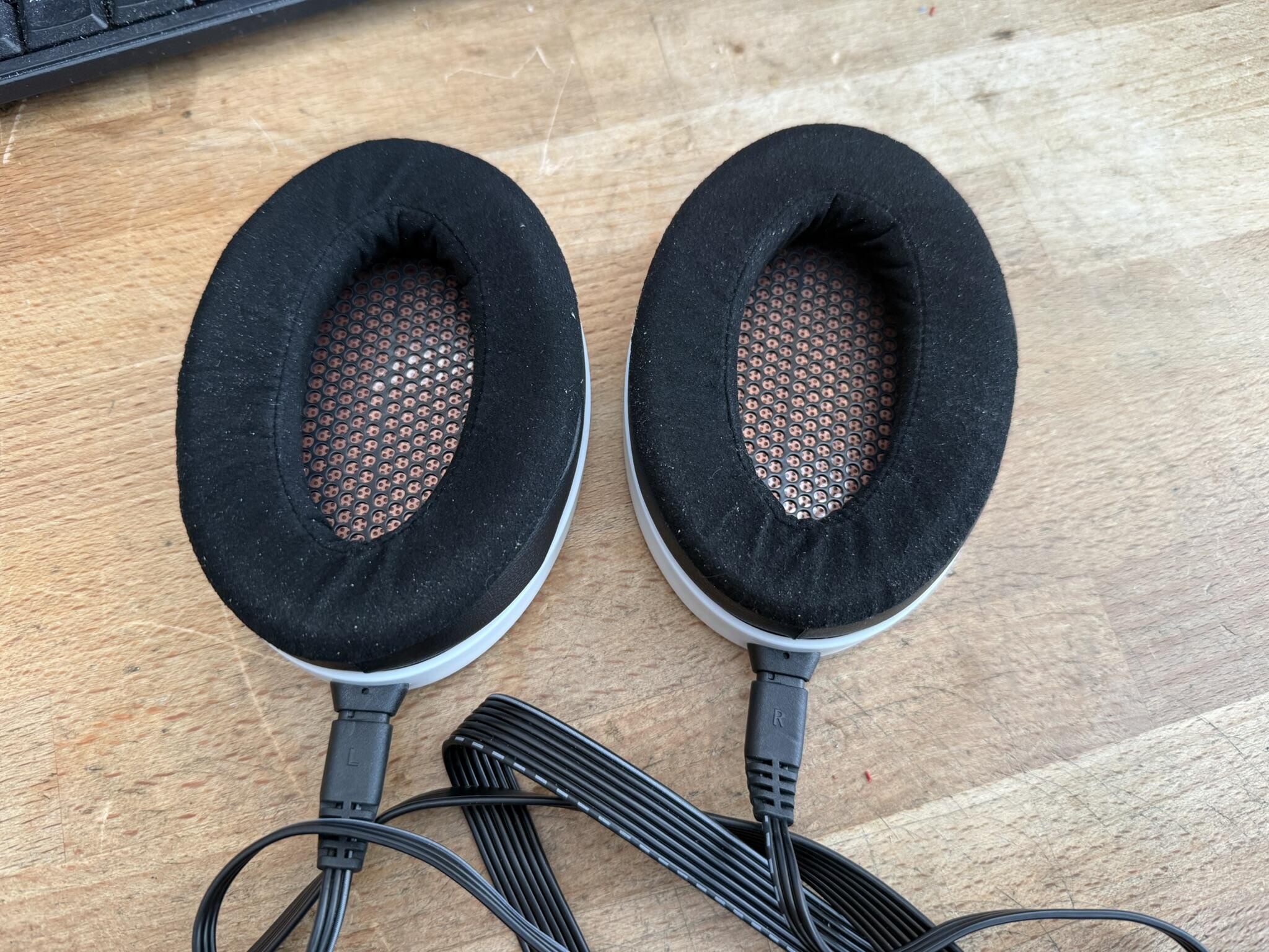

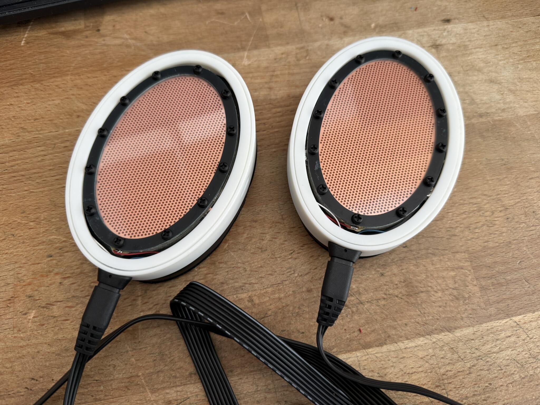

HE90 "clone" first prototypes up and running as of yesterday: The drivers are all PCB based with 2um mylar diaphragms. They are about 3mm lower in height than stock to accommodate the cable entry and move the connections to the bottom of the drivers. The housing is resin 3D printed but this is the old version which has now been abandoned for a new one that has yet to arrive. Cables are King Sound (as I had some in stock) and allow me to fit it all in the same housing size as the original. The earpads are ones for the T+A Solitaire that are not a great fit but dirt cheap... so work just fine for this role. I've ordered new genuine pads but I'm not sure if Senn have any in stock. Next up is to refine the headband design and start to work on prototyping the metal back shell. Now I just wait on parts as usual... As for the sound, far from finished, even in prototype form but a HE90 with actual bass response... perish the thought!! ;)
