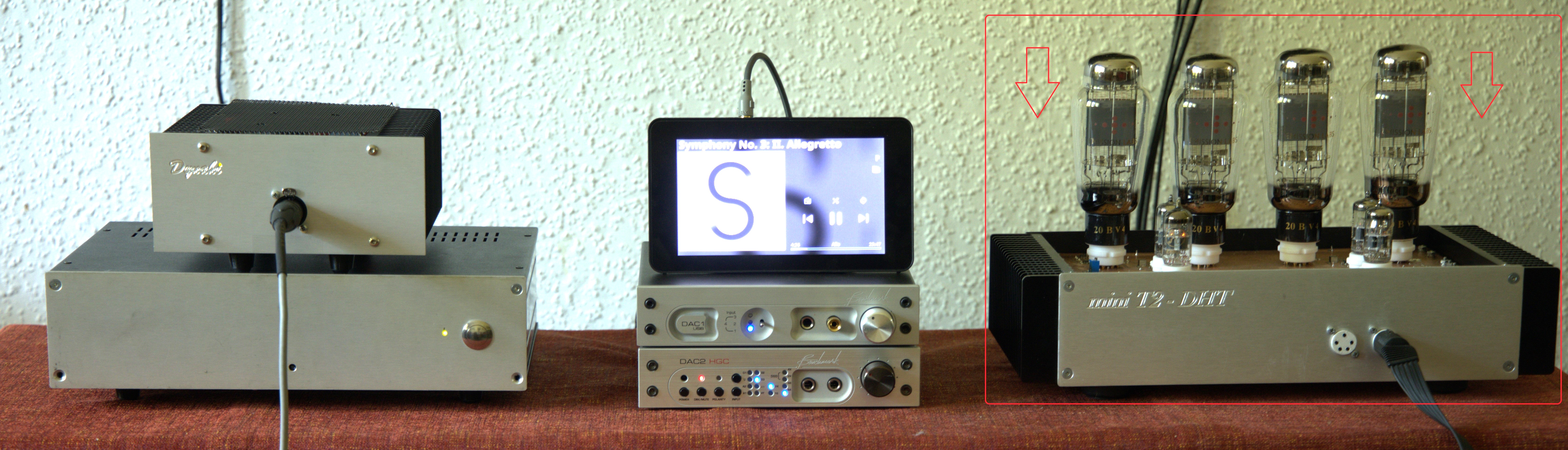

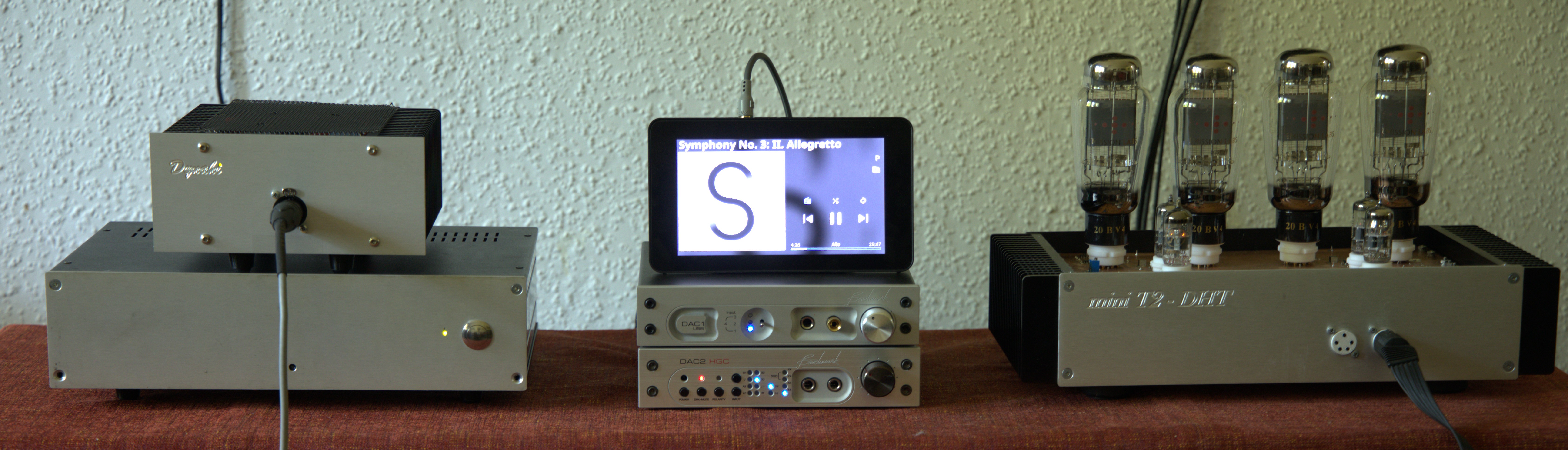

  5. DIY T2 amplifier with 300B tubes. Amplifier is built on Kevin’s board. Only modification is decreased high voltages, +/-400V instead of +/-500V. Homemade 300B to EL34 adapters connected to four Traco 5V switched PS for filament power. I only replaced the EL34 with 300B along with the filament power supply. No other adjustments. It works – I’m in no harry to change back to EL34.

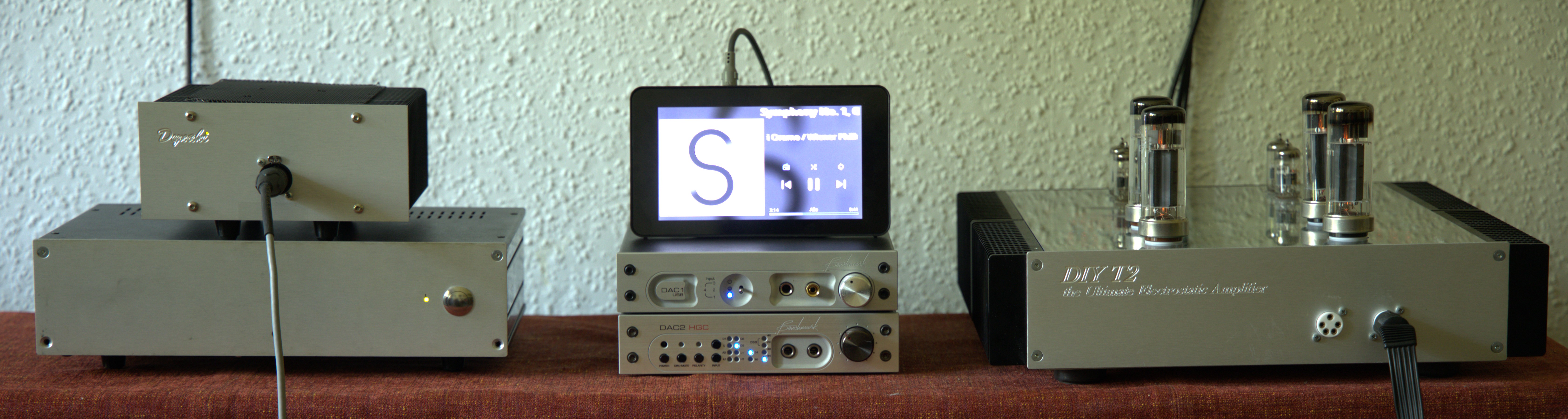

  10. Happy Easter folks! Three months ago I bought a pair of Russian 300B. Intention was to try them in an electrostatic amplifier. Eventually I’ve put them in my DHT mini T2. Only mono version but it works. There is some unwanted hum/noise. Maybe because 5VAC for filament. I’ve DC alternatives, so future will tell if that might solve the issue. Anyhow, I’m enjoying the music (only left ear) and I still have some good stuff left.

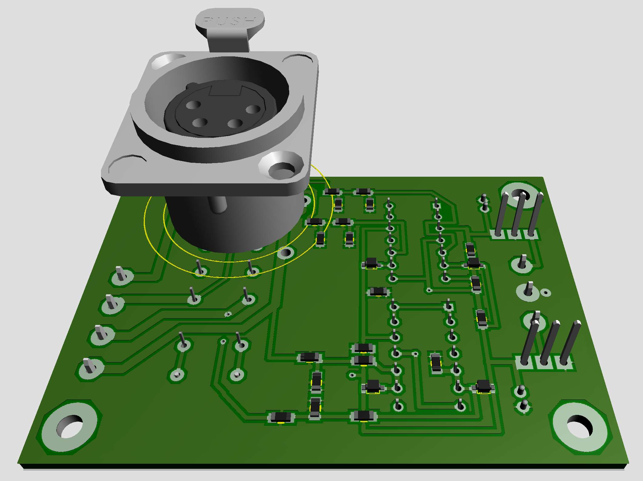

  20. Happy Birthday!

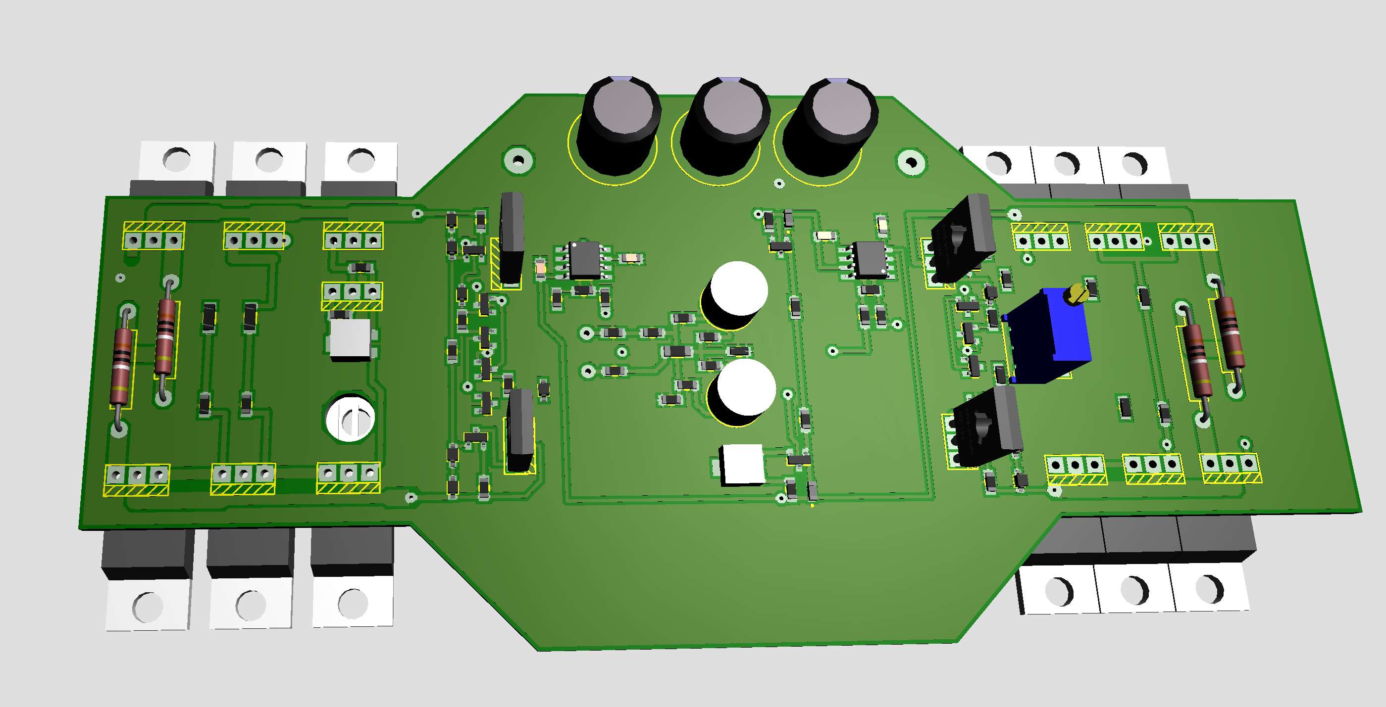

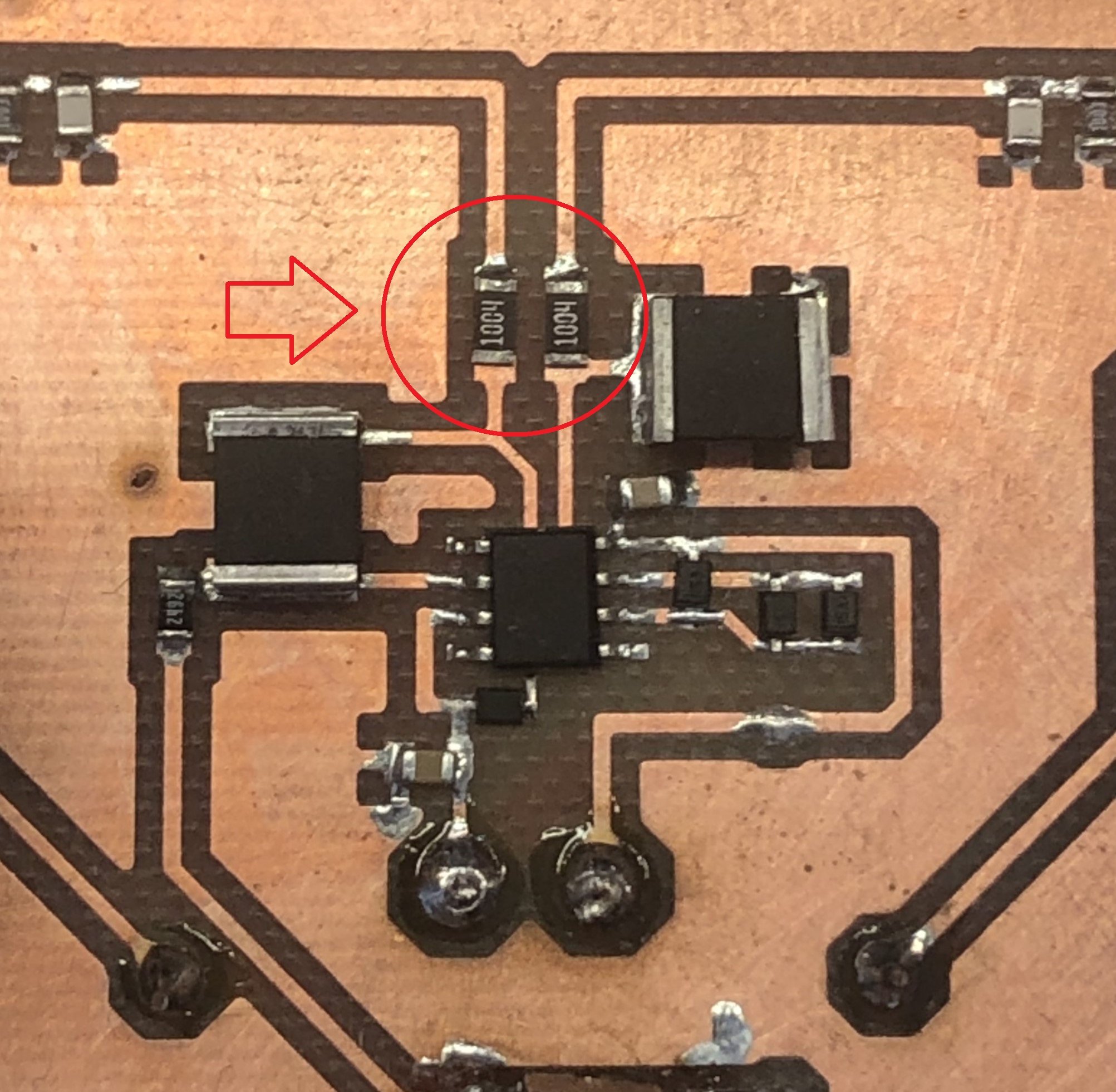

  23. Well, it’s almost 10 years ago I made the “original layouts”. Just found another version of a layout on my computer from that time. A part of it shows (in ugly yellow circle) a RES90 resistor with text "Resistor I=1,3mA". There is also room for three standing resistors instead of one power resistor.
