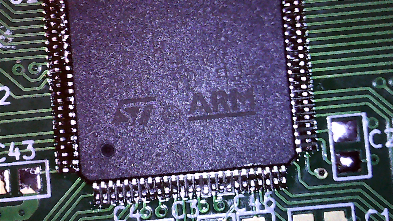

  25. Pars replied to Dusty Chalk's topic in Miscellaneous
    Wasn't sure where to put this. My son showed i to me and I thought it was funny:
