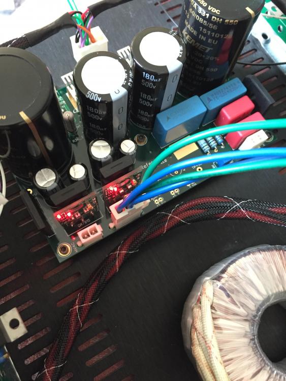

Got my spare parts GRLV PSU all finished up for the mini stax amps today. Wiring is a little ugly since I left the transformer leads long in case I ever want to repurpose the transformer again and left the other primary intact for 220V. Used an inline fuse because there wasn't really a good spot on the back panel that wouldn't look weird or collide with the board. The Kemet caps were nice and short enough for me to put in the case but since they're fat required adjusting some of the other bits before soldering to make sure they fit.
Had some decent little heatsinks on the pass transistors originally, but even though the amp only pulls about 300-400mA, they got way too hot too quick. The bottom plate worked fantastic though and once assembled, the whole chassis spreads heat to all parts pretty well. And I just noticed in the picture that I forgot to scrub all the flux off those when I remounted them. Well, better go fix that.
Hope you guys enjoy this particular combination of spare parts pile and overkill. Only cost me about $70 to put together with what I had laying around and half that was the case.

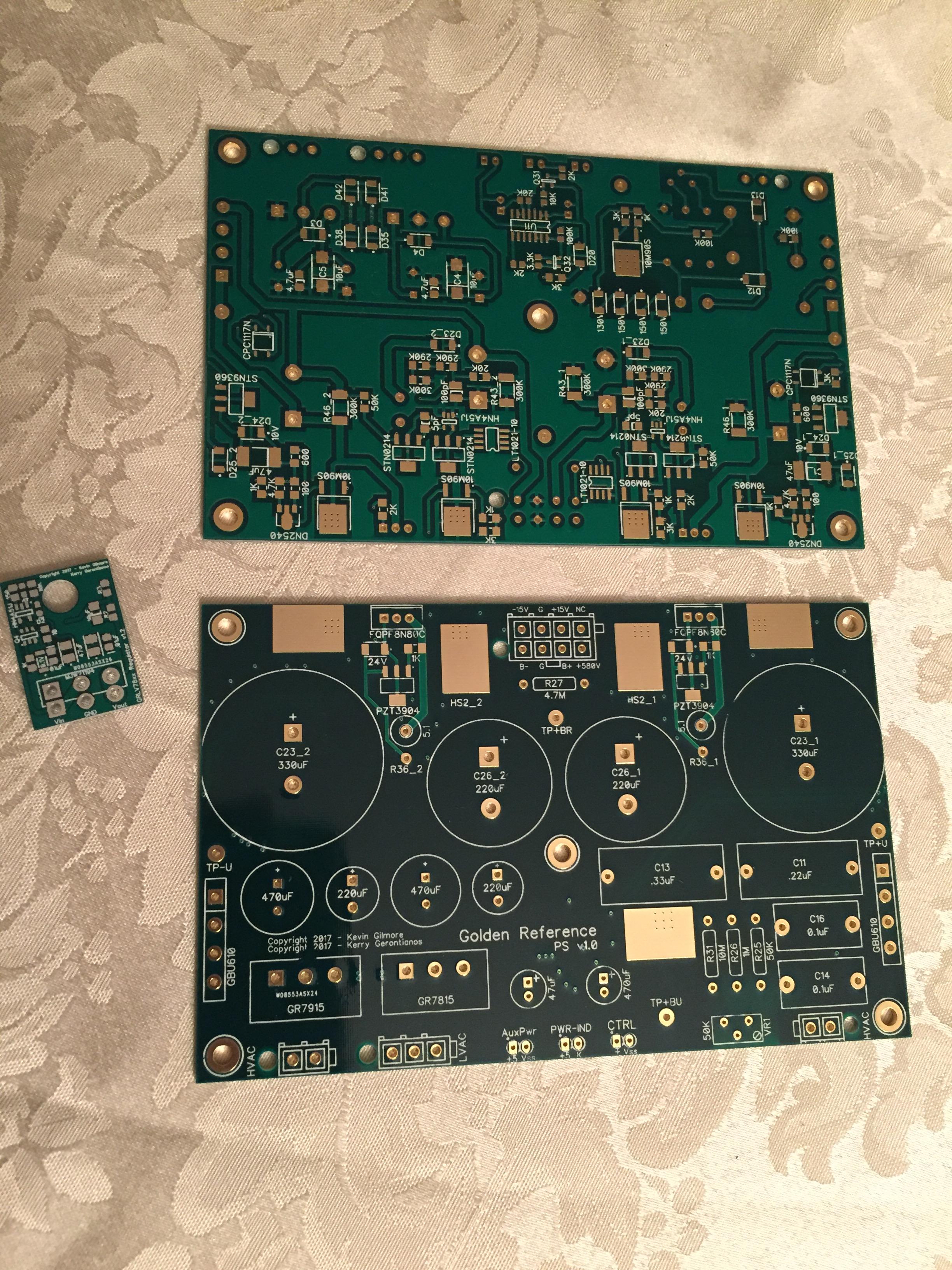

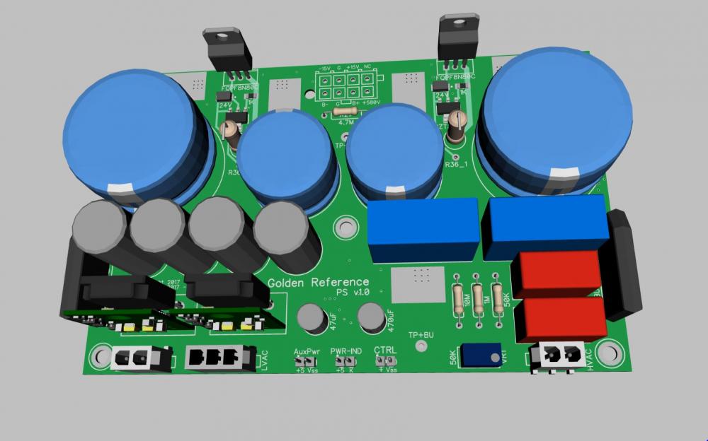

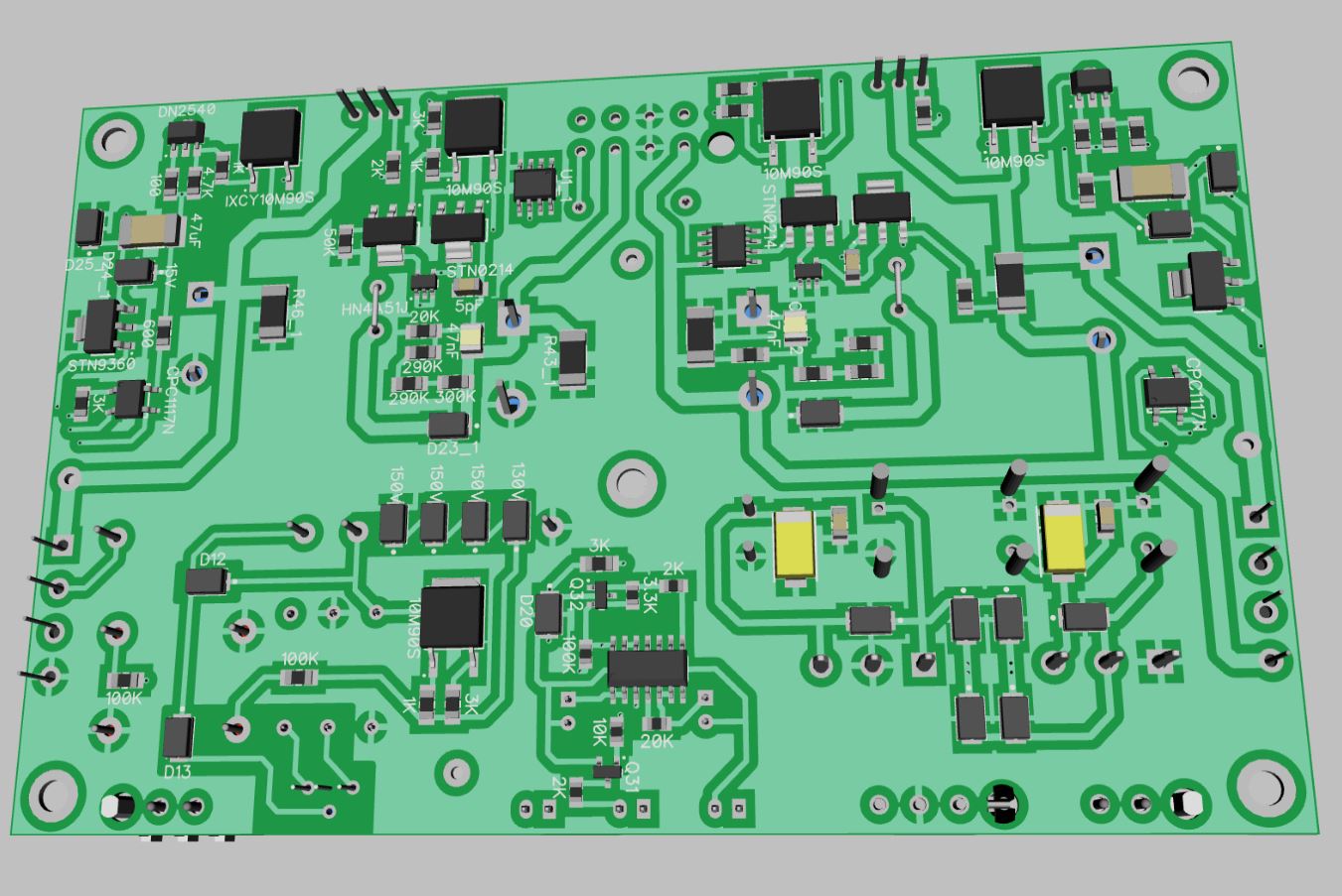

Here's a new layout I'm working on.  It's a GR HV/LV, Bias and Delay circuit (with LED flasher) all on one 4 layer board (3.5" x 5.5").  The pass devices can mount to the bottom plate or a heatsink.
Mostly SMD parts and uses the GR78/9xx modules.  Once tested I'll make this all available.
Got the boards back.  I should have this tested in the next week or two :)

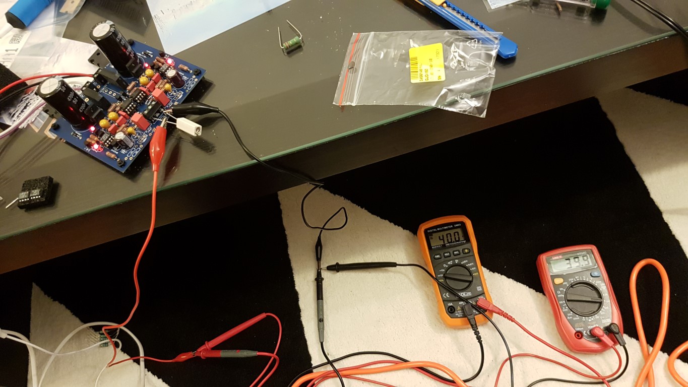

Fedex came trough today. Got my first GRLV up and running. I think / hope the left multimeter is more accurate will replace the right one soon. With the small load, I did not burn trough the Fuse but I burned trough the first one. Was thinking a little bit too small one the fuse side I guess XD

^ Looks good. Interesting measurement technique with load from V+ to V-.

Ah is there something I did wrong or is bad :unsure:
I also measured relative to ground as well.
That had occurred to me Kevin, thanks! I might go with that.
masamoto: no, nothing wrong with that. I usually am more interested in relative to ground to see the balance between +/- though.

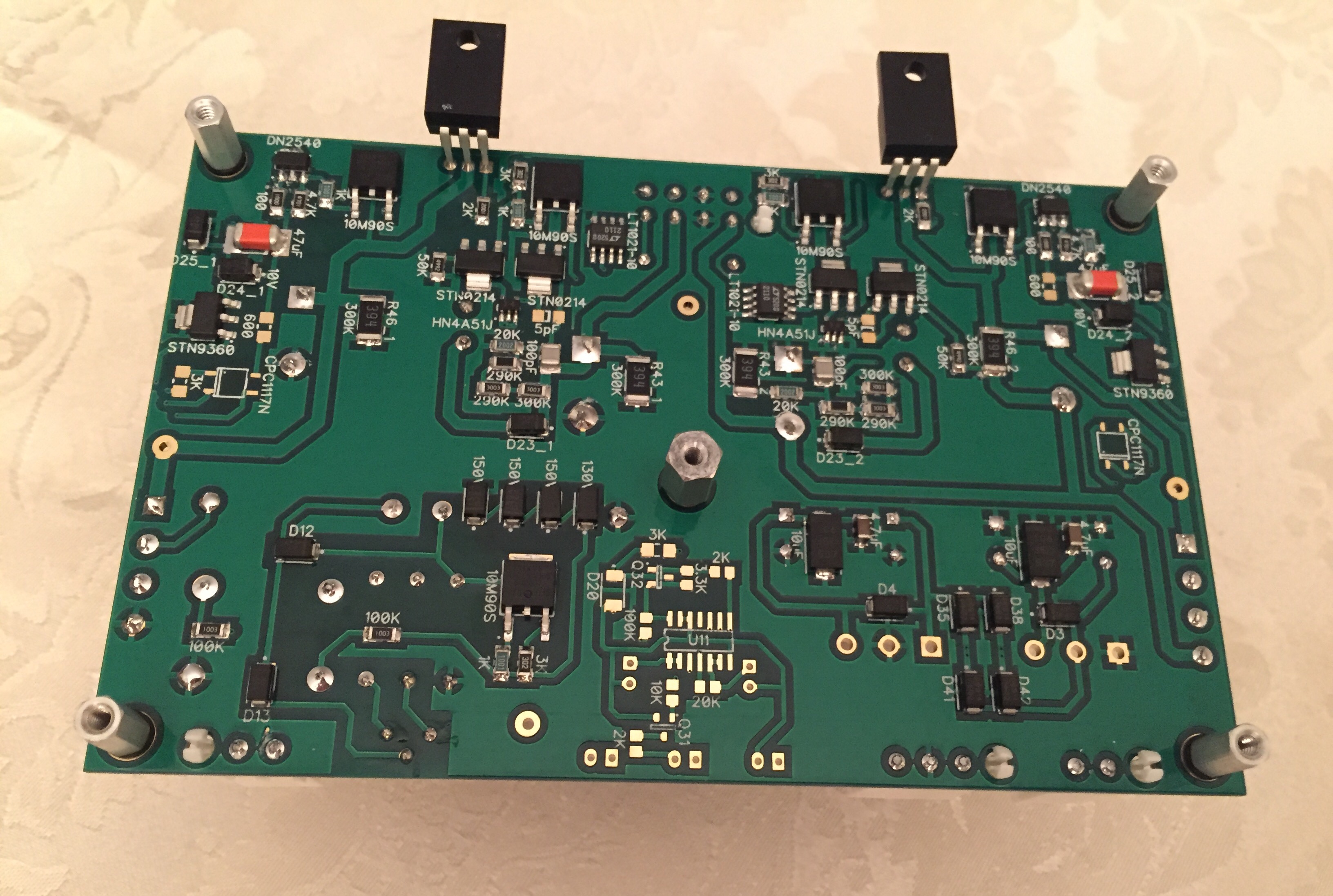

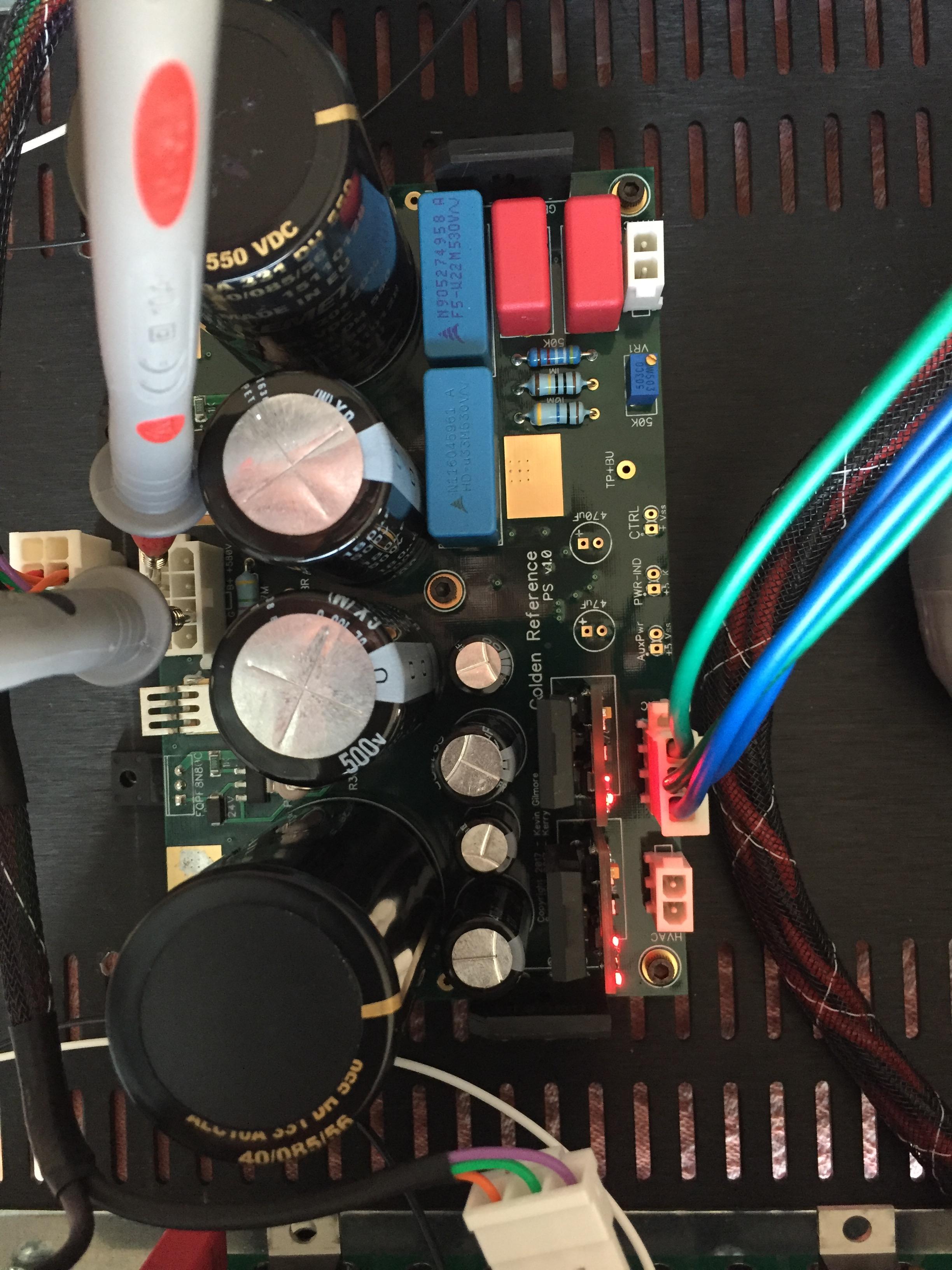

I got the HV sections and bias up and they work perfectly :)
Here's the board...
592cd4f19cbaf_FullSizeRender1.thumb.jpg.fd2d370d58ead9370258abb57b520f82.jpg592cd4f32c8f3_FullSizeRender2.thumb.jpg.0a97f7b357080c8fe74e10003c3e91de.jpgFullSizeRender.thumb.jpg.d6dba2defc64b5b80bdae8bd25a2be81.jpg
I've already tested the GRLV boards and they work.  I just have to build another set for this supply.
The thermals above the IXCY10M90S regulators don't go above 99 deg. F.  Very happy with the board so far.

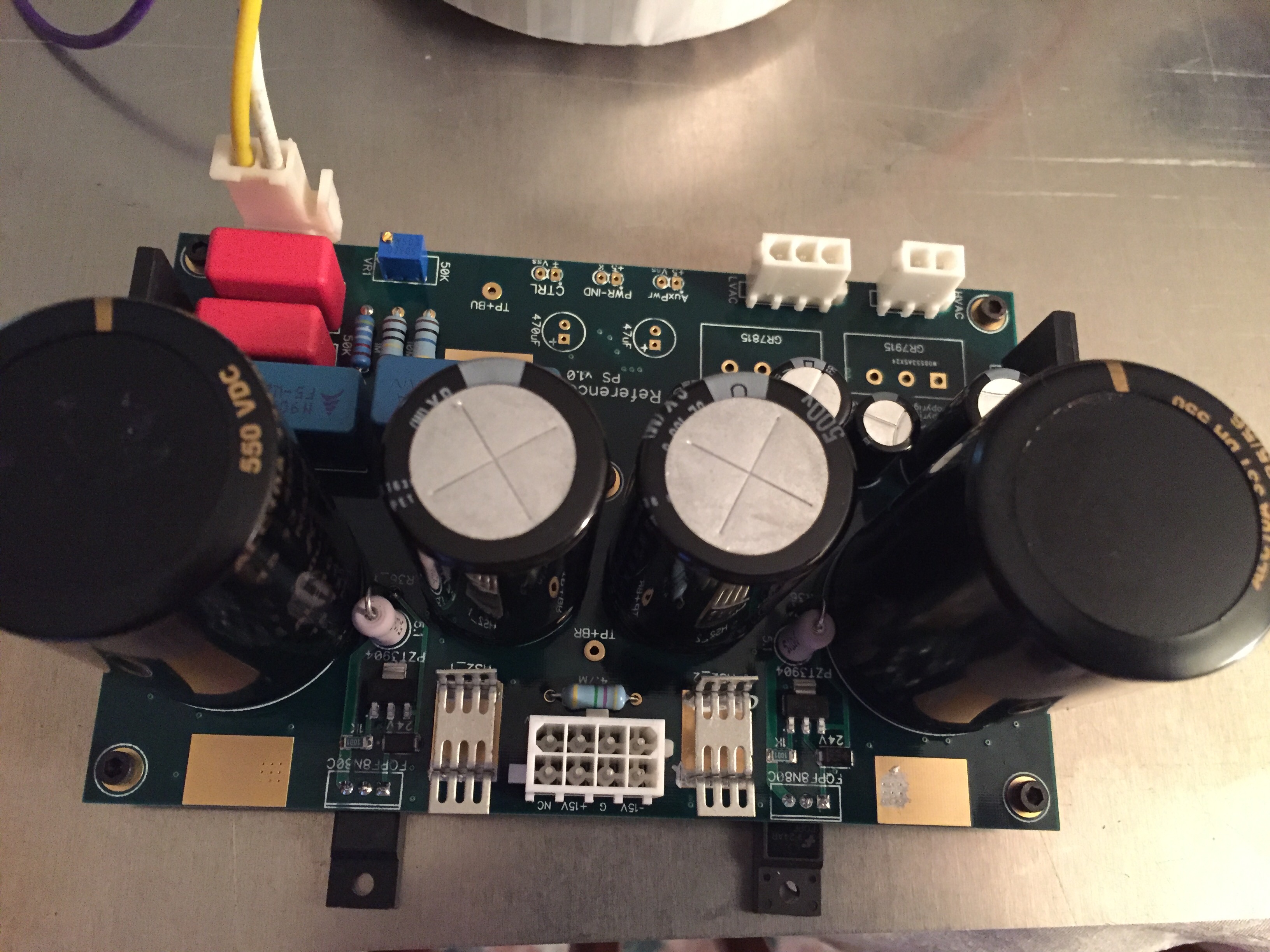

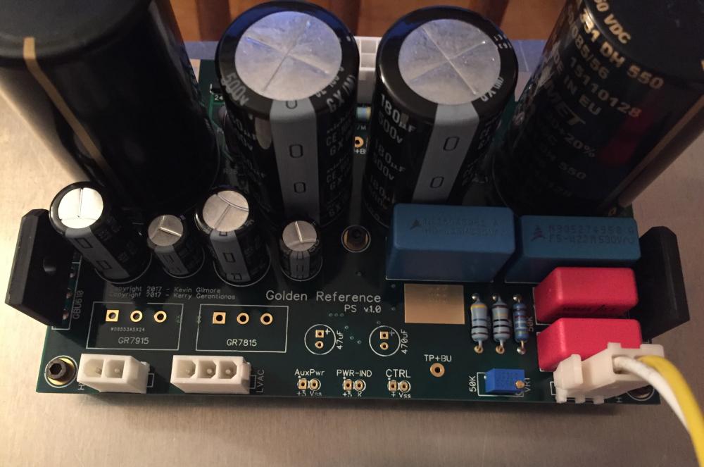

Got the LV supplies done now.  All good ?
IMG_0585.thumb.JPG.0353923b8907d0fce1d432285b300606.JPGIMG_0590.thumb.JPG.19a6a2e42b83d2de4954ec920416f86b.JPG
An everything in one PS PCB with a footprint not much different than my iPhone 6 Plus. Incredible design and work Kerry!
Edited by Laowei
This is terrific work. I wonder if I have the SMT skills to stuff a board like that. ?
Could you explain the heat sinking story here? I always made sure to attach GRLV's MJW21194 and 93 to an external sink or at least the chassis. Doesn't seem like you're doing that here. Is the expected dissipation need really low? Same question about all devices needing a sink on the HV side. Run them to a sink with wires, as Kevin suggested?
This supply is going into a carbon so the current draw is very low.  For a higher current use you should mount the LV supplies to a heat sink.

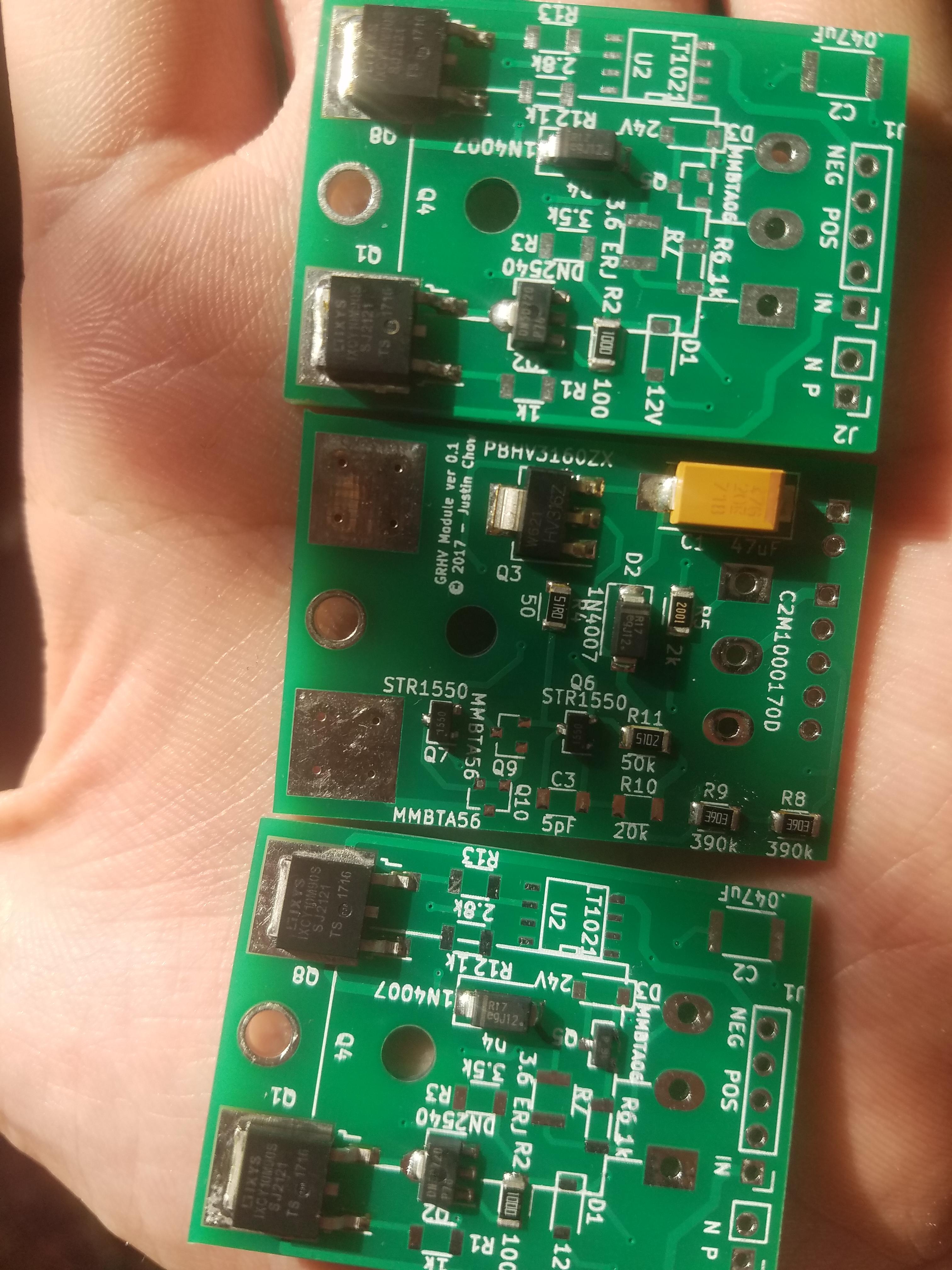

I needed a medium voltage single supply GRHV, not sure if that already exists but if it didn't it does now. Some day I will get better at layout :/ Kerry could have made this half the size.
50x91mm, just 3 vias in total so I'll claim that was my intention all along as to why the board is so big but I'll take any suggestions how to shrink it
