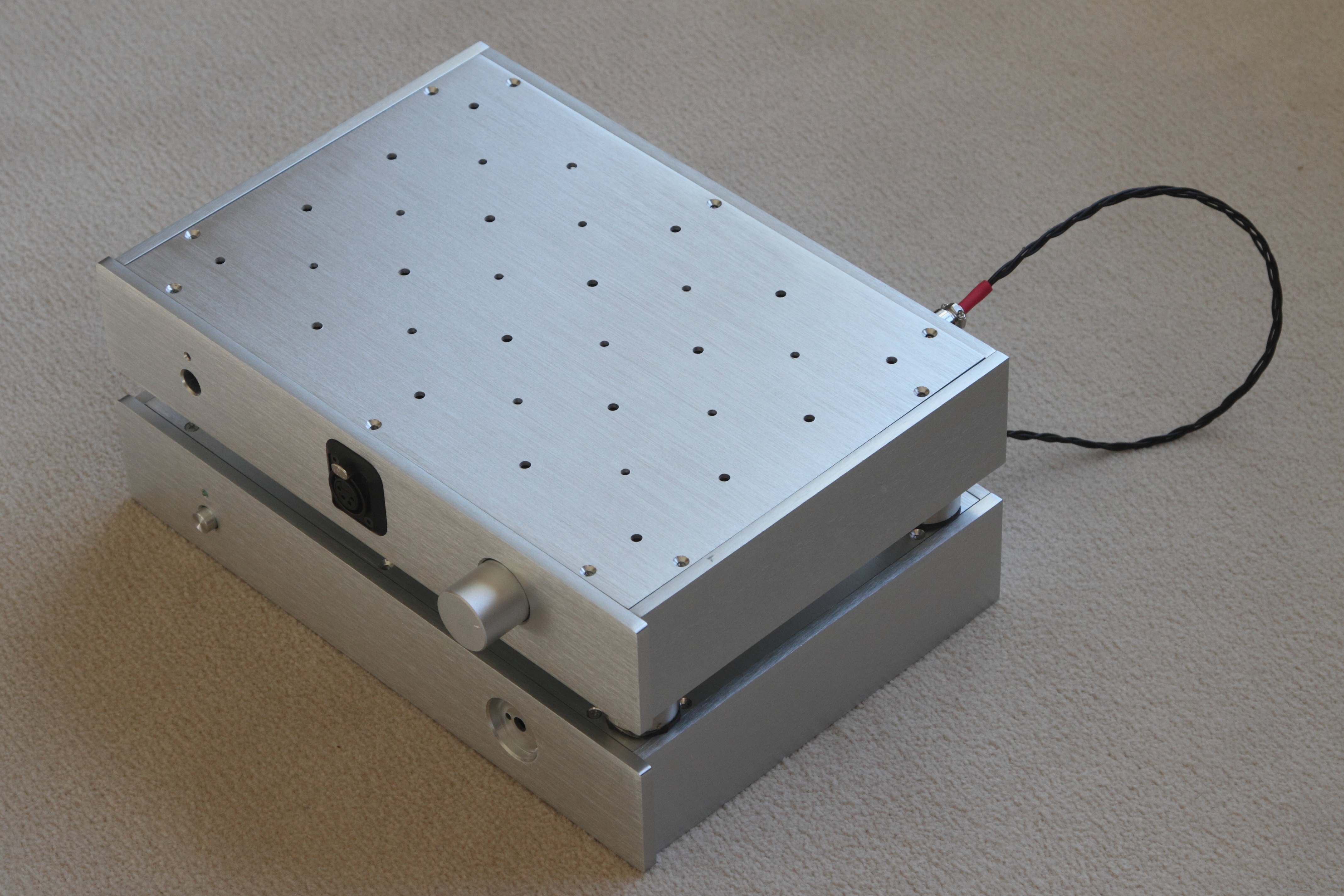

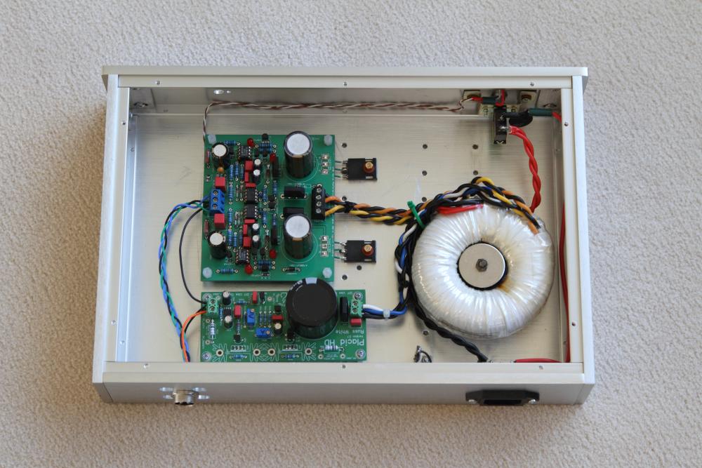

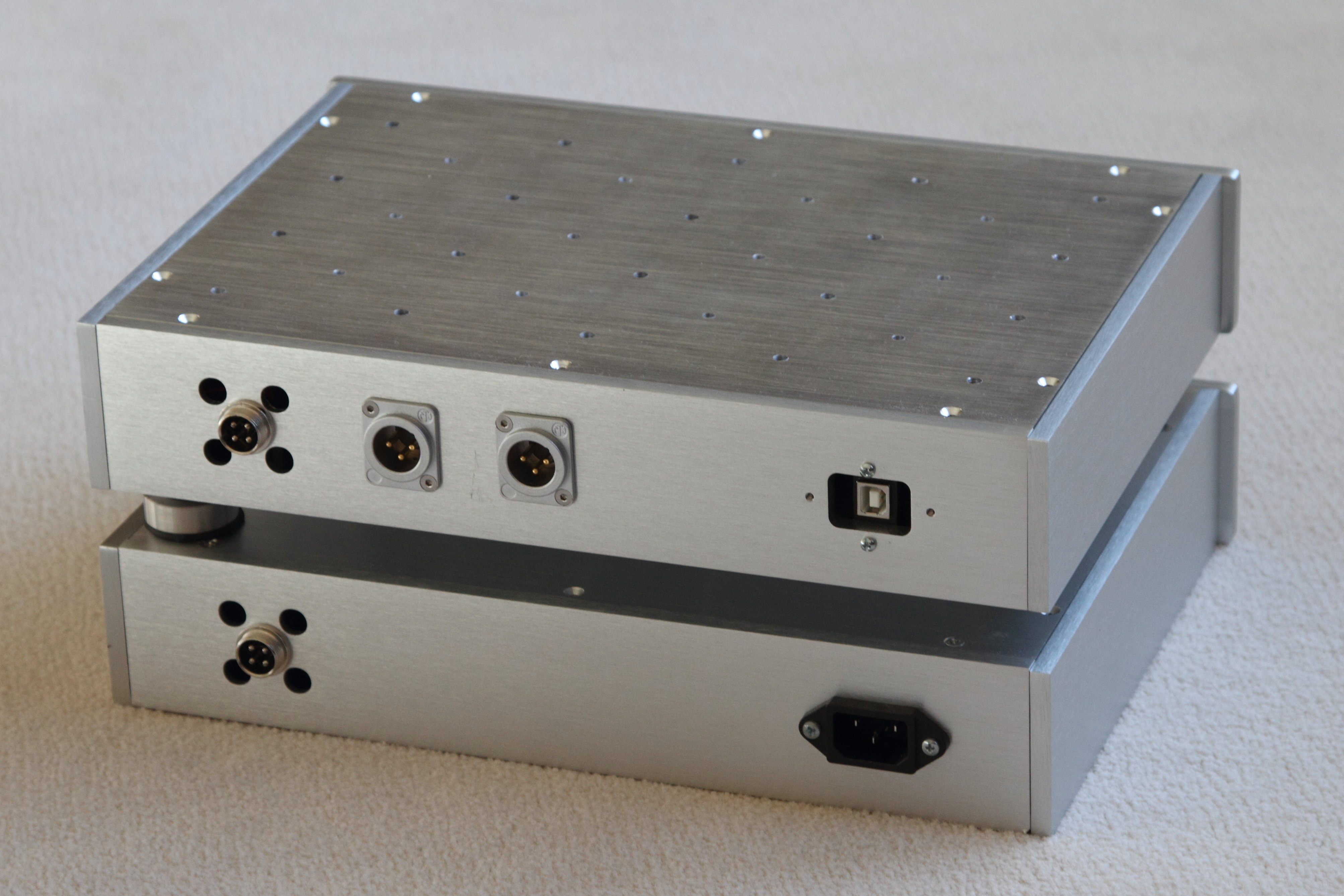

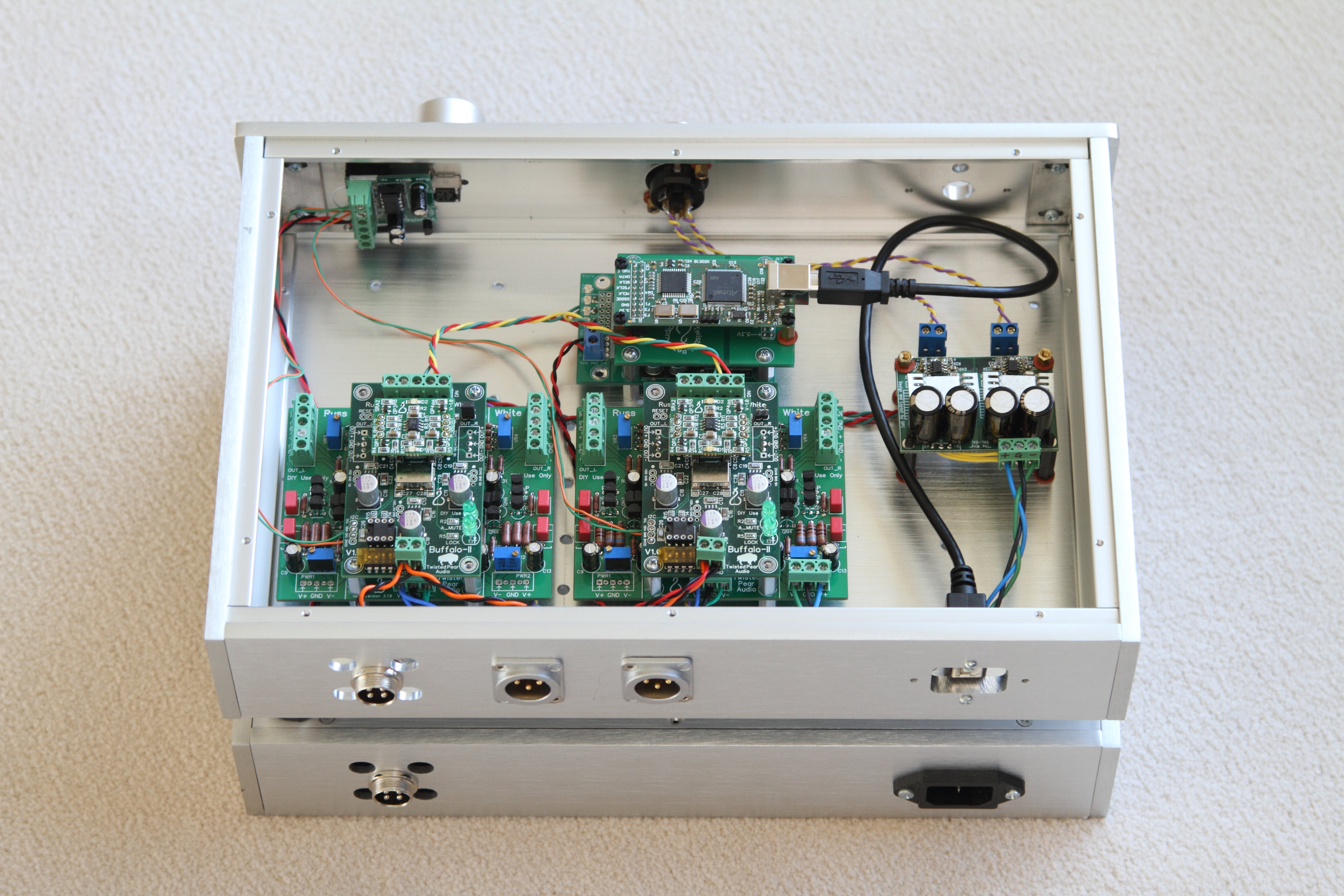

I have been using my Twisted Pear Audio Buffalo II DAC with a Volumite digital volume control for a few years. Earlier this year I decided to expand it to a dual-mono setup. In the process I also added the Amanero/Hermes/Cronus/Rhea USB-i2s adapter with isolation and re-clocking.
I used two chassis I have purchased some time ago and house the PSU in its own, separate chassis. A Placid HD powers the digital section and GR LV powers the Legato I/V converter and "The Wire" balanced headphone amp (the small module on the left side of the chassis).

^ that, the AL316S.
Be forewarned though, a friend and I ordered 4 chassis together. Three of them turned out great. One of them the panels were badly mis-aligned, the top cover was not even rectangular in shape. An inquiry to the mechant received no response.
Edited by mwl168
That sucks. Those guys have been pretty easy to get a hold of in the past too.

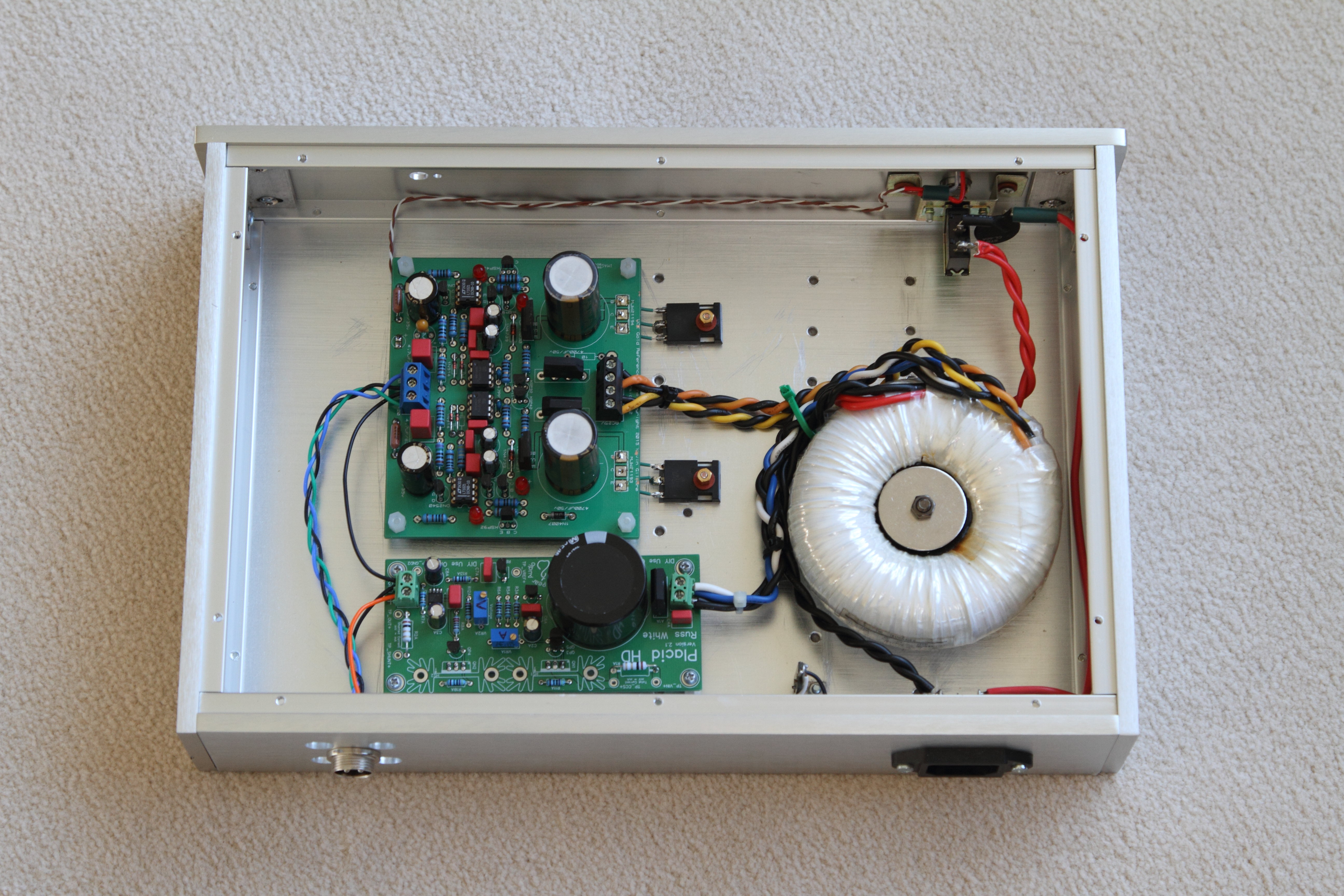

I have some small PCBs to use on the various switches and I/O jacks somewhere - if anyone wants them I can find them. Also, if you have extra pieces from that fourth chassis, I would be interested if shipping is cheap.
One other piece of advice - use a smaller washer on the toroid. This picture will give you a hint why:
(yes, that piece of copper is not insulated)
Good to know. Thanks! I'll look for a smaller washer to use and maybe cut a piece of sobathane to fit underneath the washer.

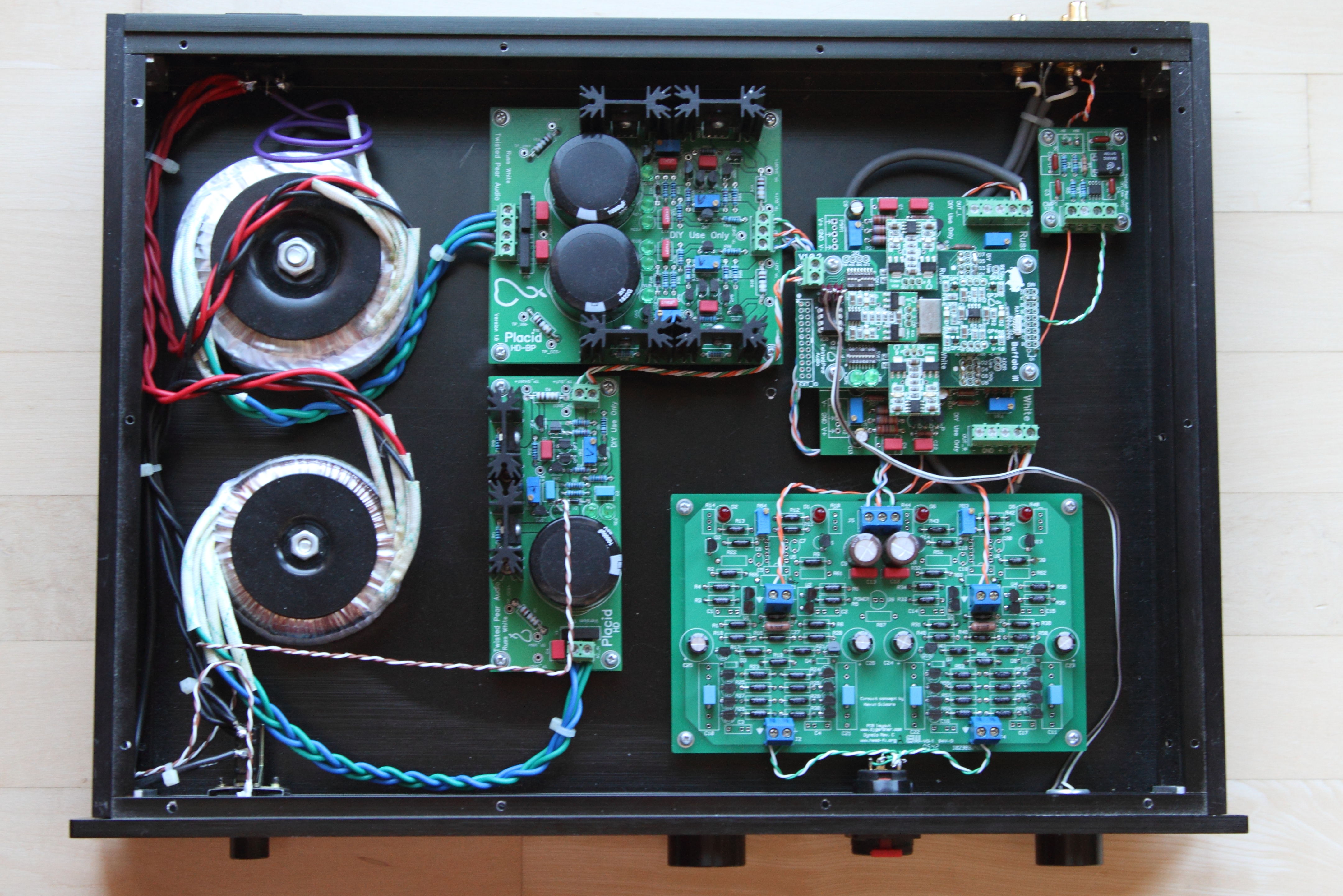

I added some LEDs to my phono stage. I used LM317 in the spirit of the original Pass Xono. Wanted something subtle and channeled Nate a bit on hatred of bright blue LEDs ;)
