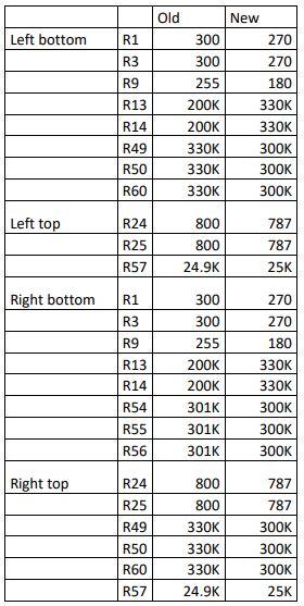

See the zip file below; JoaMat kindly put together a list of component value changes for the mini T2 that the builders can apply to the V1 boards received from me. These values will put your mini T2  close to the operation points of the original DIY T2.
Following the values on the silkscreen without changes will still result in an working amp.
The zip file contains a complete list of the changes and pictures of the boards outlining the changes. I also attached a screen shot that shows the list of changes.
Thanks very much JoaMat for doing this!
Changes mini T2.zip

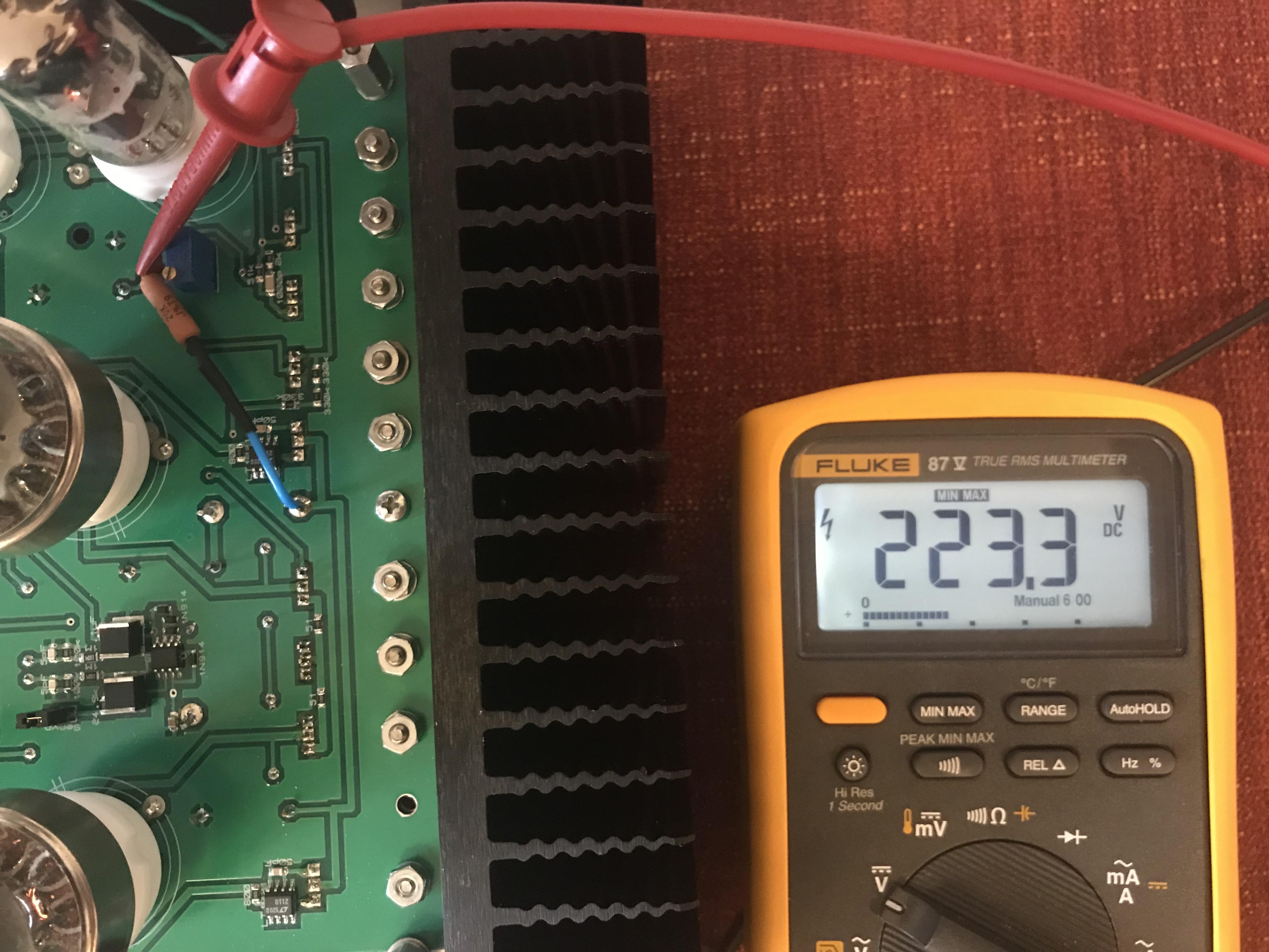

With R1 and R3 at 270R you get 4 mA through each current source plus 0.5 mA LED current. Put a resistor of 20K/2W between +400V and +220V pad on the amplifier board - gives approximately 224V. Someone try this and give a report? I’m on a Ski holiday.

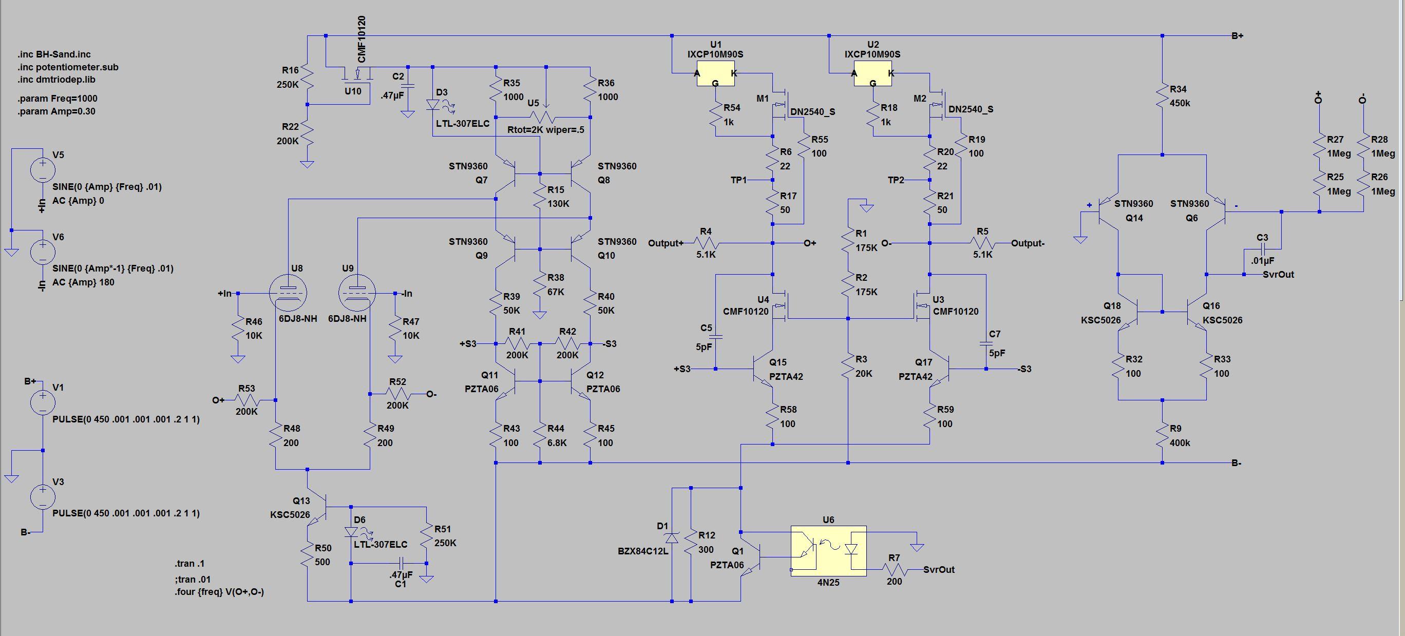

Maybe it’s not wise to entirely rely on a single 20K resistor. A better way probably is to use Zener diodes to achieve 220V as Kevin does with the KGSSHV-Tube-Sandwich.
Another way could be using mosfet like Kerry did in below LTspice simulation – see U10, R16 and R22.
Ref. Kerry post https://www.head-case.org/forums/topic/12949-stax-t8000-clone-well-sorta/?do=findComment&comment=764504
Edited by JoaMat
Back from skiing. Zoom in on the Vishay CPF3 resistor and you can read 20K. 400 volts in at the blue wire. The meter is in Min Max mode and it went up to 225.5 V at start up and then immediately down to what you see in Picture.
Seems to work. I’ll change the other channel and will test this for some time.
I have run the amplifier on a unchanged T2 PSU with +/-500 V and +250 V for a while and that also seems to work alright.
Edit: Both channels now with 20K resistors to achieve the +220V. 220.3V respective 219.6V with PSU +400V trimmed to 401.9V on the clocks.
Edited by JoaMat
I haven’t run the amplifier with 20K resistors for more than a day. But after switching power on and off frequently I do think this will work. With R1 and R3 at 270 ohm I get 9.0 to 9.1 mA at +220V (each board) and with PSU positive rail set to 400 V a 20K/3W resistor seems to fit perfect.

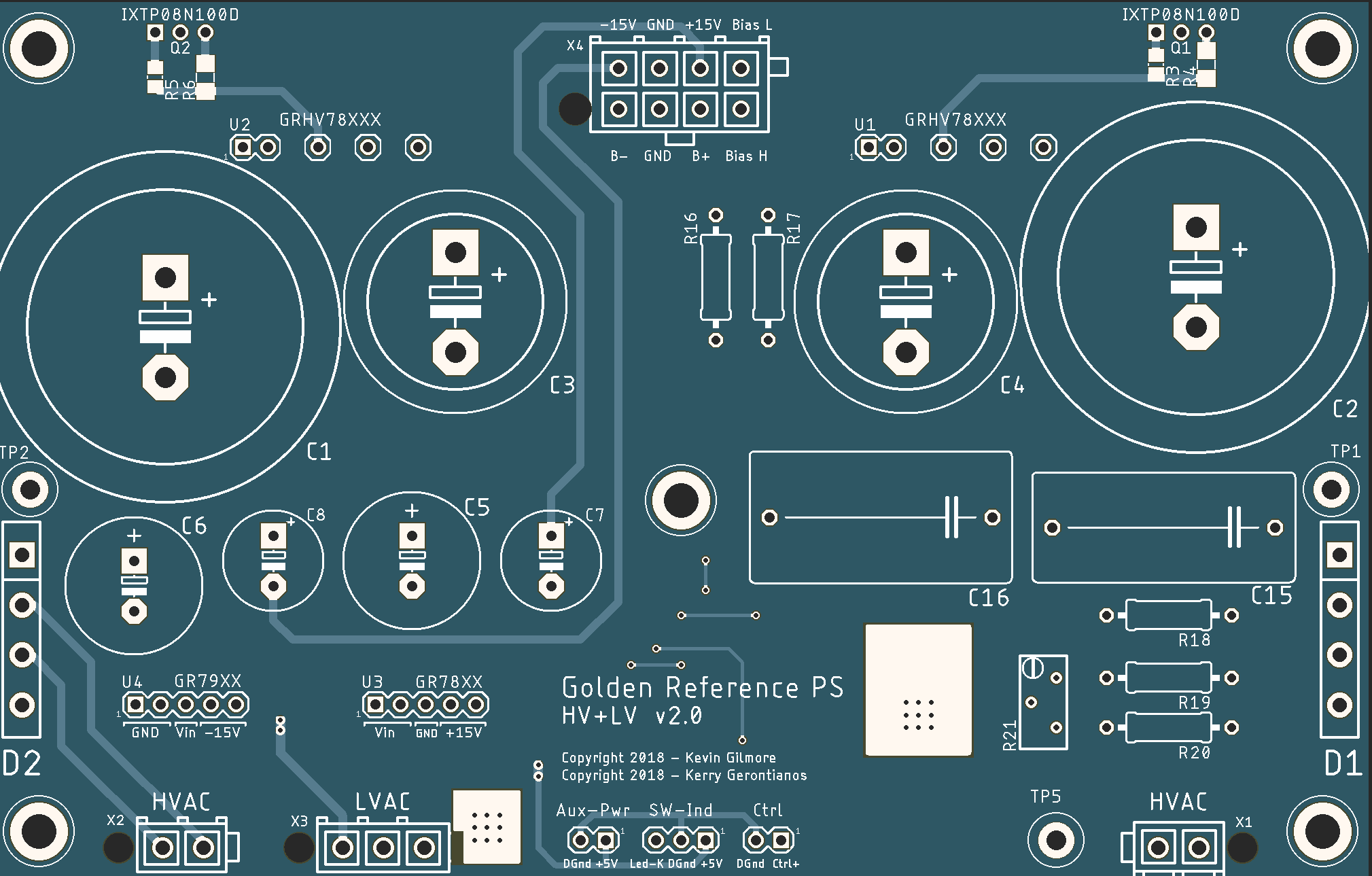

I think I want something like this
1258175321_GRLVHVBase-T_png_b42c77a611ebadca311cb9f26dd60c4d(2).thumb.png.4a8fae2e12dffb82a1adb994b9acf3c5.png
...for power supply.
Edited by JoaMat
I've tested this supply and it works nicely

We definitely need a group buy for those PS.
All-in-one PSU for the miniT2 kept mini (apart from the transformers, but that's another story).
