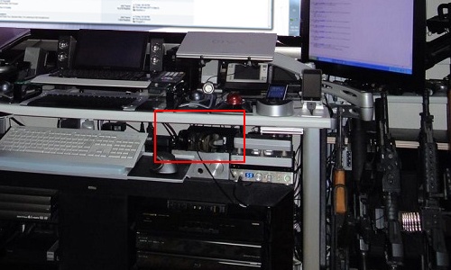

Good sight, even highlighted I really can't say what are those, nor that they're atop a Stax amp :palm:

I hope they are just BB guns. :(
No, those aren't BB guns.
I dont know the guy, but I am a weapons expert
and also a fanatic in that regard. That looks to be a real armory.
Just like the O2's in the pic look to be real Stax cans.
Then again, it is just a pic.
Could be a room full of plastic movie props.
What gets me salivating though is the Barrett M82 50cal sniper rifle up top
along with the 50 cal Browning M2 Bar belt fed on the far right.
Coupled with some depleted uranium tracer ammo, that is some ultimate personal firepower.
If this guy's in California, it's probably movie props. Unless they lifted the ban on 50 cals there.
