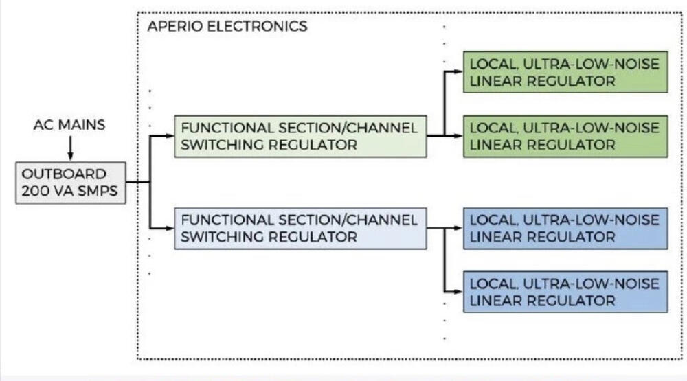

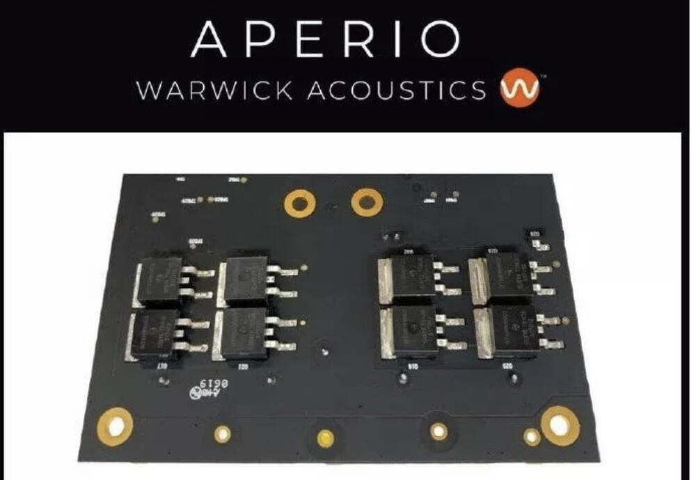

Looking inside of the chasis,  while I won't judge the components just based on the size in that many great source components are also small as Weiss DAC (but it harbours at least two nicely sealed totorial transformer linear power supply even to my non engineer eyes), however I am kind of shocked at how could Warwick Accoustic include good power supply and pre-applification section that is " a novel class A circuit that can output very high voltages with prodigious current" in that limited space, along with amp, streamer and dac, that all seem to be outstanding to my ears personally speaking.
Subjectively, I think Aperio is superb sounding especially its cripy and well extended lows, yet I did notice occasionally it sounds as it is about to lose control especially in the highs and treble region, which I assume might be related to the amplication.
Any professinal thoughts on this super duper high end design in a small chassis? Well it might be unfair to critize the size of Aperio considering the power amplifier of HE-1 is housed inside of their headphone earcups, lol, which I thnk could explain the lack of voltage and power as I have to turn amolst three'o clock to make the HE-1 fairly loud.

From warwick official website, I think their aperio has a high voltage bias (1800Vdc) driver, which is much higher than the 1350Vdc of their lower models. it means that the output voltage of the amplifier no longer needs to be as high as the traditional electrostatic system, therefore does not require too much power and heat dissipation.

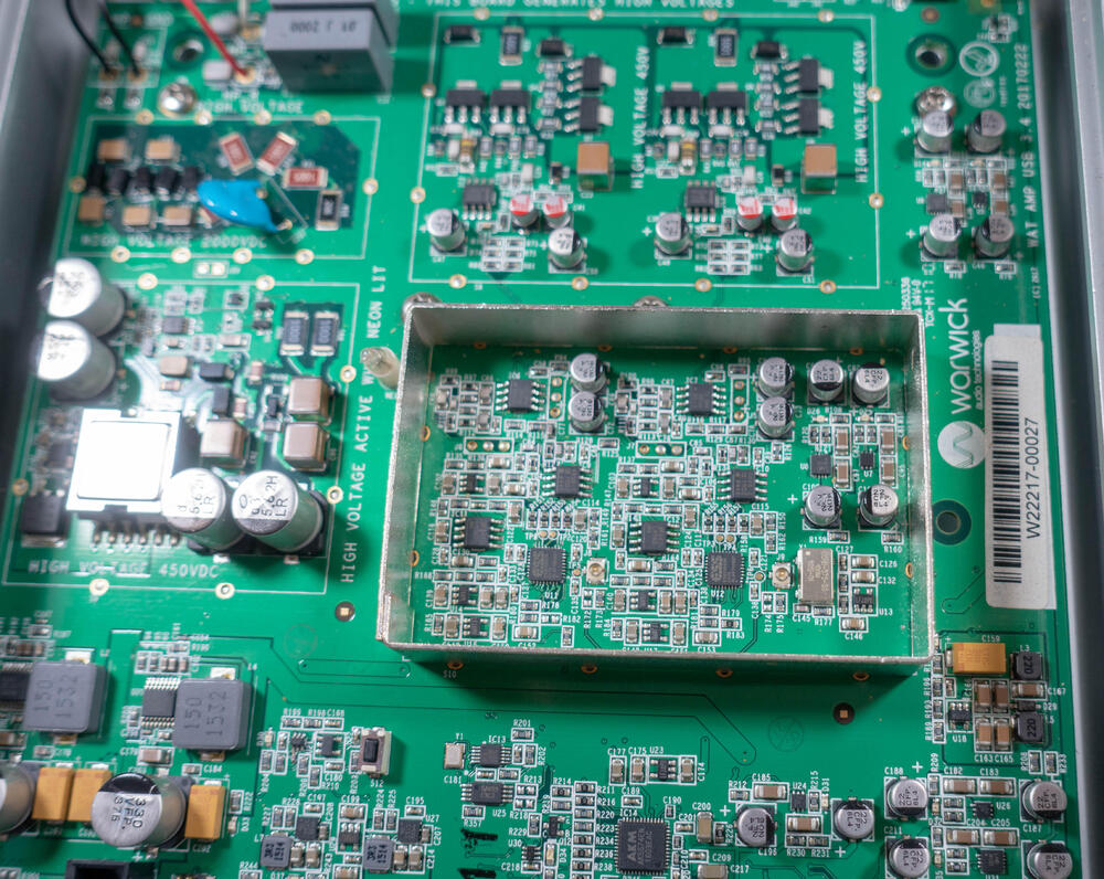

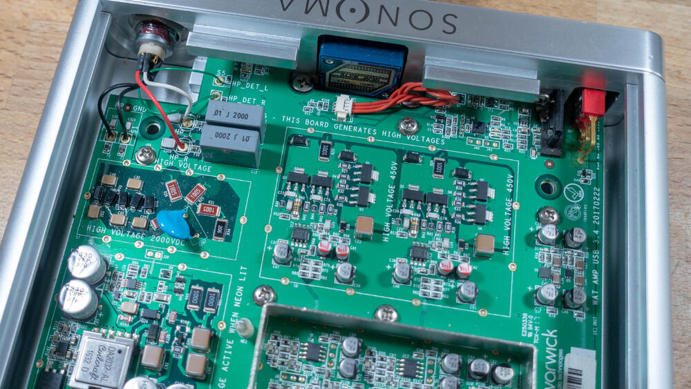

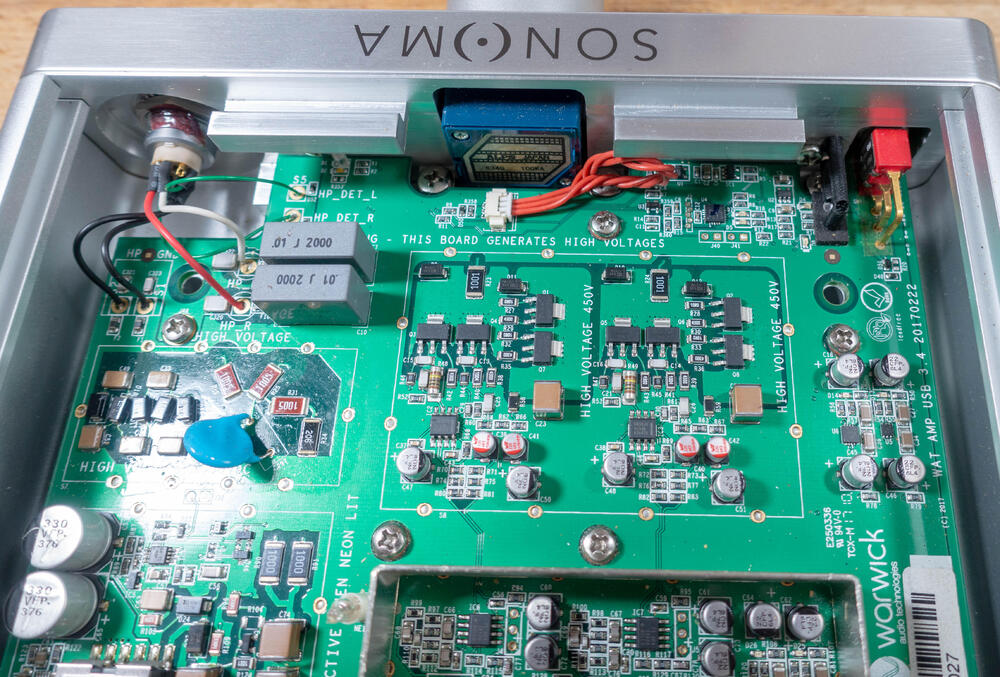

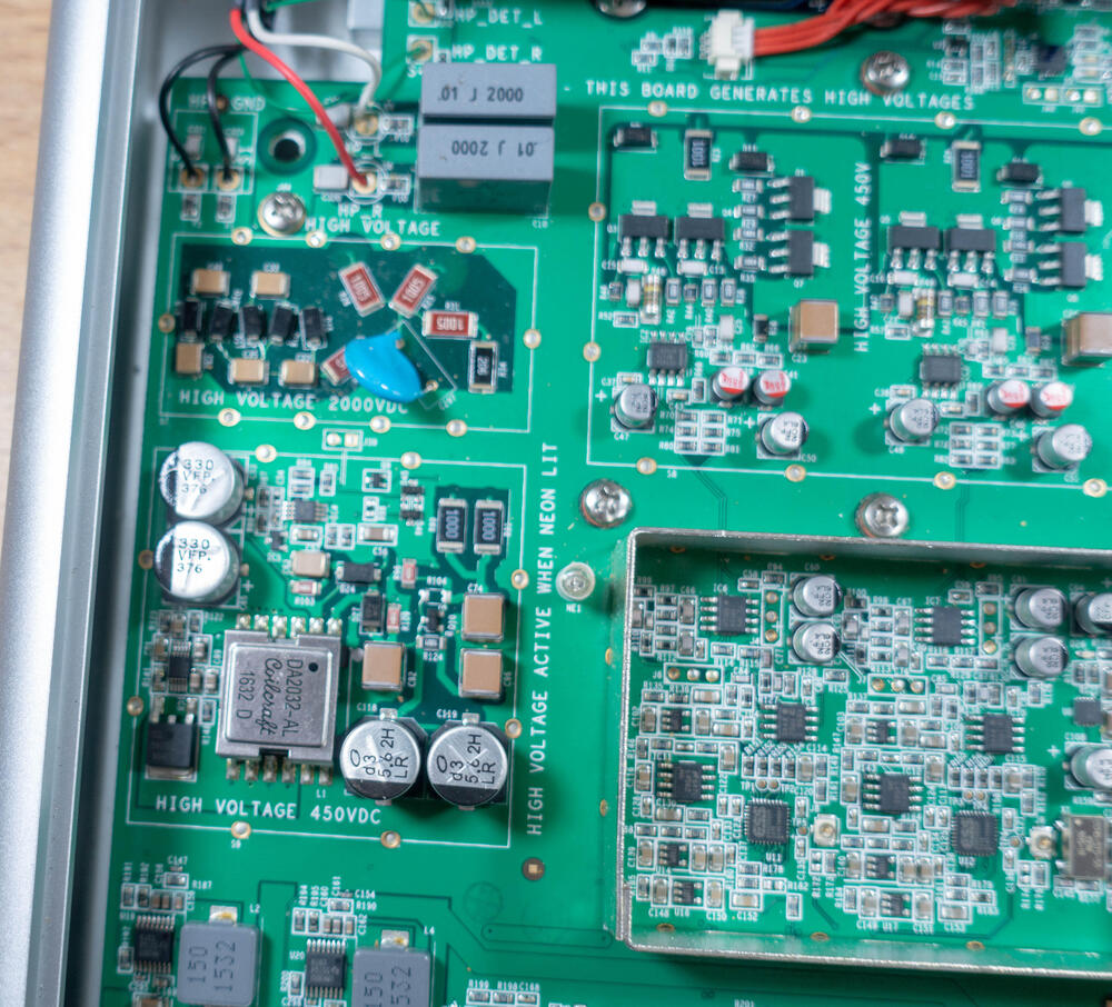

I have a couple of the Sonoma Model 1 sets so I've been looking into making an amp for them.  They are pretty much worthless at this point so can be picked up cheap but yeah, single ended and the driver design is all kinds of stupid.  The bias is 1350V and the amp runs on a single 450V rail so the bias is doing most of the work here.  The bias is actually on the drive signal with the AC signal super imposed on it through a 2000V cap.  Why did they do this?  It was supposed to be cheap but sold for 5K$... yeah.  They are also very non linear so the internal DSP is doing a lot of work.
I did listen to the Bravura in NYC and what a fucking turd.  The drivers are close to identical so all of the same issues as the older Sonoma.  You can hear it's a tailored sound from the DSP as they try to fix the mess the drivers are making.  None of this makes any sense...

Nice input, yet the chasis does run hot maybe due to the fact that the preamp is class A? There are fans and some strip shaped vent on the top of the chasis for heat dissipation though.
It seems as both these two summit fi AIO designs have adopted unorthodoxical and different approaches to avoid the use of traditional power amplification propably in order to keep the size more compact? Yet they do both seem to put a lot of effort in the pre-stage, the link that has been underestimated in headfi, compared to their take on the power amp.

The picture of Aperio strikes me more of a source component with switching power supply rather than an amplification structure. While there has been debate over the low heat and high efficient Switching Power Supply vs. Linear Power Supply, the later has been widely held as superior sonic wise. Even many top ceilling source component as Aurender W20 has upgaded its SPS to LPS in their newer W20SE.

Their flagship Aperio is balanced discrete design
I know but same shit driver design and amplifier.  What are the odds this isn't shit as well?
