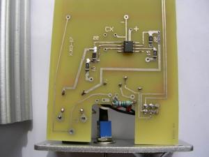

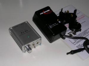

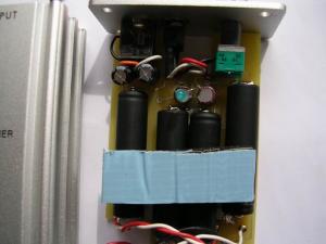

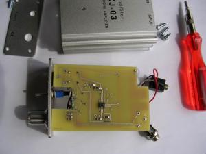

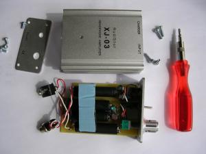

September 27, 200817 yr i found some internal pic of this portable amp, and posted in the headfi thread. http://www.head-fi.org/forums/f105/rudistor-xj-03-a-347133/ some1 pm me asking me to remove it. was there something wrong i did posting internal pic to be share with other? anyway,what do guys think of this amp? some1 in headfi reckon it's better then the pico, it look like a ra-1 to me?
September 27, 200817 yr Reminds me of the "deceptively" simplistic Xin SuperMacro IV when I was loaned one and opened it up. I can't imagine that it sounds great with that sparse of a board. The best-sounding amps I've heard have a nice chunk of electronics.
September 27, 200817 yr Looks like a Cmoy to me. Sovkiller posted the following in the hf thread you referenced: Externally charged batteries are useful if you use one or two batteries, but not for battery packs. Also it has a circuitry inside to monitor the battery operation, and optimize their performance, based on the batteries selected...Those cases and combinations of small battery packs, of just one or two batteries, are more or less the power used in the portable sources. What is the big deal then in purchasing and carrying an amp with you, if you will have at the end a very similar performance??? Rudi wanted something more beefy and substantially different in sound, and those small packs battery selection do do not provide enough juice for his design to operate properly, and offer what you are looking for... I don't see any charging circuitry whatsoever beyond perhaps a resistor on this thing, unless its built into the case or something that I can't see from those pics. Looks like it uses a pair of AAs?

September 27, 200817 yr Looks not that "sexy" inside, or would I say expensive... Anyone tried it yet?

September 27, 200817 yr No conformal circuit board coating on a portable?? Bad idea. Really bad idea. Very cheap ripoff of a tomahawk which is a ripoff of a ....
September 27, 200817 yr Yeah, I hadn't commented on the spare no expense PCB... hehe. I've done home etched boards that look as good (or better) than that. Of course Rudi would probably claim that silkscreen/solder mask, etc. have a detrimental effect and cause ripples in the force or some such nonsense
September 28, 200817 yr The quality of the PCB left me gobsmacked. It is rubbish. My comparison is from working 20 plus years in Telco manufacturing and supply. Even boards being made 25 years ago were better than this. $US500? Madness.

September 29, 200817 yr This unit is just like every single other thing rudi has made. The finish is called solderbrite. The boards are still layed out by hand as evidenced the parallel traces not being parallel. Audio Research still does a lot of their stuff this way. The finish lasts no more than about 10 years before corrosion starts to cause trouble. I did a set of prototype boards this way about 20 years ago. And decided never again. it is a bunch cheaper because 2 less masks are needed.
