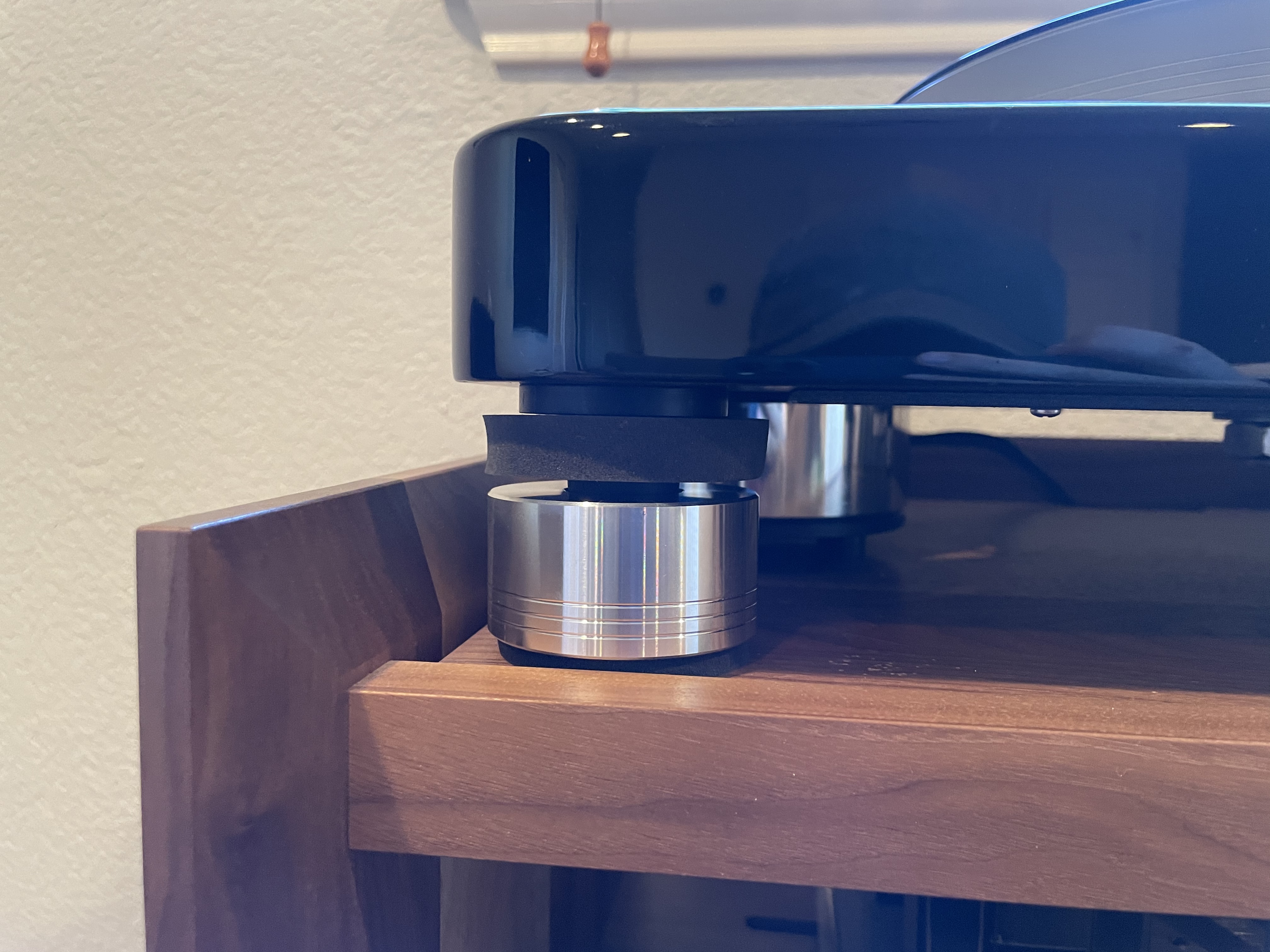

It’s fun getting to know a new setup. I don’t have the VPI really dialed in yet, but already don’t like the threaded clamp. I am trying just a heavier weight that places over the threaded spindle. I also don’t know why VPI didn’t better match up these foam discs when adapting their newest footers to older designs. I think I will have a go at designing a replacement.

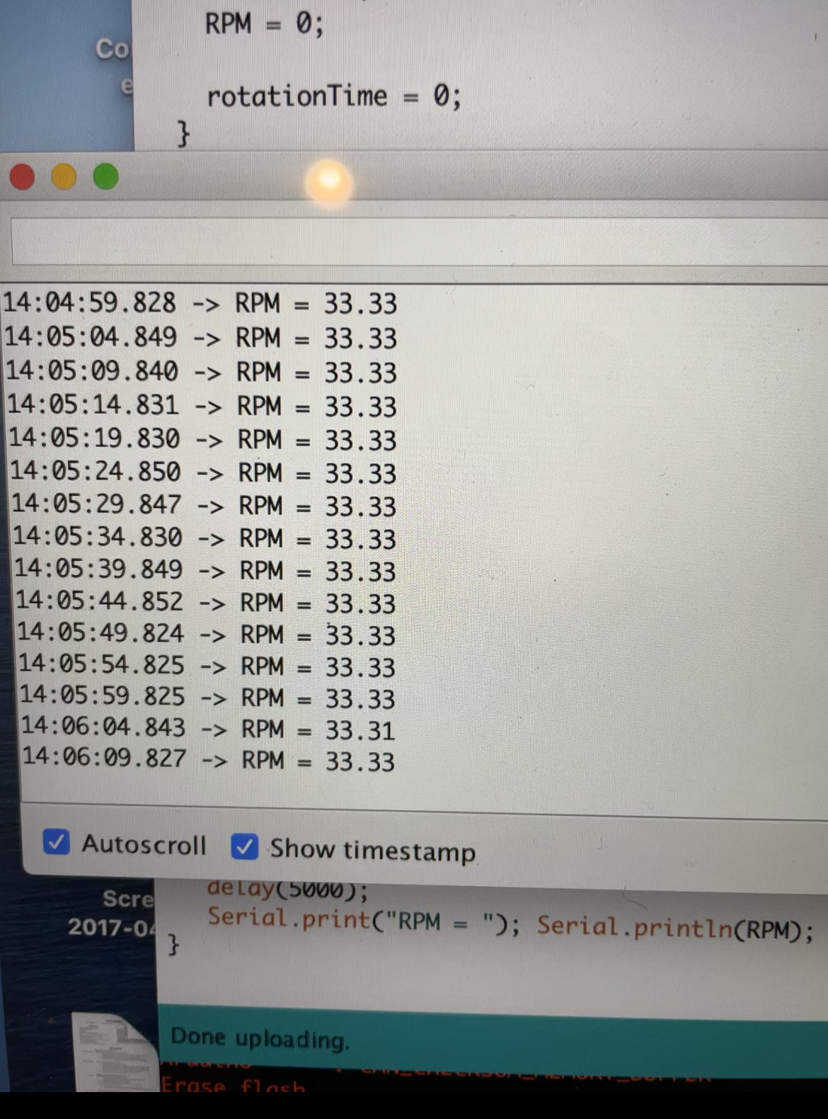

The optical based sensor seems much more fiddly compared to the magnet. It’s influenced by ambient light (for example record needs to be on the platter) and I am using a small craft mirror on the platter but not sure if just a white dot would work better?
The part is VNCT2020.

I got the code working to measure the platter speed! The sensor is still wonky - maybe I need to build a shroud around it..

Maybe I just built a ghost sensor! That would explain a lot... maybe this is the newest fad in audio accessories

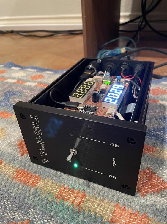

Woo, looks like the CPU board is working! Currently set at 20.29 Hz for 33.33rpm output. Got the front panel also working and now just need to solve the issue of the reflective IR Sensor (or go back to a magnet) - which I think might take a shroud to try and reduce stray light. The second display will then read out the actual platter speed as measured by the tach. Then I can adjust the speed in a feedback loop (PID).

So openings for the displays will be cut into the top panel? Or will it be some type of mesh/expanded metal?
Actually, no but good question! I have three of these identical looking PSUs now - keeping the simple aesthetic. The PCB could be mounted that way though, but in my “case” it won’t.
I plan on logging hours the TT is on (to estimate stylus wear) and how accurate the speed control is. I will retrieve that data off the USB port if needed.

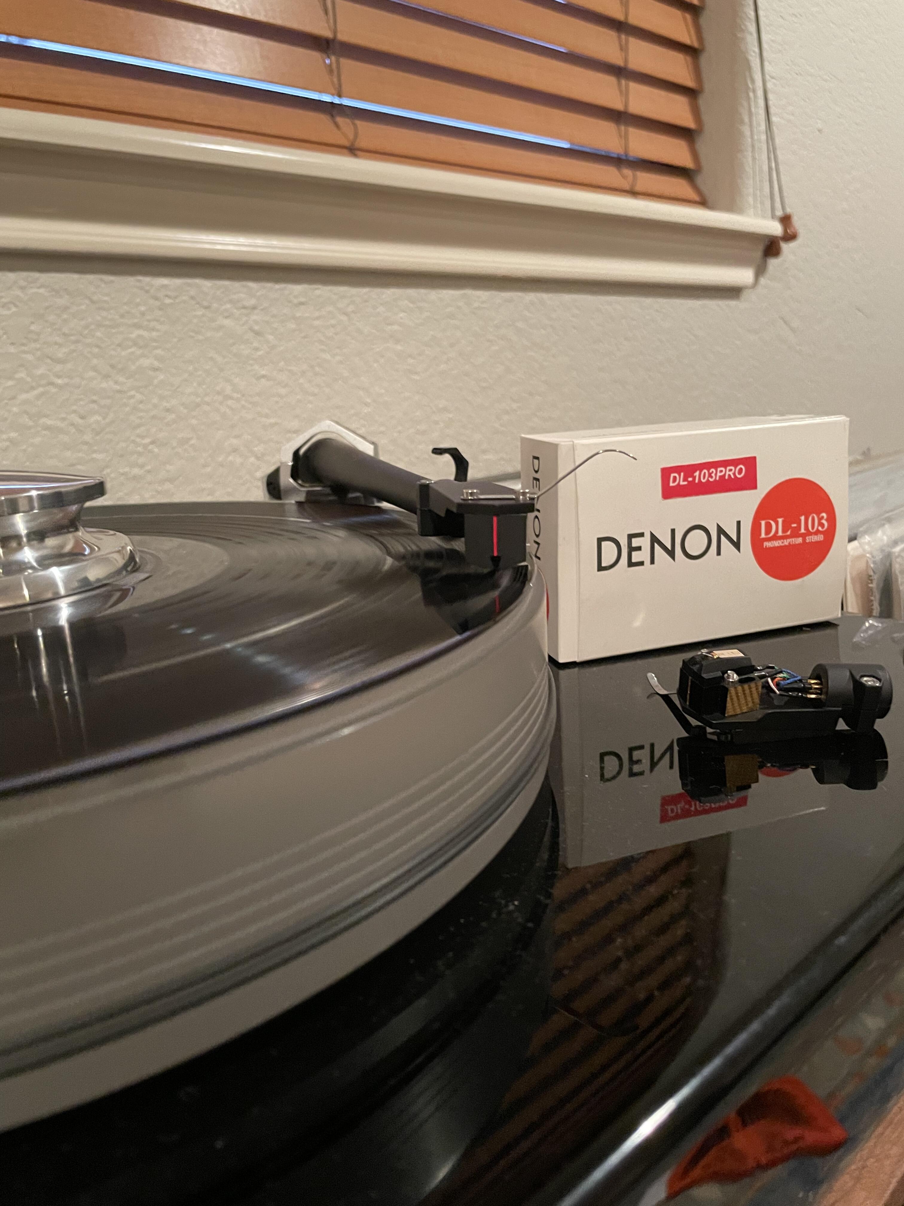

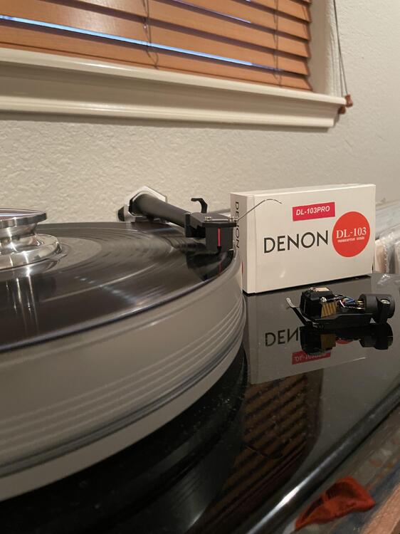

A bit of cart swapping to validate the arm board design. It has enough travel in the slots to work with the elusive DL-103PRO

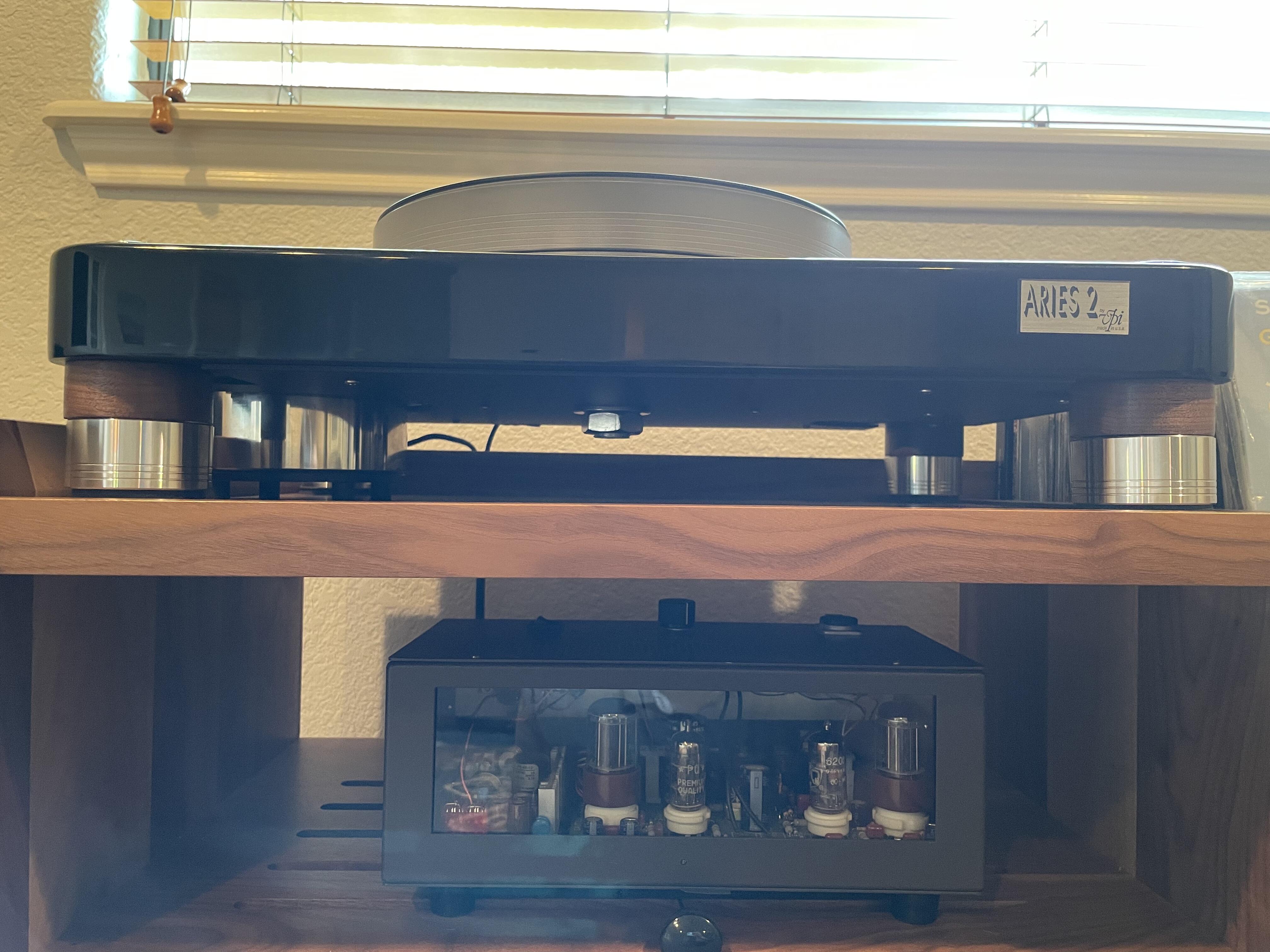

We need a pic of the complete turntable!

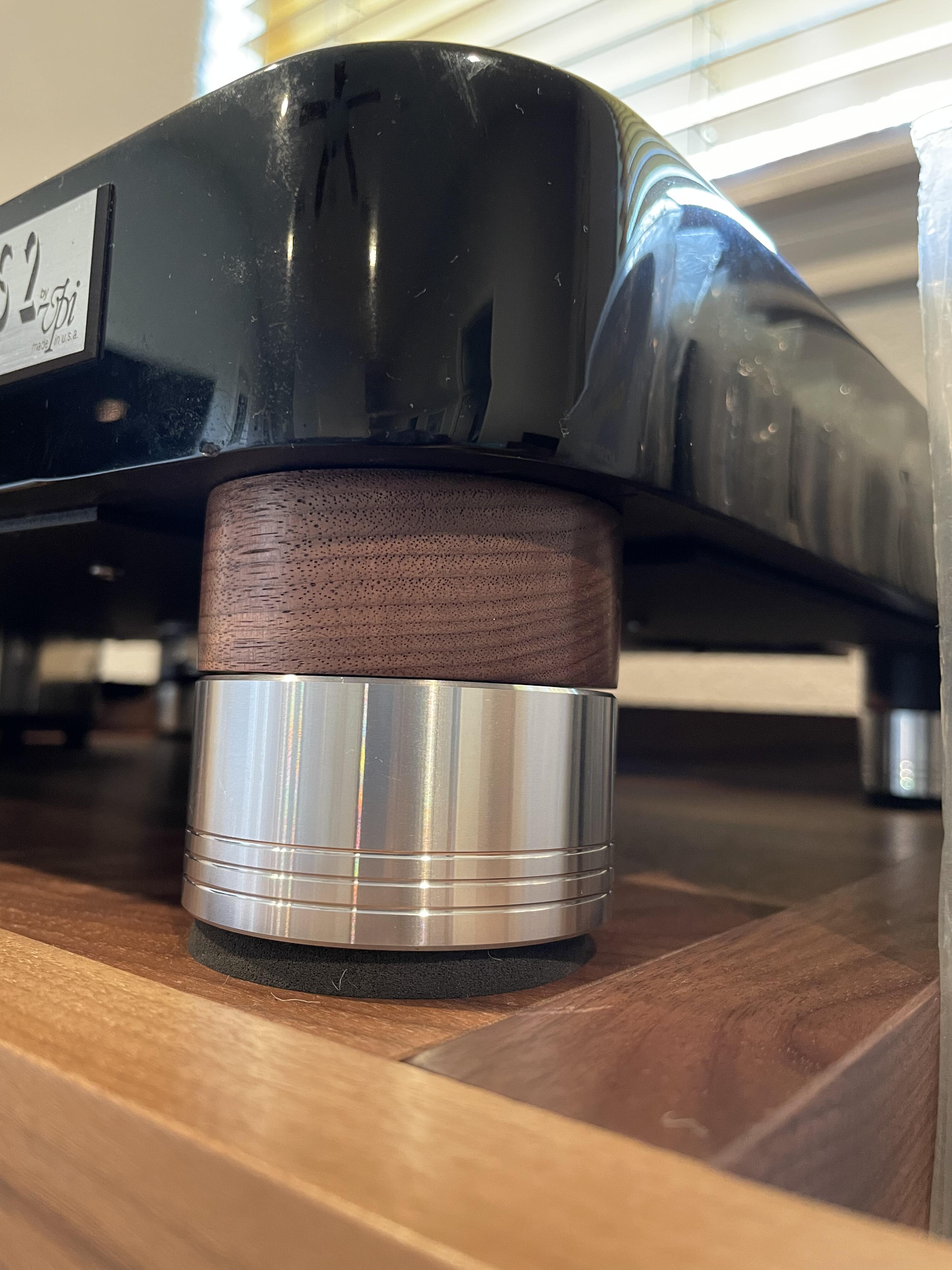

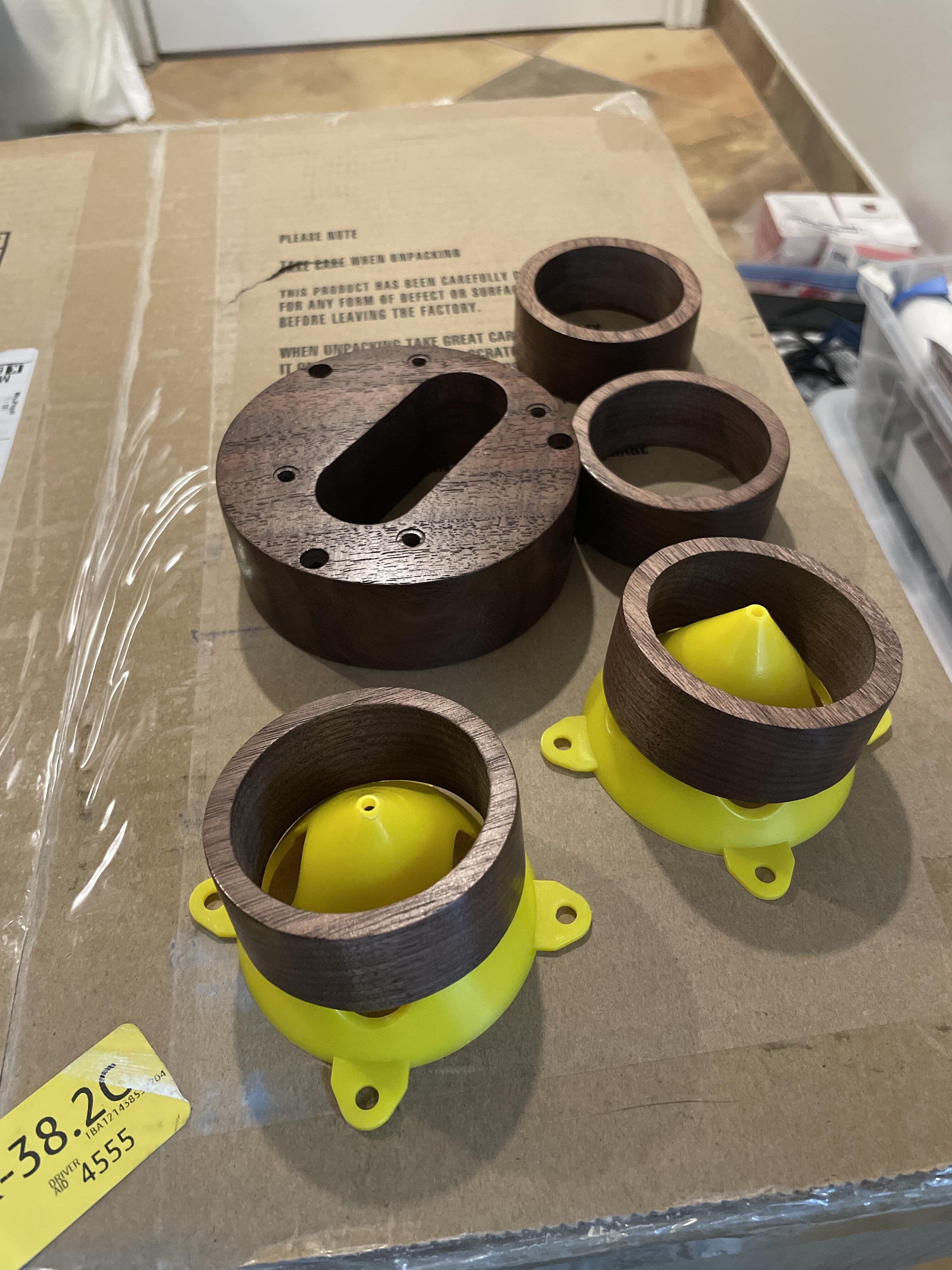

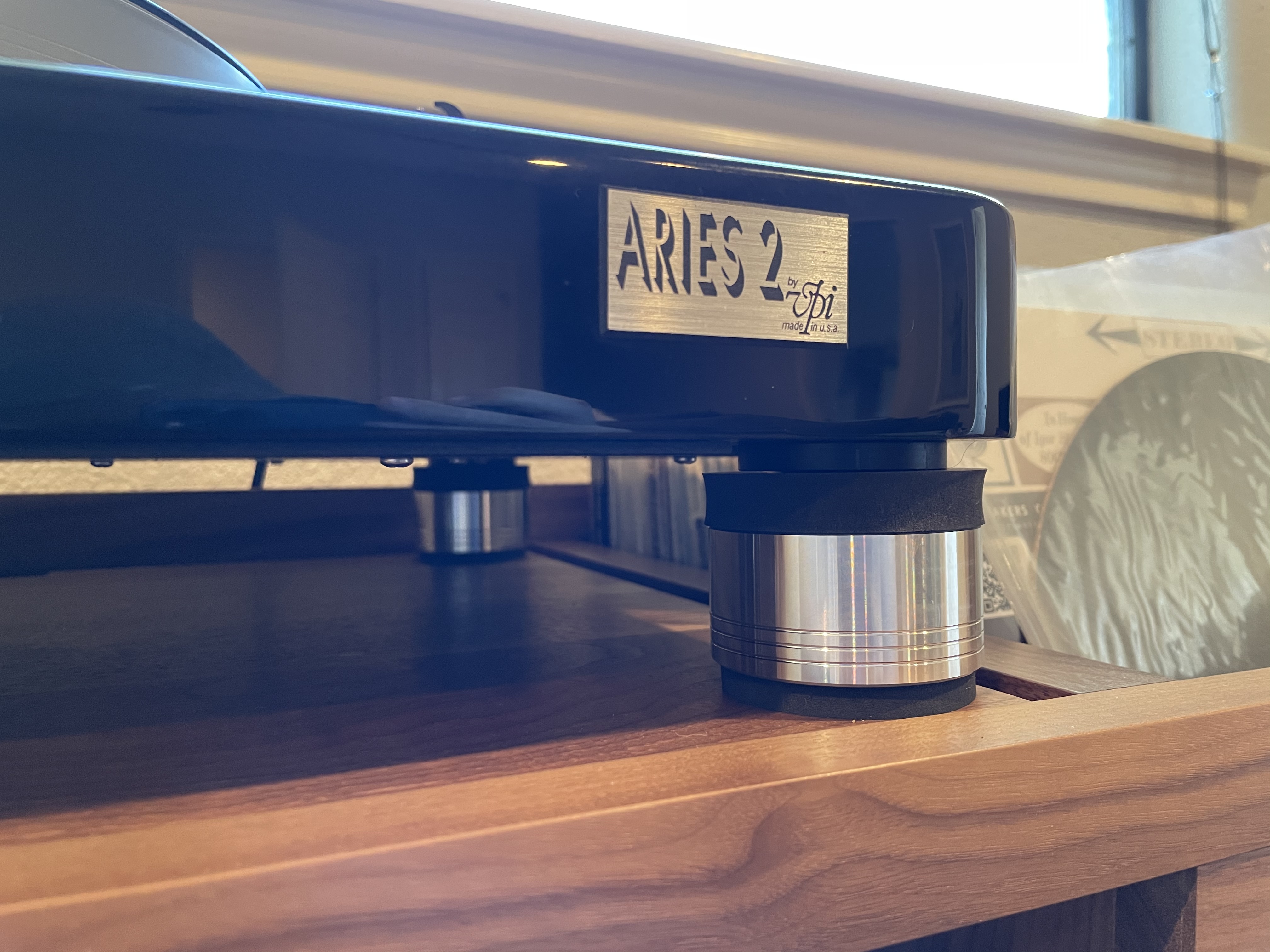

I am working on adding some walnut footers, which I almost assuredly mis-measured.
Here are the feet - there isn’t enough travel in them I think. I probably need another solution than the motor mount (male stud, rubber, male stud - which goes into the aluminum line footer and the shiny round circle thing on the top) idea which is stock for these VPI tables. There is a slight gap on purpose to suspect the table so it’s just decoupled via the rubber… the wood is just attached via glue dots to the underside of the plinth to hide the motor mounts.
Edited by luvdunhill
I really like the look. Especially when you see it tie in with the Walnut arm board. NICE!
