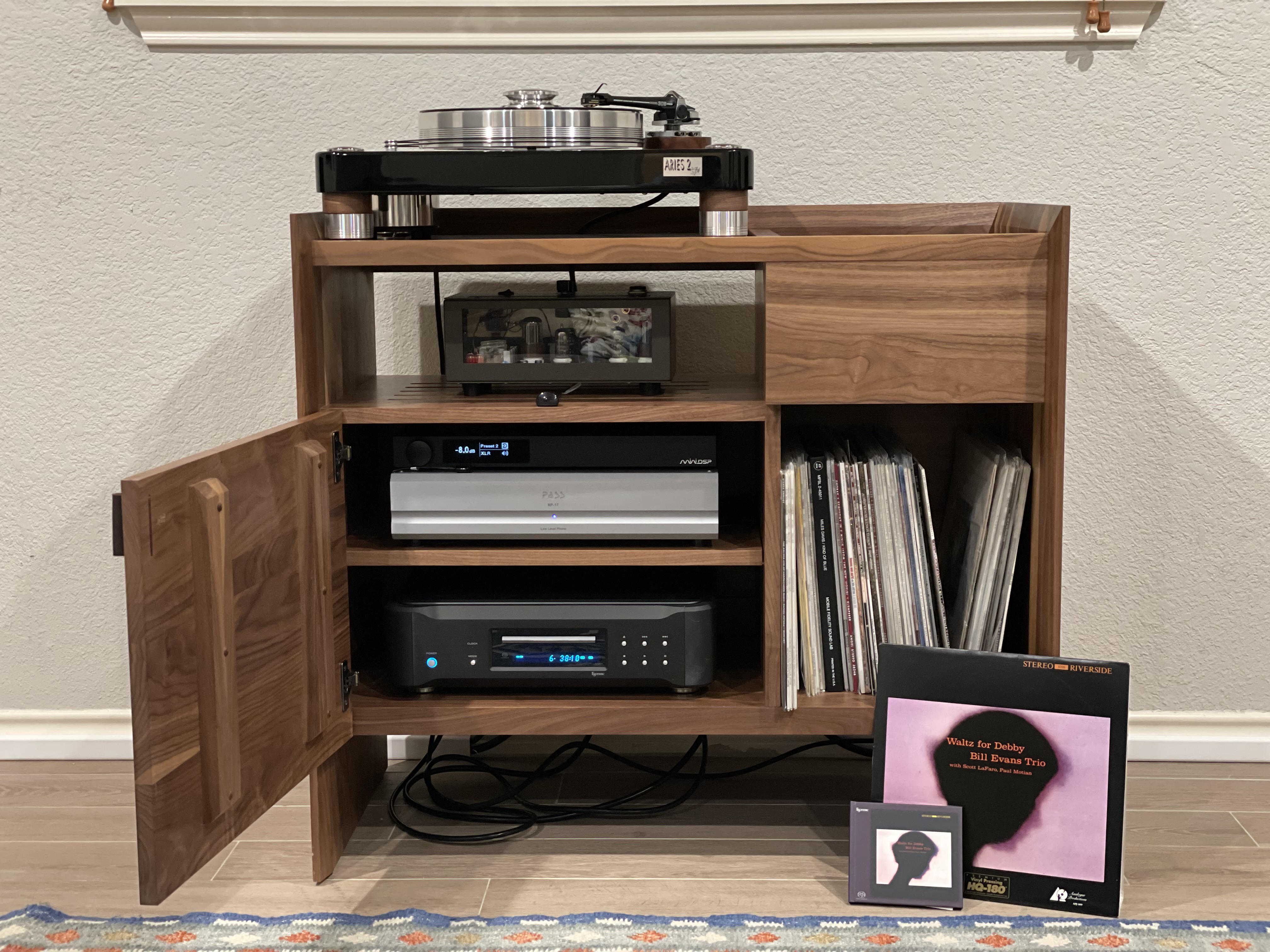

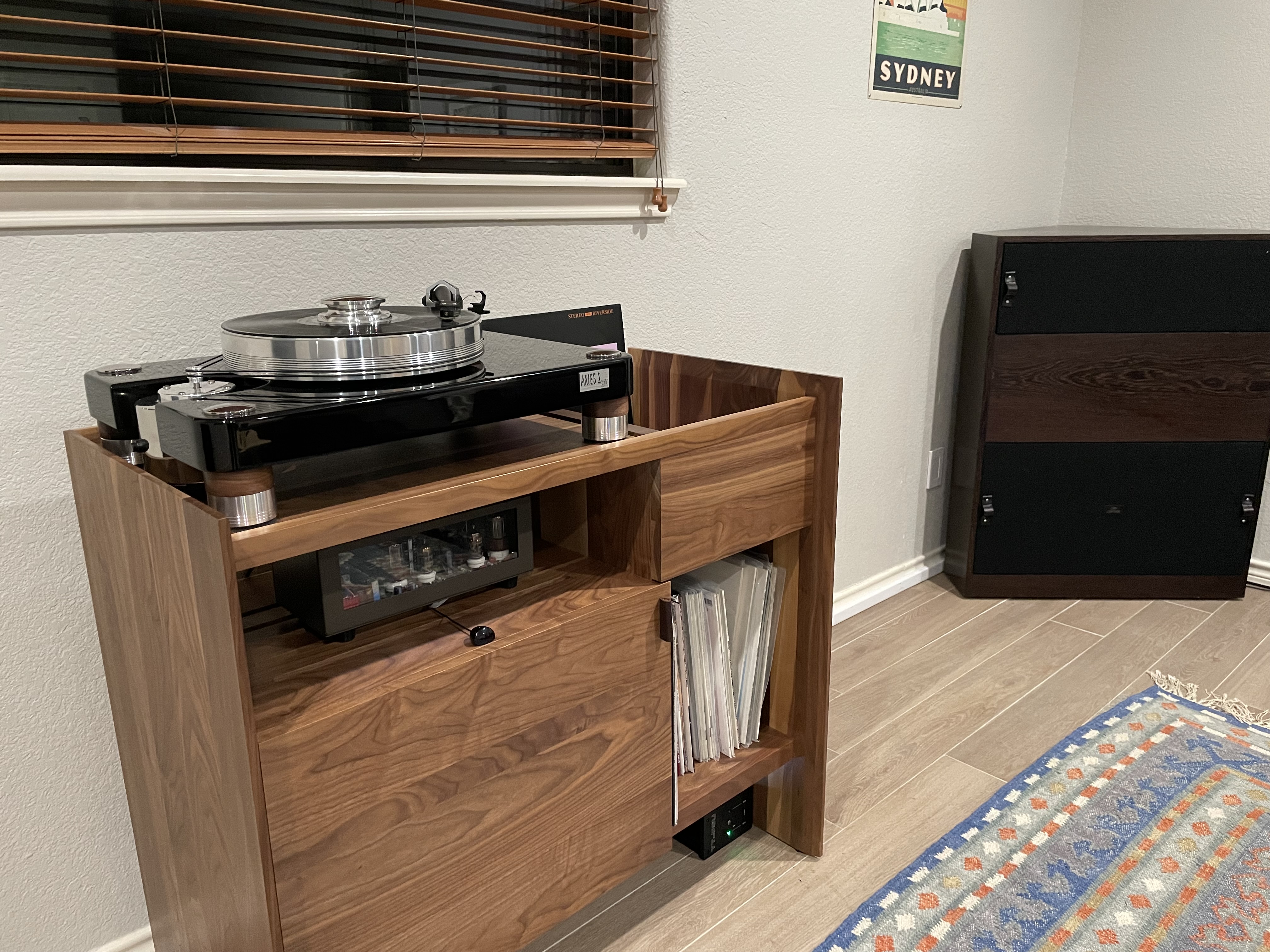

    After many, many years with BAT/Avid/SME YG Acoustics systems this is what my wife and I have spent the last year building for listening to records through. VPI HR-X w/12.7 arm, and VPI ADS power supp

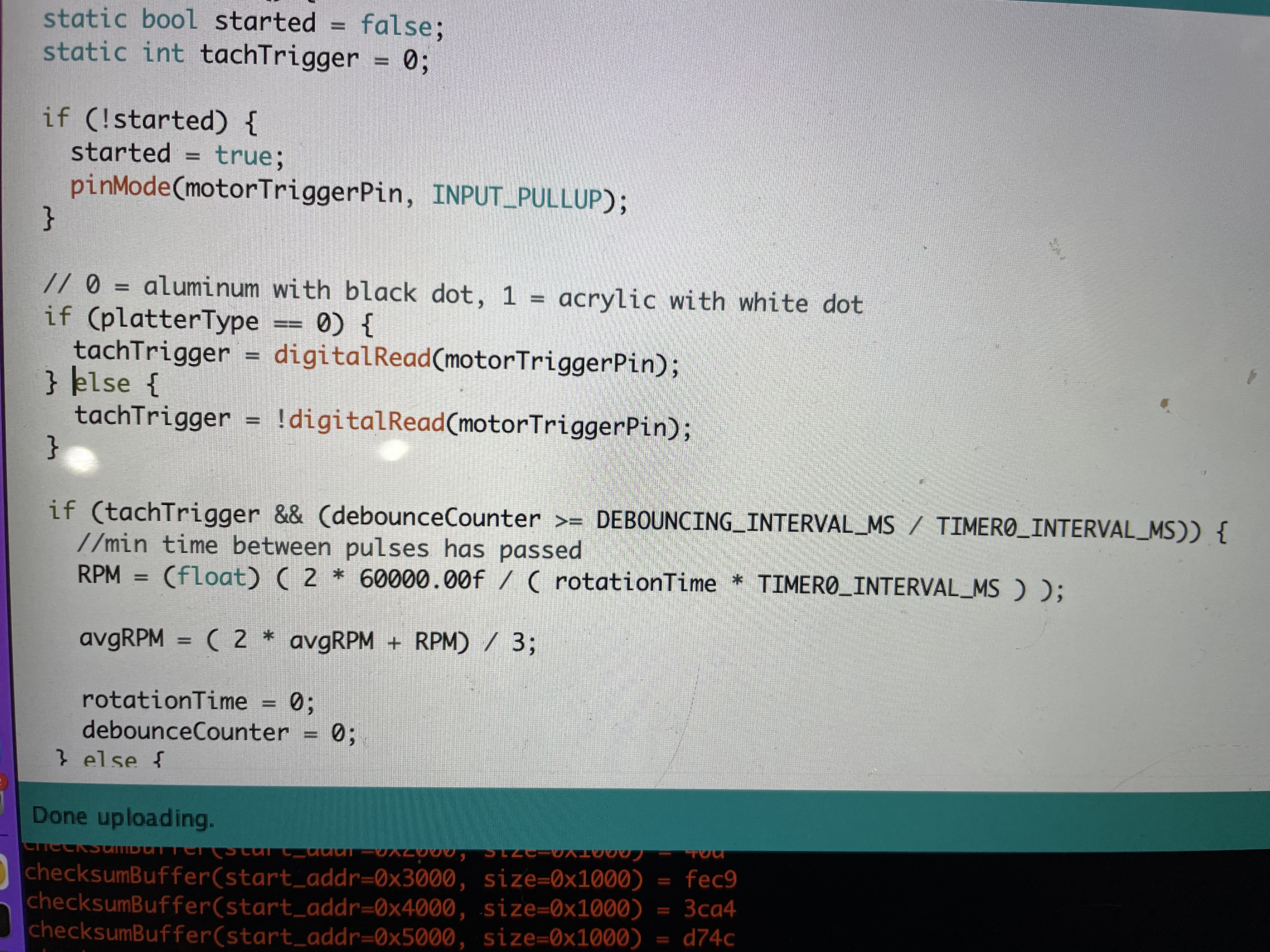

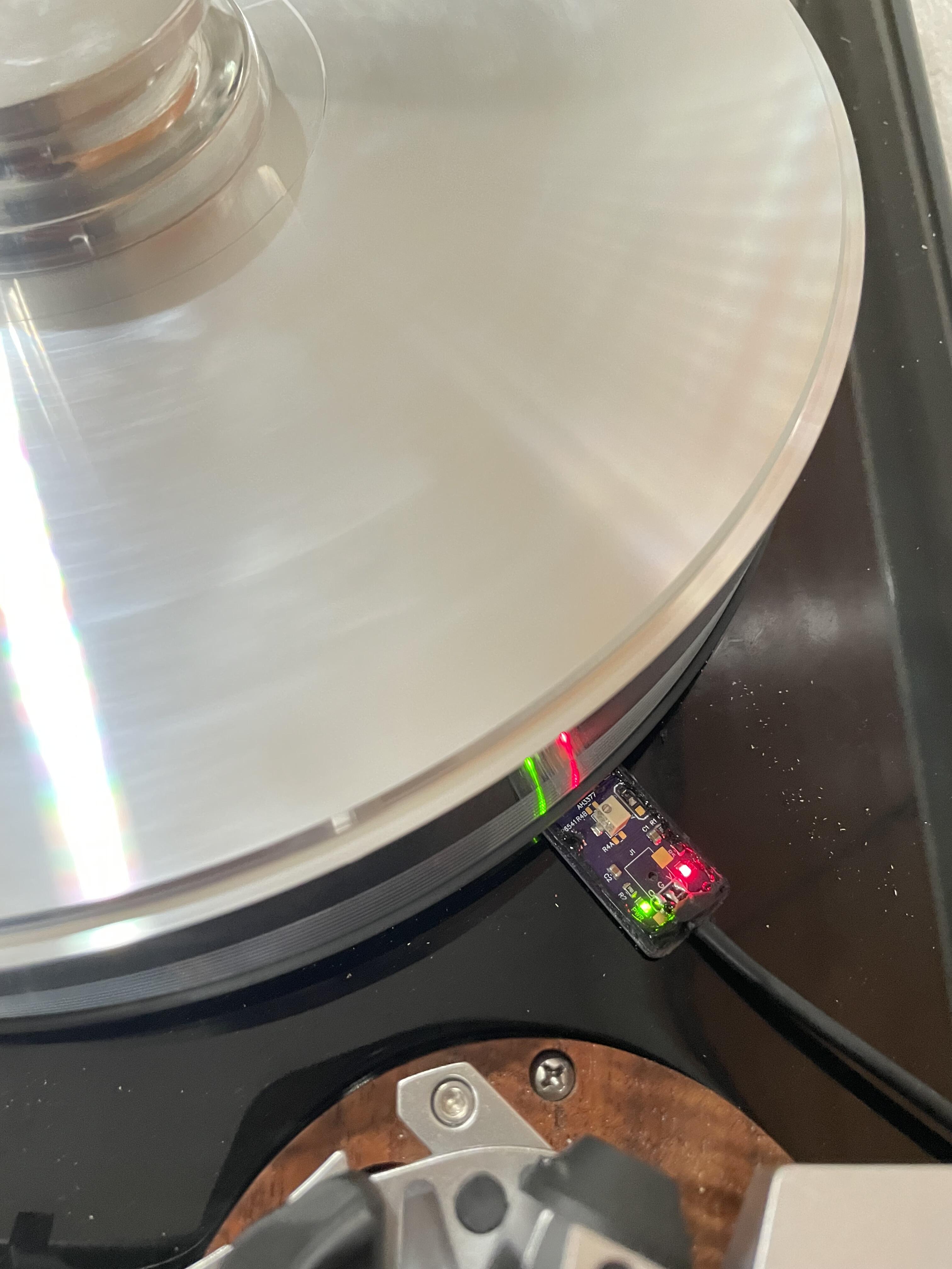

So, a bit of a stretch for this thread and I am doubting anyone will see the humor in this. But as y’all know o have been working in a tachometer feedback loop for my platter. With the lid off it looks like this:
Previously I had an acrylic platter with a white dot that triggered the IR sensor each time it went around and used that to calculate the platter speed.
Now I have an aluminum platter. To make it all work I had to add a black dot and update the code as follows.
.. anyways I found this humorous.

My little box works by counting the number of times it sees something pass as the platter spins. You need to check fast enough so you don’t miss the thing as it passes by. The faster you can check you can increase the accuracy of your measurement.
Originally I used a magnet and this worked well but seemed a bit less than ideal near a sensitive phono pickup. So I changed to using light.
In order to make the sensor work with other types of light present (such as the light that comes out of a light bulb) I used certain frequency of infrared light. This light is emitted by my box and then when that light is reflected back from the object it notes that the object has passed and it computes the speed.
With an acrylic platter with a record on top when the box asks if it has seen the reflected light, it says no until the white dot comes by, which reflects all frequencies of light and registers a “yes” with the system. But when an aluminum platter is used it always reflects the light. So I needed something that didn’t reflect the light I was using, which ends up being a black dot which absorbs light.
One made the “physical” change in how the device operated I made a simple change in the code that basically looked for when the reflected light wasn’t present - which was the exact opposite to how it used to work with the white dot.

Hence the !digitalRead call. Clever.
Yup - I guess in this case the difference was black and white.

Does that jump in speed every time the platter rotates?  Or does it quickly reach a steady state and stop altering the speed?

Yes, but more importantly, is it audible?  The software doesn't appear to smooth the data.
The avgRPM assignment does a bit of smoothing.
There are not a lot of mechanical losses, the belt has reasonable friction on the pulley and platter, so it can alter the platter speed with reasonable accuracy without it acting like a flywheel.
I don’t know how much is audible but I can say that +/- 0.03 rpm isn’t audible and it makes adjustments less than this.
Gor reference, the added friction of lowering the needle into the groove slows rotation about this amount.
Yes!  Context is very important, thank you for that.
