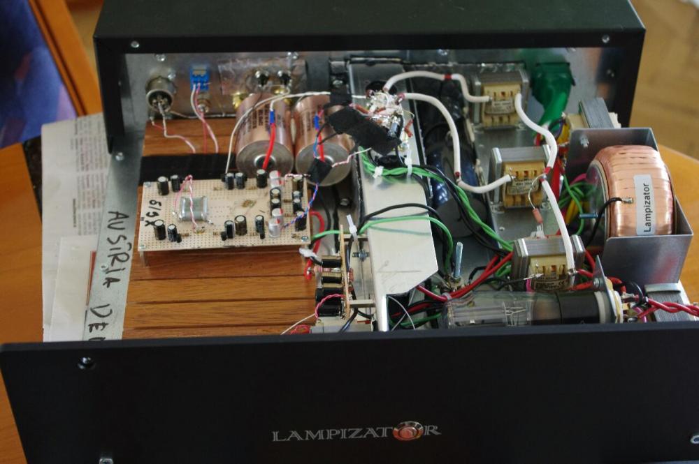

The funny thing about astrolube is utter lack of understanding of anything.  So tubes must the be the same as all other tubes, "cuz toobz be magical!!"  As it happens and I've heard two of the top end Lapazitor dacs and what utter turds.  Seriously, this stuff is so bad that you have to question the sanity of the people to claim this is high end or they just don't grasp the concept of high fidelity.  You know, the annoying bit about the end result being as close as source as is possible...
Let's not go into how Lapazitor is built or designed.  One of the Carbon owners was adamant that this was the true solution to all DAC's and even sent me some of the correspondence with the owners.  Yeah...their idea of a power supply design is to listen to two equally sucky versions and then pick the winner.  Who needs to measure noise and shit like that?

I still appreciate that he came out to say something, even if it didn't amount to much. Certainly a lot more level-headed than when cavalli stopped by to grace everyone with his presence. Maybe I've also been desensitized but I didn't even think people were being too "flame"-y about things either haha
Also Lampizator is some sort of sick joke, all it takes is a quick peek under the hood. But it's magic, has to sound good right? To this day I wonder what the wood is for

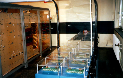

Back in the day, we got involved in building high field resistive magnets. The idea was that you would discharge a very large number of capacitors through a thyristor bank into a magnet. This was shrink fit into a thick stainless steel tyre to stop it from exploding as a result of hoop stress. Now that was a beast you did not want to share a room with; testing them was a bit of a game so as not to incinerate the test engineer:nate:
600V? Chicken feed.
Here's a shot in a concrete bunker that this kit was installed. The blue things heading off into the distance were the capacitors.

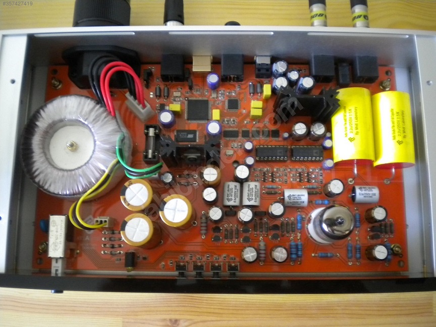

3rd: I feel guilty/ashamed now for I own a dac with tube (2c51 variants) buffer; MHDT Lab Atlantis. IMHO, It sounds good to my ears but. If you want to see inside of it:
It uses one Ad1862 per channel as i know, Dr. Gilmore. It sounds pretty analog, but tad bit forward sounding. I paid 860 Dollars for it, including shipping. I bought it cuz of curiosity, as always. It turned out good sounding one.

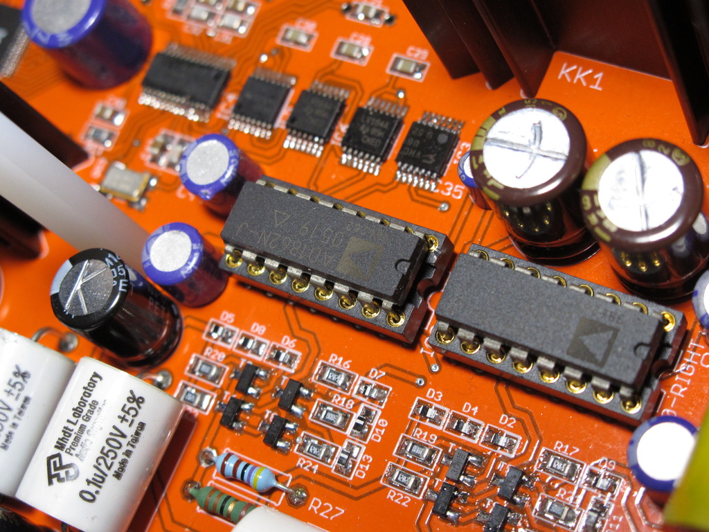

Here is a closer look to the dac chips:

the big yellow caps are the output caps, the 2 analog devices chips are likely the dac chips (can't read the numbers) then discrete solid state buffer then tube output stage with what seems to be a current source for the plate. 2c51 a better choice than most tubes. only one resistor mod in the lower right corner. depending on how much it costs, possibly a decent deal.
