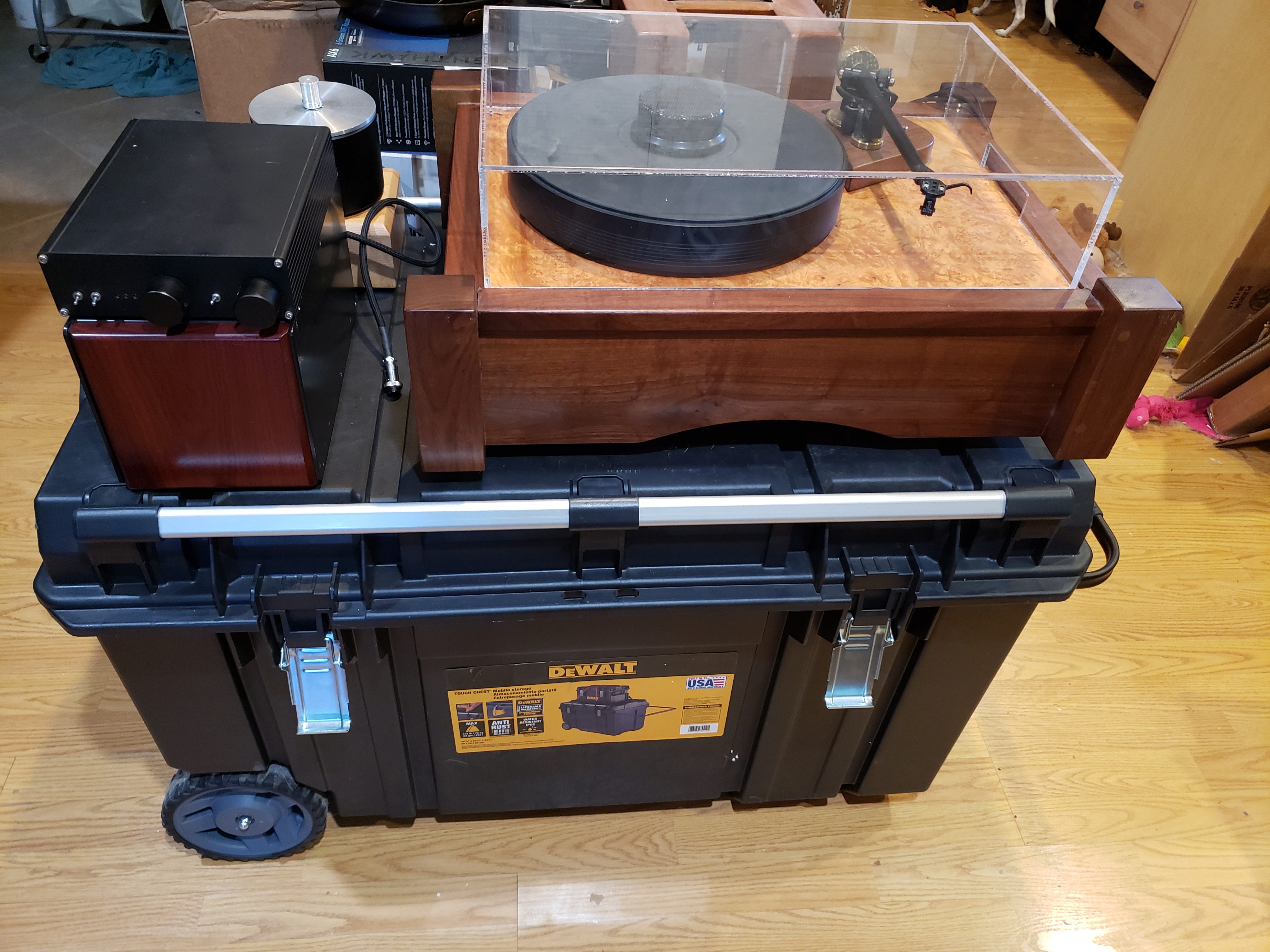

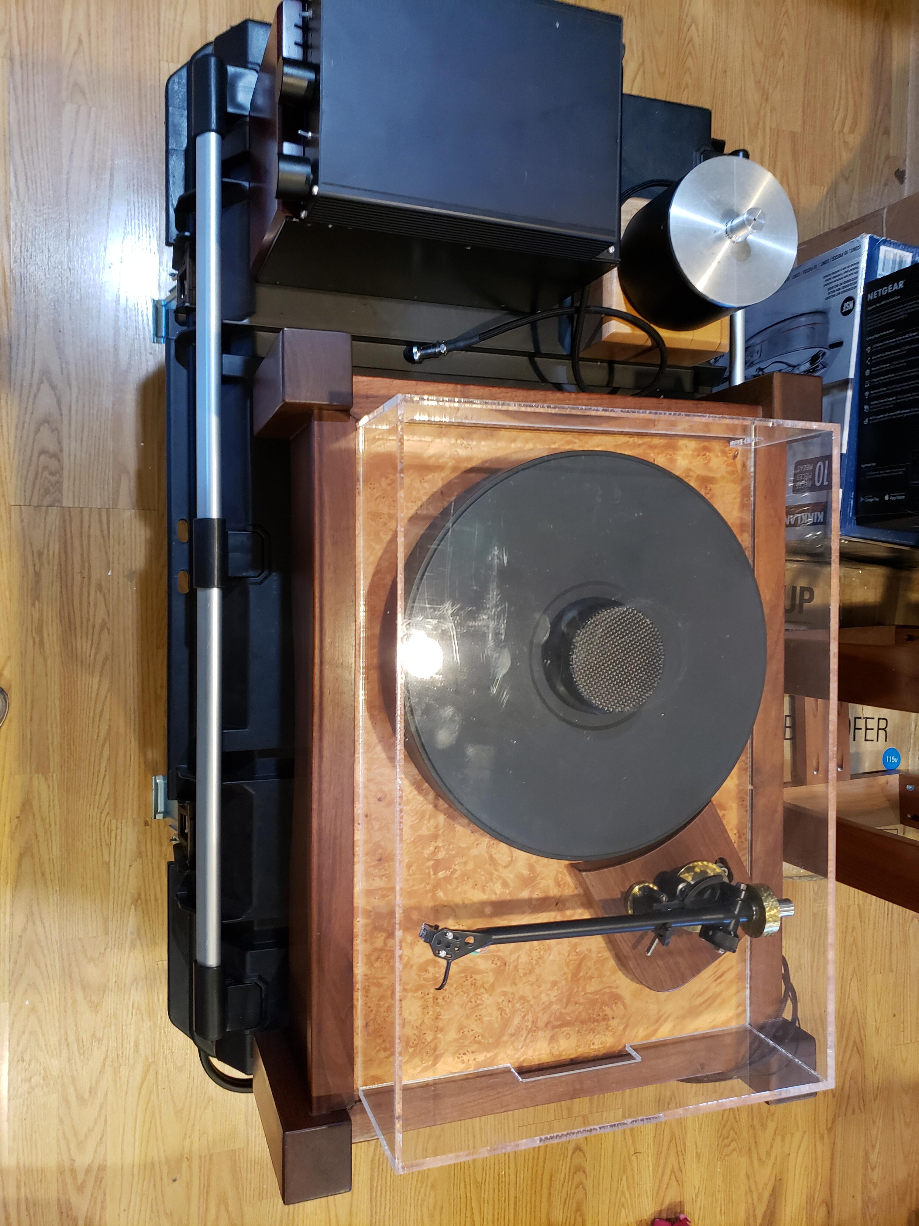

IT'S BACK!
I remember it being big, but I forgot how massive it is. In no way is it going to fit on the TT stand I just built. I've also forgotten the layout of the controls on the speed controller, and which is input and output on the DIY Pass Pearl phono stage. Lots of fiddling to do before I'm near ready to fire up the beast, but it feels good to have her home again. It was 12 years ago that I built her. I need to see if I can get the Zu Audio DL 103 aluminum bodied cartridge repaired. I had broken the cantilever some years back. I also need to source a rubber belt for the motor/platter. Damn this thing is big!

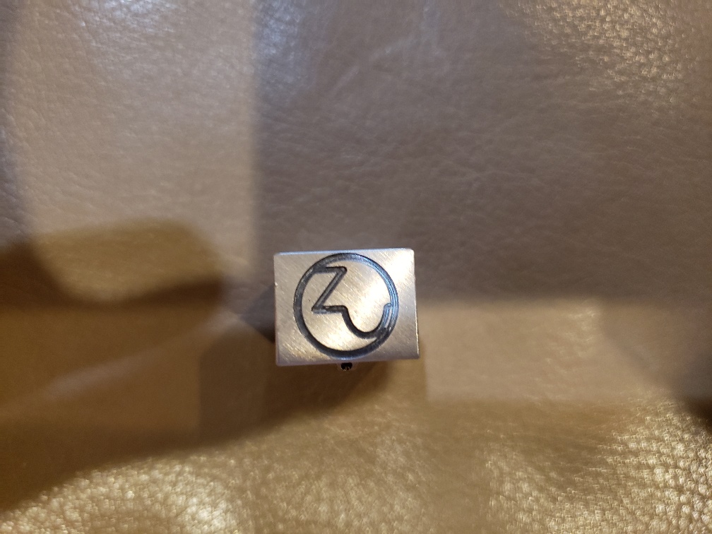

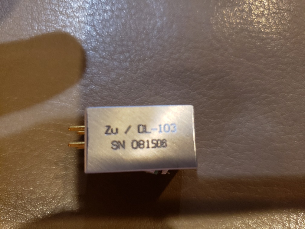

Making some progress. A belt should arrive today. Hoping it will fit, but not completely sure until it shows up.
The speed controller was DC. It ran off of a motorcycle battery. Noise free, but not the most convenient, so a simple DC to AC wall wart later and problem solved. My TICE Audio Solo power conditioner should keep things clean enough (no relation). The input and output of the Pass Pearl have been figured out. This is a top notch phono stage. And the ZuAudio rebodied Denon DL-103 is out for repair. The cantilever was broken off just past the pivot. I honestly don't remember how that happened. But it's getting an upgraded, tapered cantilever and a new square shank, high polish, diamond true ellipsoid needle to replace the missing, stock round needle. Should be a nice sonic improvement.
Now I just need to concentrate on a new, larger stand. it needs to be 20" x 36" to house the turntable and the motor pod. I'd like the top to be thick butcherblock and the base of the stand to be a separate unit. I'll then use the Big Feet isolator feet in between. I'd like a low shelf for record storage and an 8' shelf on top of that to house the phono stage, speed controller and record cleaning gear.

Very cool! That is like a blast from the past!
I use the later (current version) black bodied Zu Denon DL103, and can confirm its excellence.
Repeated sentence, sentence repeated.....
I saw that they have a new model. I also like their Rega counterweight, but already have the Pete Riggle counterweight and VTA set.

Did you build it entirely from scratch? What did you use for the main bearing? Building a turntable has been on the long list of projects for a few years now.
Just A+, bang-up job on the design. Loving the combo of woods and overall aesthetic.
Not entirely from scratch. I had a thread dedicated to the build, but it got nuked by  Reks.
I purchased a VPI Aries special edition Black acrylic platter, about 2" thick, along with the accompanying inverted platter bearing. Then purchased a Rega RB300 tonearm with upgraded Cardas wiring. Then outfitted that tonearm with Pete Riggle's counter weight and VTA mechanism.
The plinth I built was rather complex, with 6 alternating layers of 3/4" birch plywood and 3/4" MDF. I drilled a series of 10 holes about 1 1/2" in diameter and 3" deep, on the bottom of the plinth. Those I filled with the modern version of lead shot, for even more anti resonate properties, and made removable caps, so that I could adjust fill levels accordingly.  I wrapped the plinth core with 3/4" Walnut, Walnut corner posts and Big leaf Maple burl veneer on top. I made the tonearm board out of Walnut, and made it adjustable by about 1/2". Marc built me a Pass Pearl phono stage and also a DIY motor controller,  for the separate motor pod and Maxon motor.
The turntable weighs in at around 75 lbs. And it's enormous! Hence the name Colossus.
