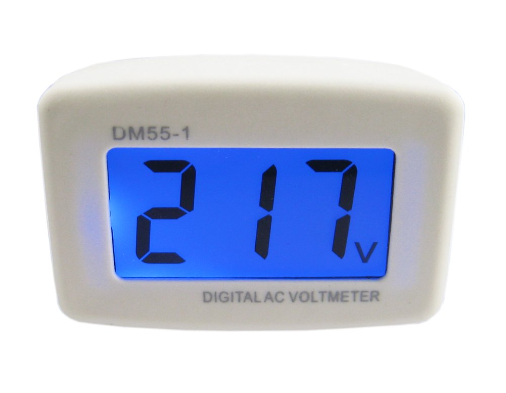

Laowei Posted July 30, 2017 Report Posted July 30, 2017 Well, that happened quickly. The Eitr took a Schiit on me. Got it a week ago, and kept it powered on while passing a signal to my Yggy. Occasionally there would be a dropout when the refrigerator or other appliances were powered, even though those were on separate electrical circuits. Puzzling, but WTF it was not happening too often. Got up this morning, and my Yggy was clanking the input relays about every 20 seconds. The Eitr was constantly dropping out, and sometimes resenting 48Khz data, sometimes 44.1Khz as indicated by Yggy LEDs. Troubleshot by powering down all, and individually, rebooting, replacing USB and coax cable, and selecting different USB ports on my Mac mini. Then reinserted my Airport Express as the Toslink source to my Yggy, and its runs without a hiccup. When working, the Eitr/Schiit USB circuit is very good. Got an email into Schiit. Would like to return the Eitr for a refund and will later buy the Gen 5 to self install.
dsavitsk Posted July 31, 2017 Report Posted July 31, 2017 Sounds like they are expecting your power to be 120V, and that it runs lower. Even a surge on a different circuit could lower house power overall. Our power runs at 123V in the winter, and around 110V in the summer (108 when the dryer is on). Pick up one of these to watch it over time. 3
spritzer Posted July 31, 2017 Report Posted July 31, 2017 That is the likely culprit, same as with the Cavalli stuff. No headroom in the PSU's. 1
swt61 Posted July 31, 2017 Report Posted July 31, 2017 11 minutes ago, spritzer said: No headroom in the PSU's. This has also been the reason for the demise of many gay bars. 3
Laowei Posted July 31, 2017 Report Posted July 31, 2017 59 minutes ago, dsavitsk said: Sounds like they are expecting your power to be 120V, and that it runs lower. Even a surge on a different circuit could lower house power overall. Our power runs at 123V in the winter, and around 110V in the summer (108 when the dryer is on). Pick up one of these to watch it over time. Good tip! Thanks. It's been hot here lately. So a heavy draw on the grid. Forecast for 110F Thursday. I'll monitor for a while with a Fluke.
