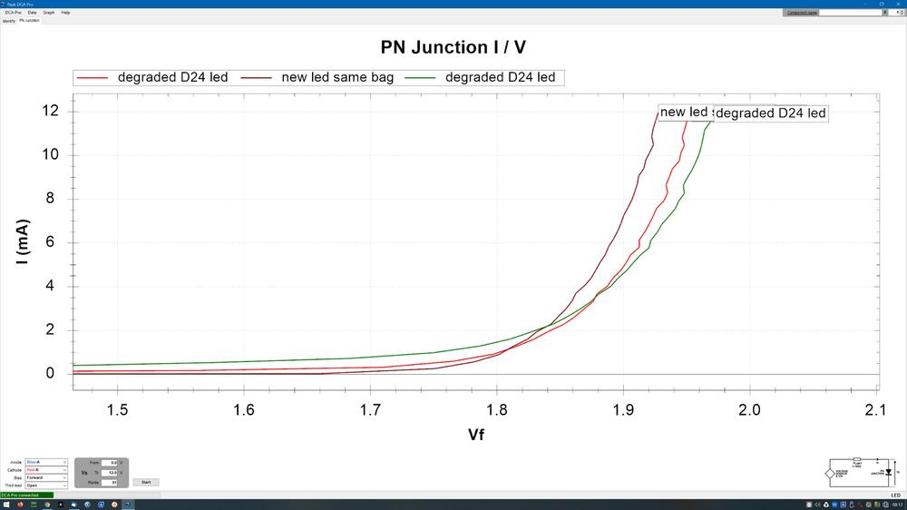

  13. I think it might well be thermal. About a month ago I replaced the groove tube el34s with modern production branded mullards and the bases of these run far hotter than the groove tubes so that could also have contributed more heat conduction to the leds... I did match all 6 leds in the amp by curve tracing on a peak dca75. The other 4 leds still work well and have very similar voltage drops meanwhile both the D24 leds (which are positioned close to the El34s) degraded. I did not raise any of the leds off the pcb and I think there was excessive heat conduction from the pcb into the underside of the led. This time i'm using leds from the same batch but have raised them off the pcb and time well tell if they degrade. I carefully de-soldered the degraded leds and curve traced them. As expected their characteristics had considerably changed compared to the rest of the leds in the bag. The D24 led on the left channel which is closest to the EL34 had the most change from new and the lowest voltage drop in circuit 1.4V in circuit, the righthand channel D24 is a little further from the EL34 and in circuit had 1.5V drop and is a little closer to a new led which has a drop of about 1.7V in circuit. To put the change into context I measured multiple leds from the bag and the curves almost superimposed over each other. So the drift in the D24 leds is significant.
  14. The components will age, LEDs in particular, and accelerated under elevated temperatures. I would check the LED’s I/V curve on the curve tracer before popping it on a circuit. They could differ quite a bit in characteristics even if looked similar on the outside. If a circuit only designed less than 1ma for the LED, that’s likely starving it. I’d make sure the operating current is sufficiently past the “knee” area of the curve.
